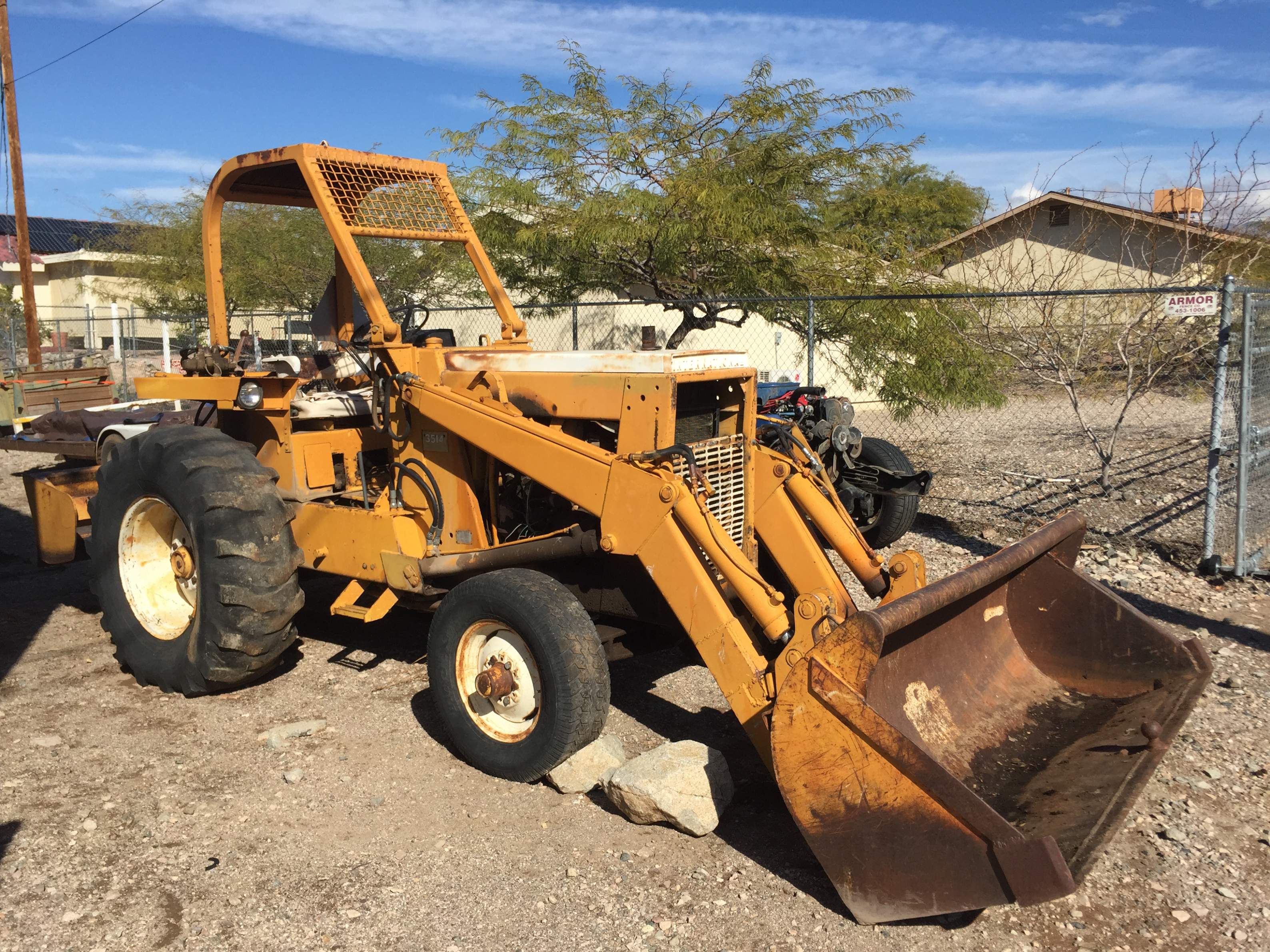

I had previously asked for a little help here on pricing a tractor.
And while I did not get that particular tractor, I bought another one that was, I think, more within my budget. I say I think, because it doesn't run, and is pretty beat up. We will see if I can bring it back to life.
I figured I would post this up, because I am sure I am going to have lots of questions and need tons of help, as this is my first tractor.
It is an International 3514. I don't know if I am posting this in the right section, as I did not see a sub forum for International tractors. If it needs to go elsewhere, please advise.
Here she is! What a beauty, right?

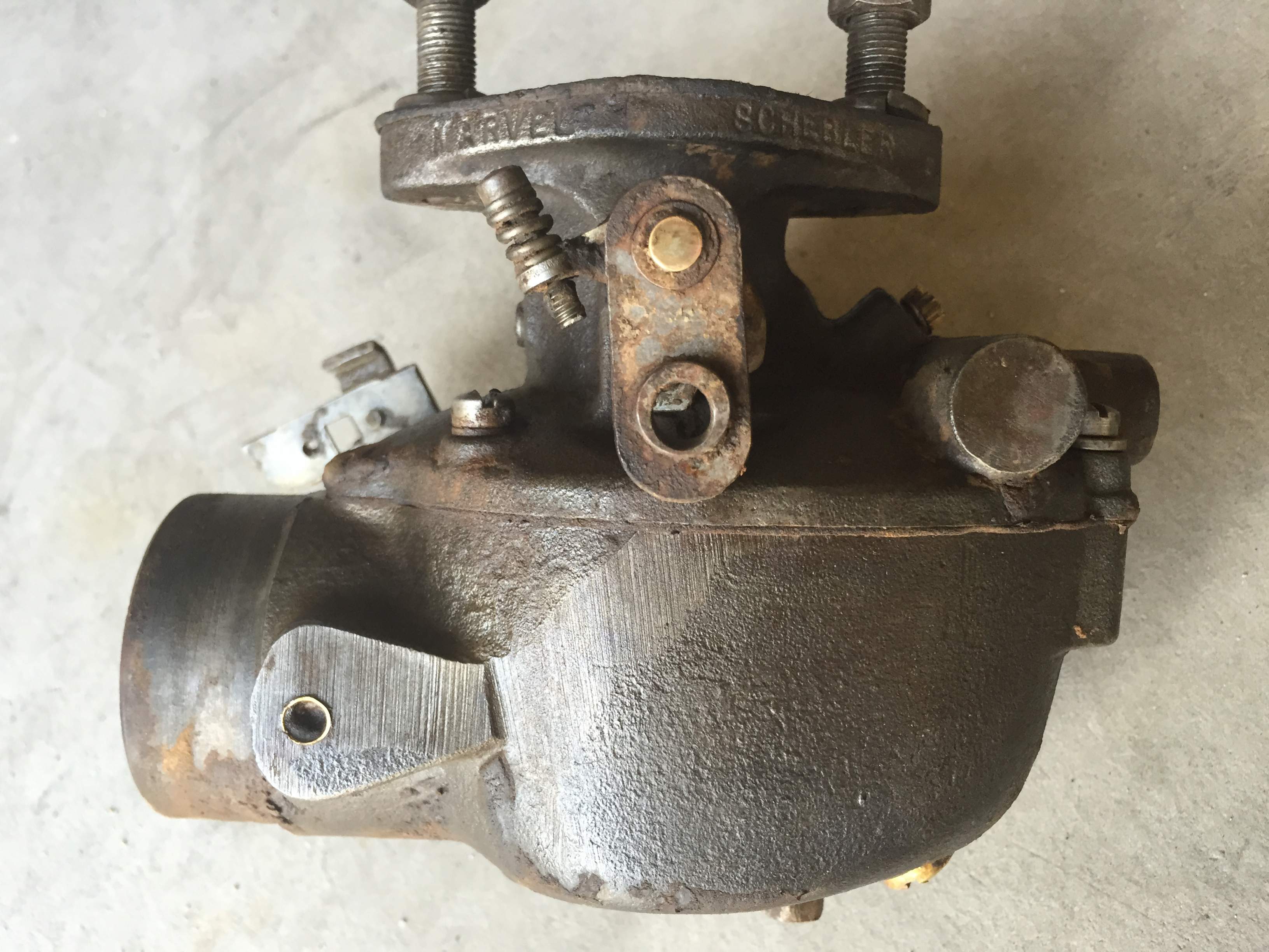

Anyway, my first problem is that it does not run, the previous owner said there was something wrong with the carb, so I started there. Boy, they weren't kidding. Aside from being full of crud and needing a total rebuild, the throttle shaft is so worn it moves all over in the shaft bore. The shaft is brass, the carb is cast iron. I ordered a rebuild kit from Steiners, but they dont have a bushing kit for that carb. I was thinking of trying to make a new shaft out of stainless, then boring the carb body out and pressing in bronze sleeves and reaming to fit. Anybody have any experience with something like this? any thoughts!

I don't have any answers for you, but look forward to seeing your progress..... good luck and thanks for the pictures.

I have rebuilt many carbs that were way beyond their useable lifespan. Mostly they were done for collectors that couldn't find the correct replacement but wanted original or some time period upgrade or modification. With something that is to be used I have found it much quicker to Find a carb with useable fuel delivery or something that is easy to tune to a multitude of engines and simply build an adapter plate to make it fit. Most carbs are tune-able if you understand them but most aftermarket carbs from Webber and Delloto are built to be adapted to anything.

What model number is the Marvel S. carb...it might be better to look for a complete used one....BobG in VA
/ I got a Tractor! #8
Try a local carb repair shop. I've used them to rebuild fuel injectors for 1/10th the cost of new ones. I'm sure this can work for you.

Steiner actually sells a replacement rebuilt carb for about 200 bucks. But I am trying to get this running for as cheap as possible so that I can see what other issues the tractor has-and I suspect they are plenty! This poor thing is hammered. Pretty much every pin hole is worn out, numerous leaks, old hoses, was run without an air cleaner for at least a little while (DOH!)

So, with all that in mind, I think I will just try to machine my own shaft and bushings. The material wont cost much, and I have a mill and lathe, and I don't think I can hurt it any worse than it already is!

Congrats! this baby looks heavy duty!!
I am sure way more talented and experienced wrenchers on this site will give you better advice than me. but I appreciate your sand in purchasing this beast and, like others, look forward to you revealing the mystery as she takes form.
Best of Luck in the project and please keep us in the loop!

Having your own Mill and Lathe will make the bushing replacement easy, most don't have that luxury! If you just want to set it running without any real time or money invested use some leather to tighten up the shaft. It will work good enough for a test run and then you will know if its worth the time to do a real rebuild or to buy a rebuilt carb.
/ I got a Tractor! #19
An old trick for quadrajet rebuilders was to use the throats from 30-06 brass as bushings for throttle plates. Just something to think about.
