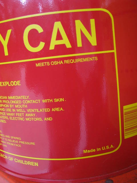

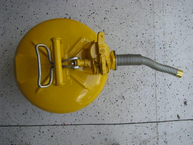

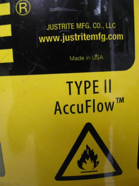

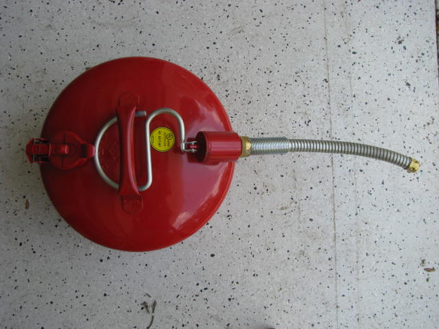

Eagle and Justrite "lifetime" metal cans are readily available, most cheaply on amazon.com...... free shipping no sales tax.
While the purchase price is twice higher than plastic cans, these are "lifetime" quality and you do not have to fool around to achieve no spill, no drip, rapid flow.
Available red, yellow, green, blue.
Be sure to specify widest diameter spout.....various diameters are available.
I have a slight preference for the Justrite design but both Justrite and Eagle are excellent.
