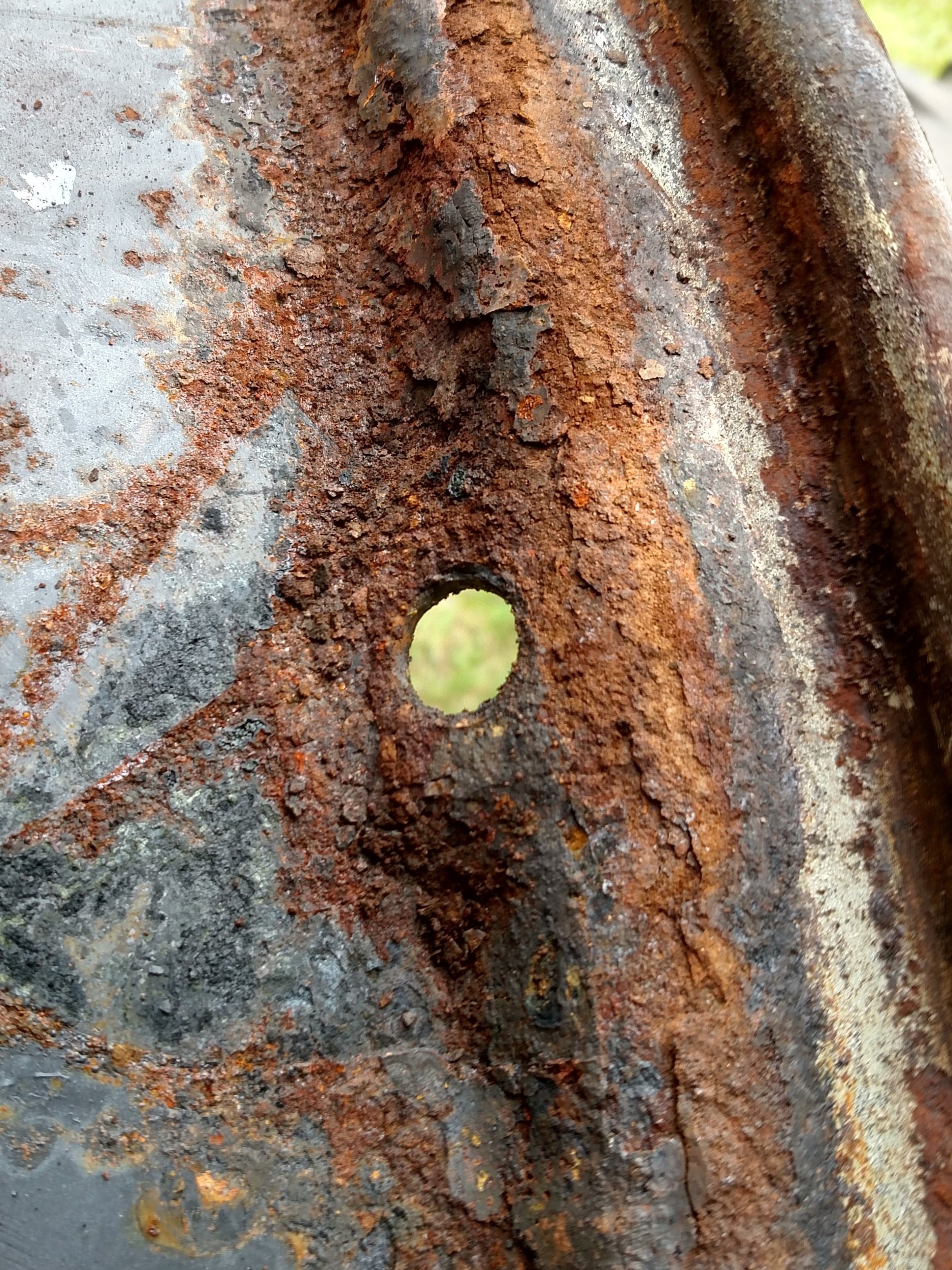

Hit it with a needle scaler and evaluate. If okay give it a dose of phosphoric acid and clean up. Final coat of rust preventative paint spray.
   / I have a bad feeling about this #102
Oh no, that rim is terrible, and it's not even 20 years old...

Your picture does indeed look very bad. However, steel can expand up to 7 times when rusted. This means your wheel could be fine and only needs rust removal, treatment, and painting. So I would recommend using a powered wire brush to remove all the rust down to bare steel and then evaluate the condition of the wheel.
Eric
Here's what the worst (from the outside ) of both wheels look like.
Not knowing how bad the shape was, I was worried about a catastrophic failure/explosion so I used my thick welding gloves and protective glasses as well as grinded from the side of the wheels, just in case.
For now, being below freezing, I've applied Fluid Film over the brushed off part. Probably useless at this point though
Needle scaler? I do have a bottle of Ospho that I might try next spring if it's worth it.
Iy looks to me like your rims are fine. If these were my rims I wouldn't replace them. Make sure you remove ALL the rust, treat with a rust converter, which will contain phosphoric acid, and then paint.

Thanks. I'll check again next spring and if no changes, I'll grind the paint away, threat with Ospho and repaint.
   / I have a bad feeling about this #107
The rims don't look fine to me if that's a crack I'm looking at.. If you're seeing this on the outside, what must the internal parts of the rims look like?
CC traditionally is pumped into tubes. Some part of the tube let go and the stuff cascaded onto your rims.
I had cc in my tractor for 28 yrs. A valve stem allowed the stuff to seep into the inside of one of the rims. I tigged this dime size hole shut after I completely smoothed out by sanding, filling and then sanding again so the new tubes would not get abraded. I then painted inside the rims with bridge paint.
While I'm not gonna say all corrosion on rims means a throwaway, there is no viable short cut to corroded rims to get them able again to accept a new tube with fluid inserted.
