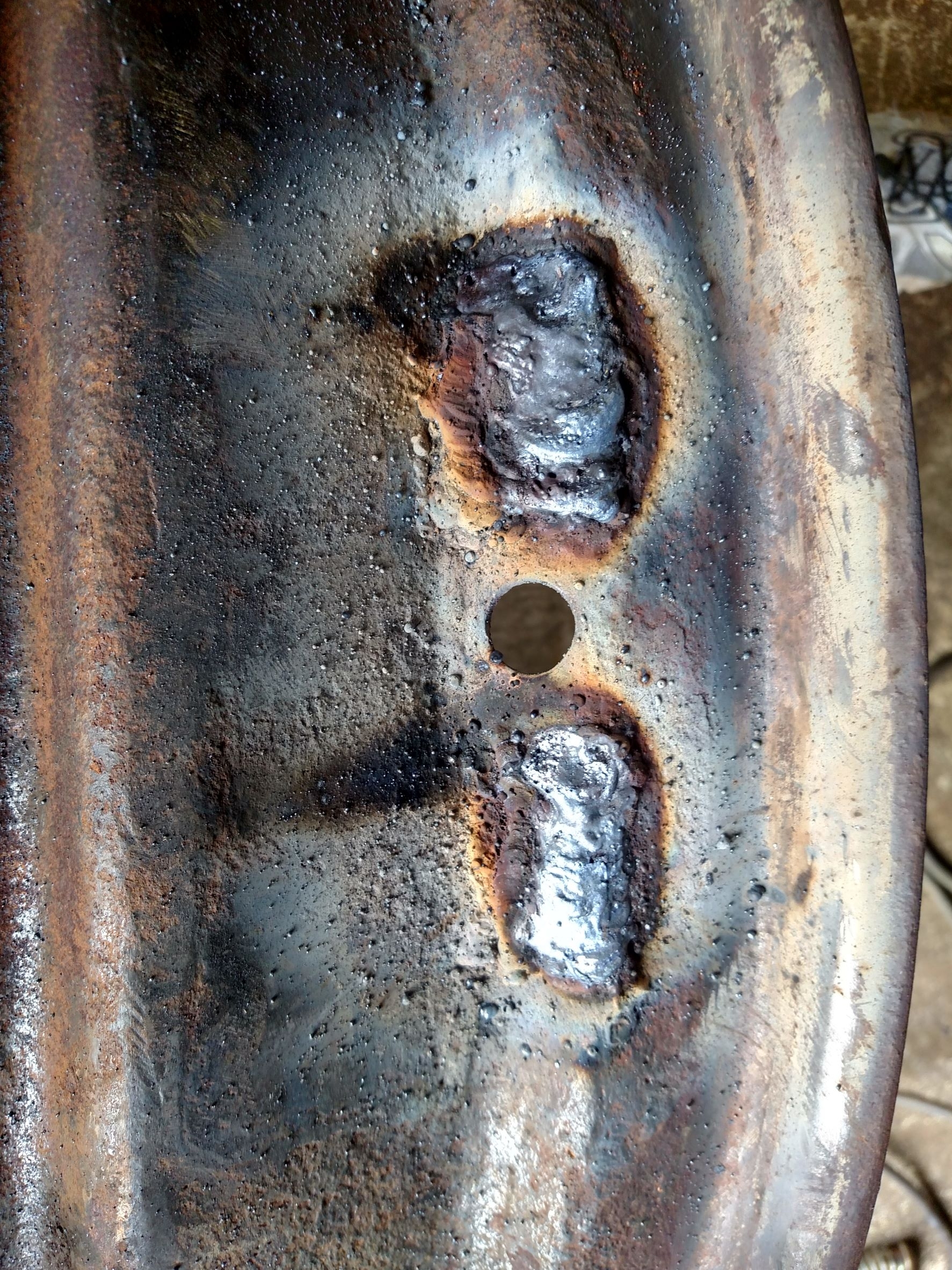

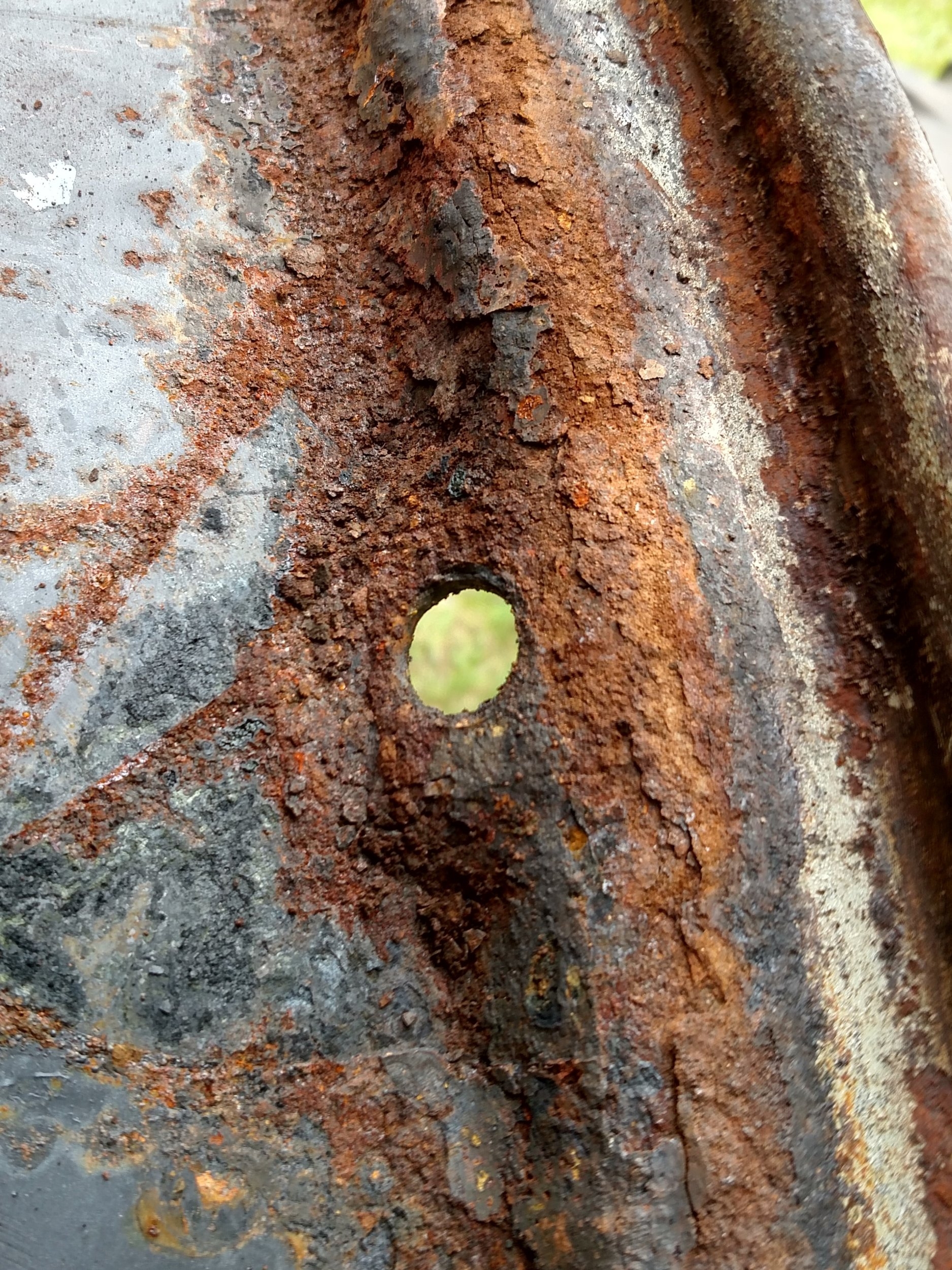

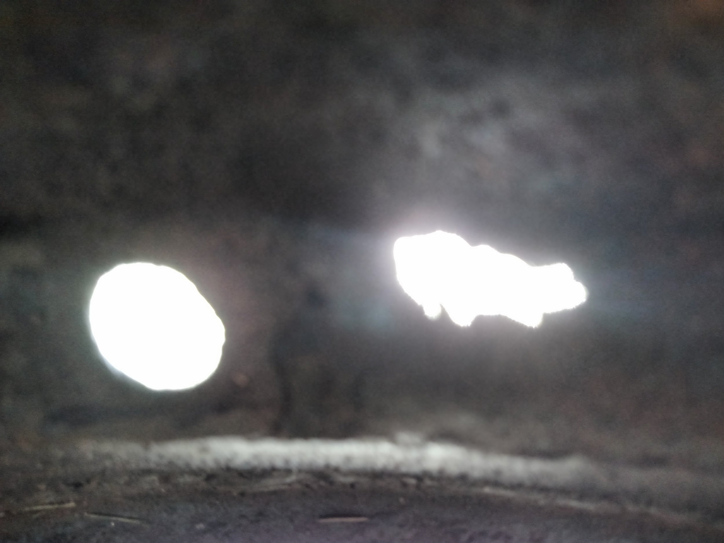

This rim had damages that required repair at the valve stem hole and on both sides of it.
I didn't think to take a picture as I was repairing the valve stem hole, I had welded in a washer and ground it to the proper shape before the repairs next to it.

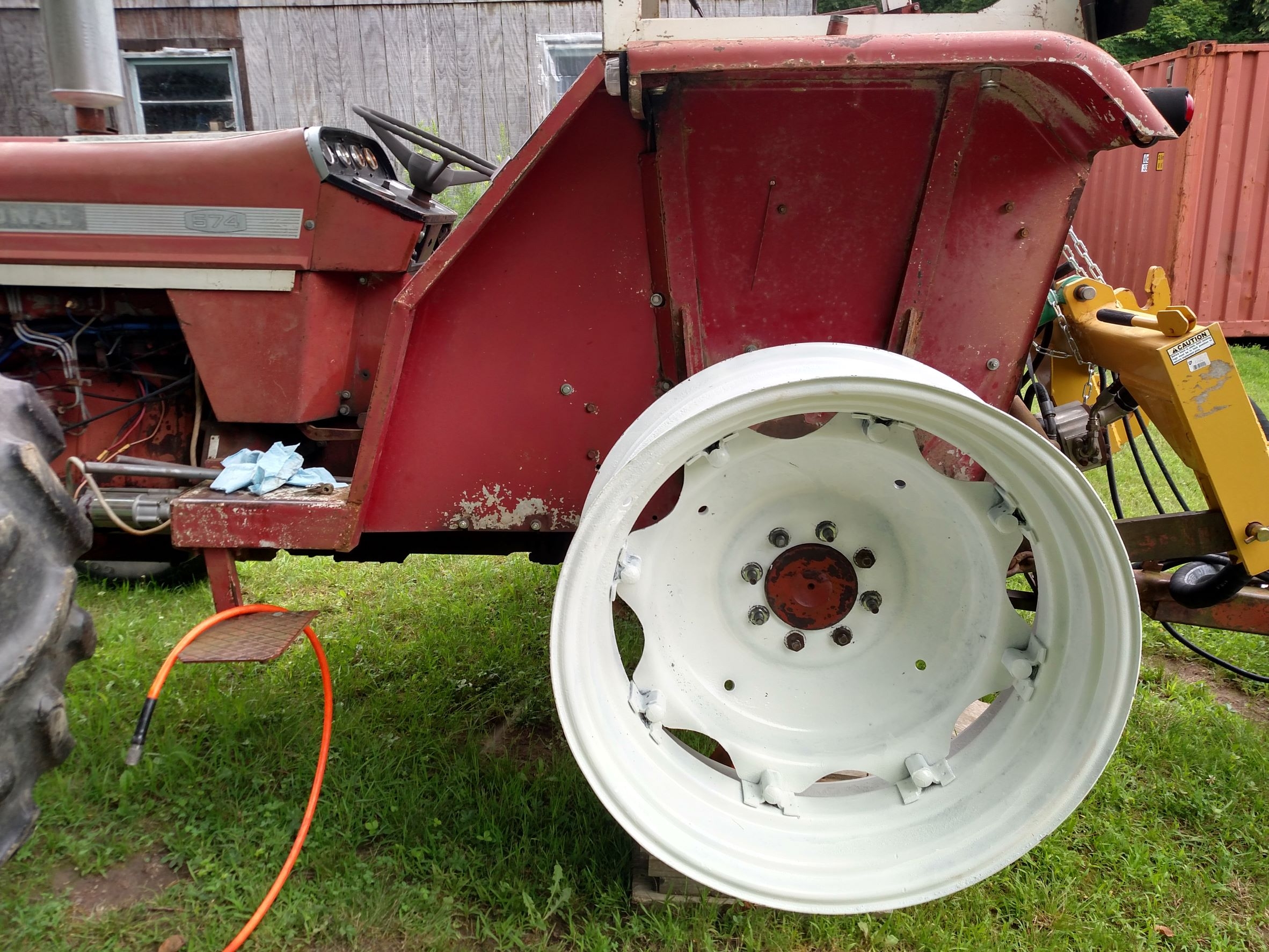

The finished project
This was the starting point, the damage was around the valve stem hole and on both sides of it.
It was better then a week long part time project .

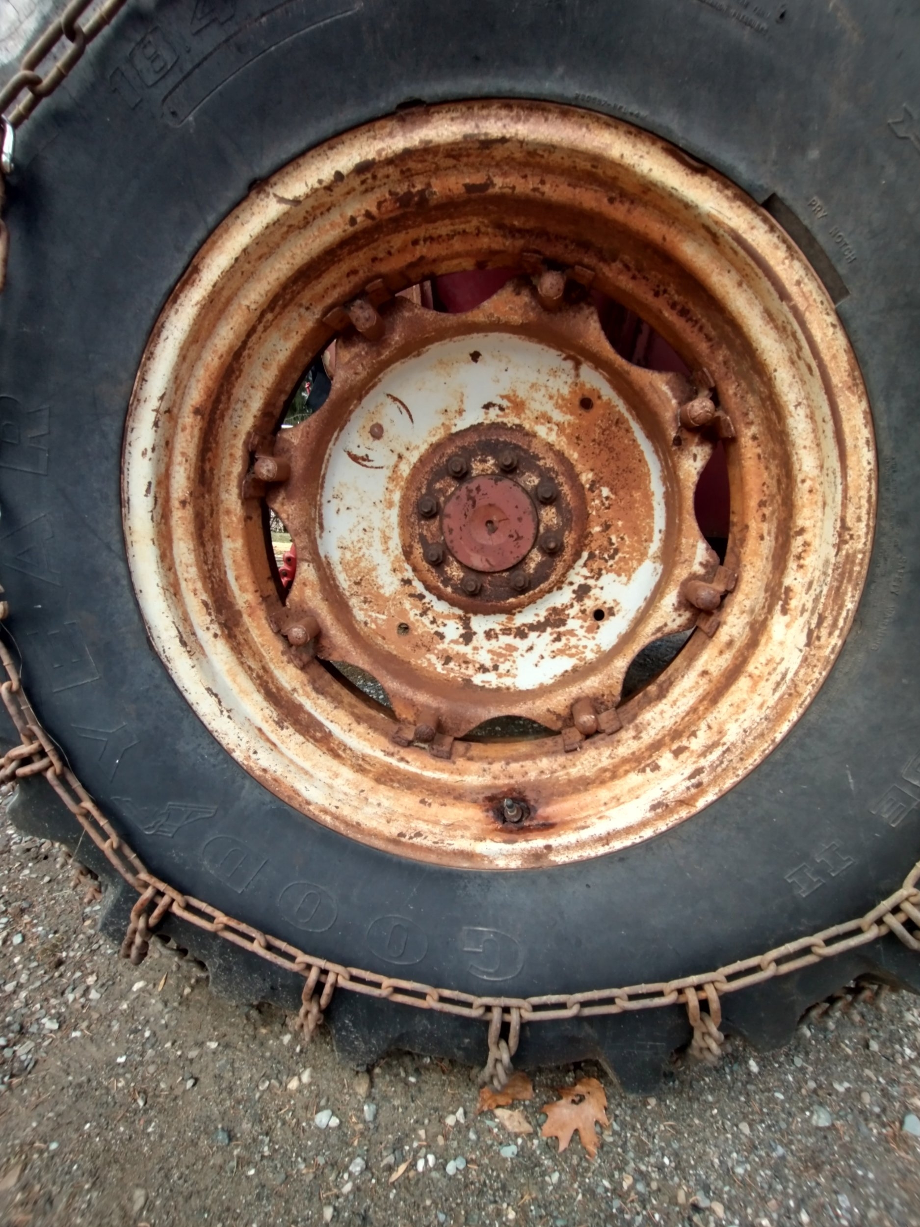

Thanks, this does look way worse than mine. I'll know more next spring when I have the tires unmounted. I'll look for good deals on used rims in the meantime.
