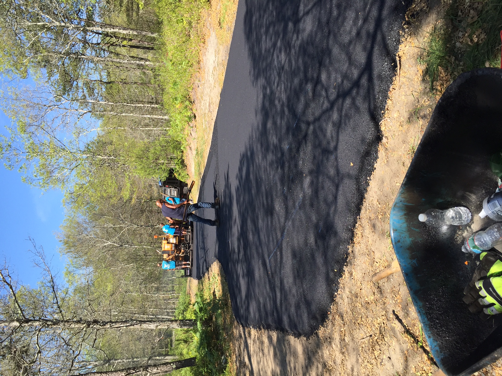

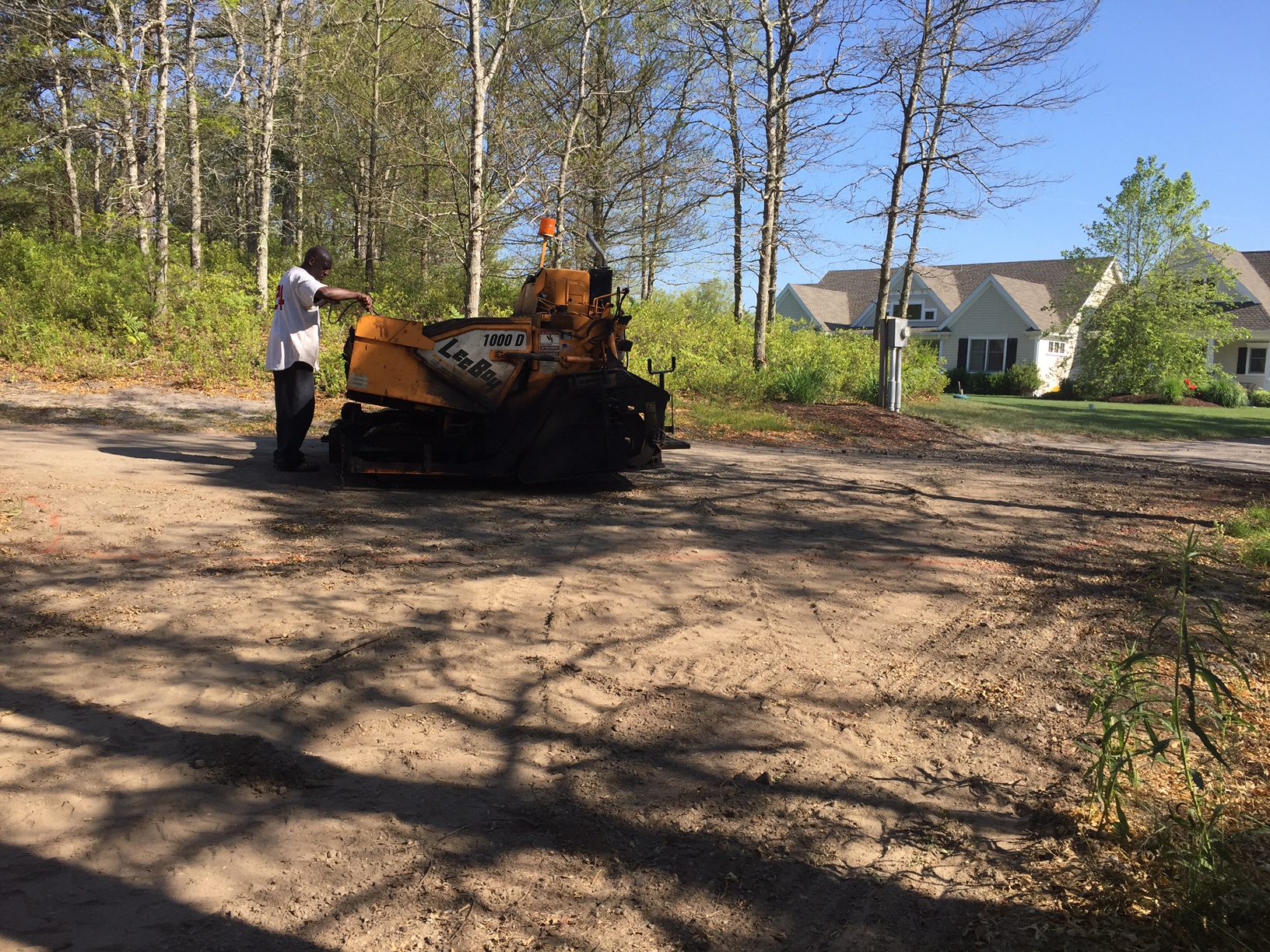

So I have decided paving my 1000 feet of driveway is going to happen this summer. I'm done with the dust and dirt. I have a very well compacted base, maybe need 1 more load of processed asphalt spread through out the length. I plan to do it in stages. First being a 2" binder course this year, then top it next year. .. What would you expect to spend on a 10ft X 1000 driveway base coat in your areas.

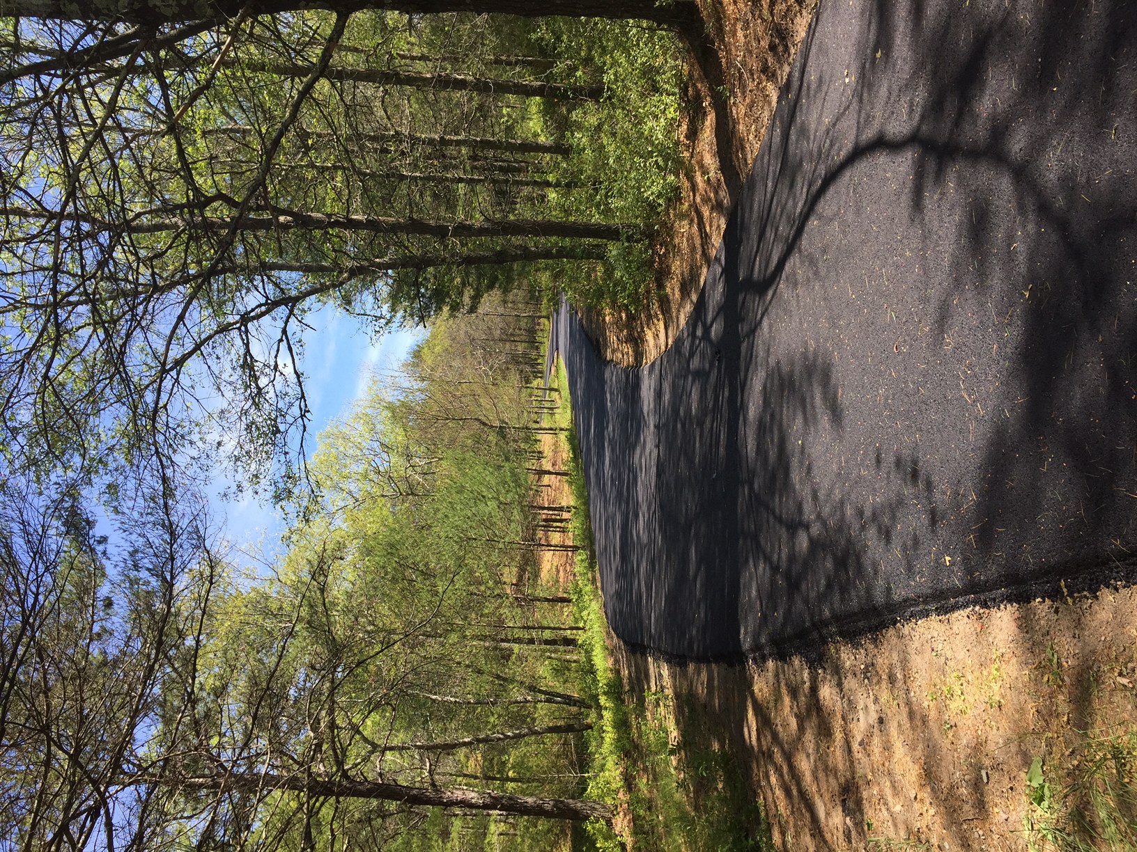

Today was the day. It was a long hot humid day here but I'm done with the dust. !
