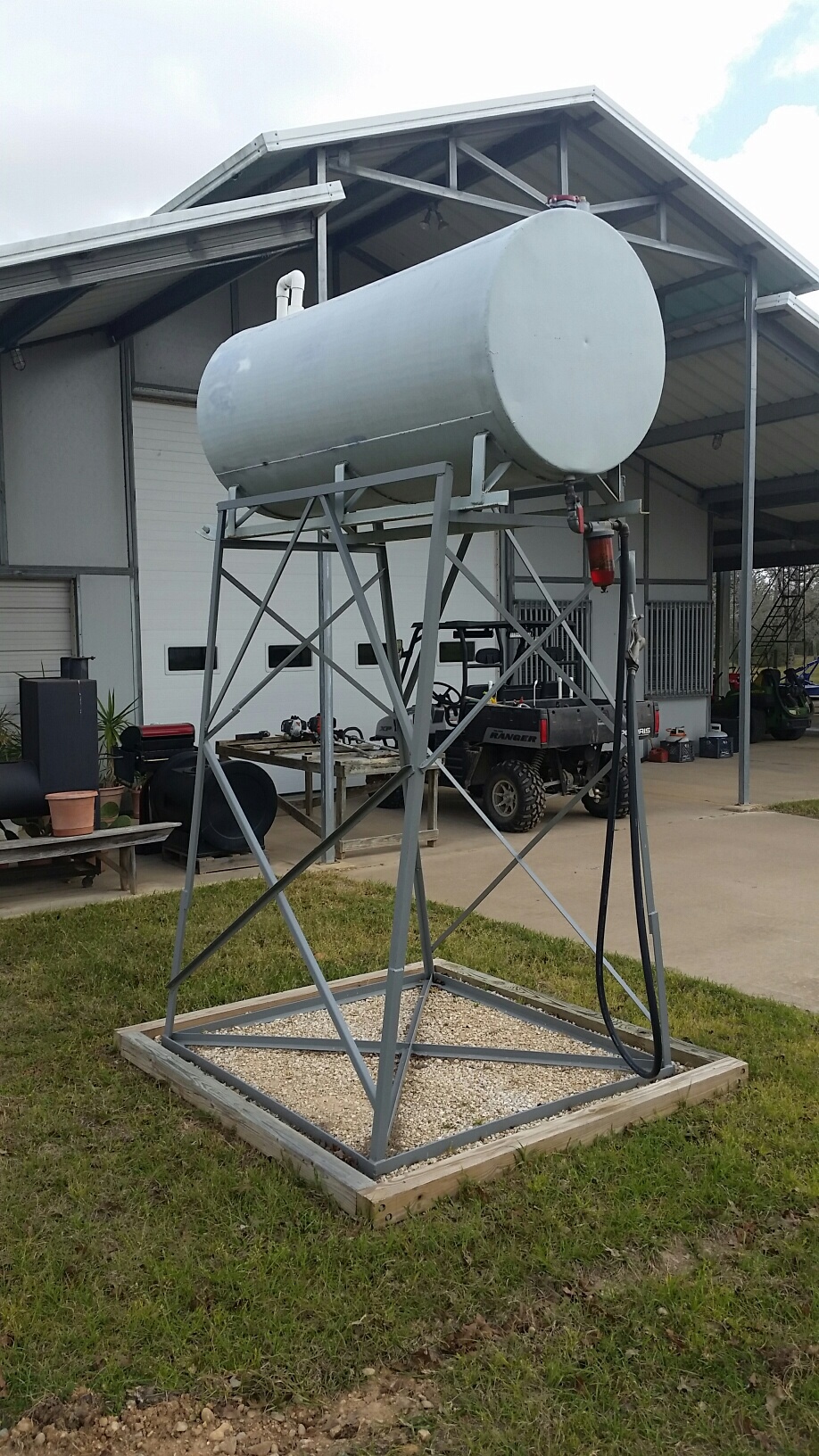

Here's my 300 gallon elevated gravity tank.

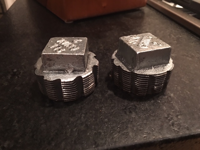

New issue...
I need to clean and refurbish the threads on a diesel tank. There are 6 total holes needing cleaned mainly of rust etc.
I've tried a wire brush to no avail. Only thing I can think of is a tap... but the only taps I can find are online and for sale. While I don't believe anyone should forgo payment for their wares, I just can't stomach a $150 tap to clean out 6 holes. A literal 5 minute job.
Any thoughts? I've thought about getting a 2" nipple, cutting grooves vertically along the threads and using it... but I have no idea whether that will work at all. The metals are going to be roughly the same hardness... maybe even softer than the tank, with galvanized 2" pipe.
Any thoughts would be appreciated. I haven't been able to find a rental. Even Harbor Freight doesn't have one, at least that I can find. The cheapest I can find on Amazon is $88 and they are back-ordered for 2 months.
My goal is quick... I was going to take the tanks to a sandblaster/welder tomorrow evening and have him clean them up. I was removing old fittings this evening, and while there are a couple I can't remove, there are also a few that are acting almost 'cross-threaded' because the threads are so bad.
   / I have need for a farm diesel tank. ? Obround tank for outside farm fuel storage? #99
Grooves in a nipple or plug will work to clean threads.
Bruce
#100

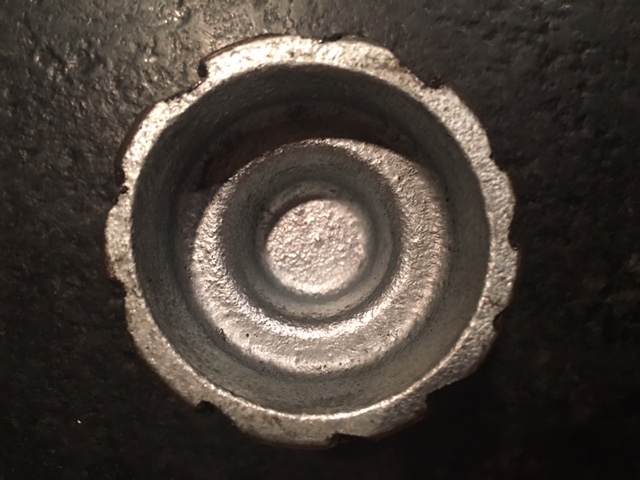

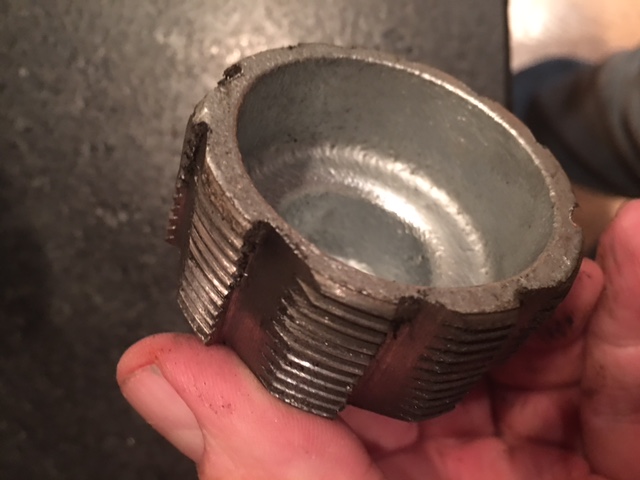

Brilliant!
My $2 - 2" thread cleaner...
The one on the right was my first try... I didn't think about the direction of threads compared to the 'cutting side'. As soon as I set it on the hole, I knew that wouldn't work. I immediately grabbed another plug and flipped it before the grinder.
