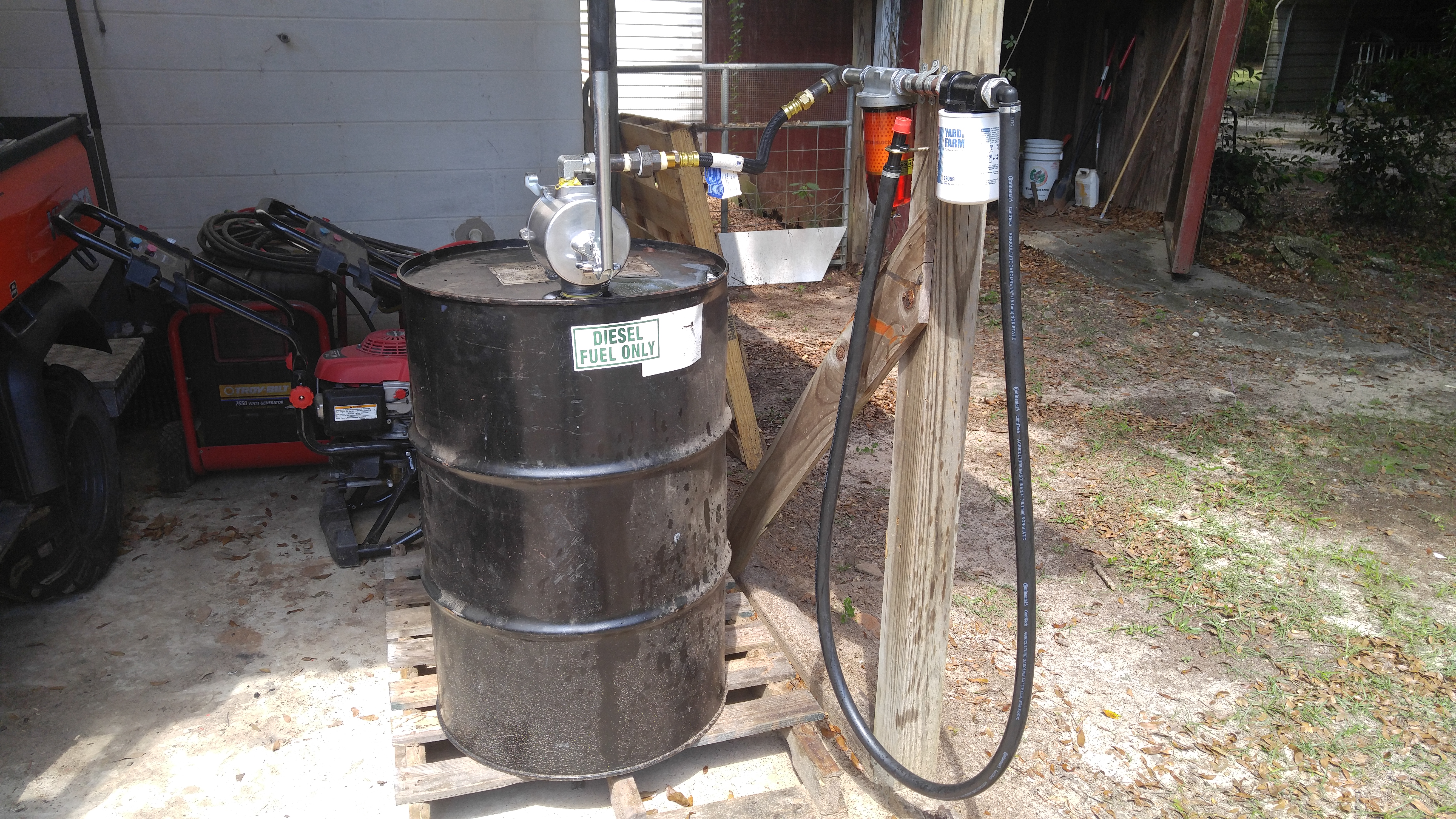

Just to be clear DD... Amazon.com: GOLDENROD 496-3/4 WATER-BLOCK FILTER (56591) Bowl Fuel Tank Filter with 3/4" NPT Top Cap: Automotive is not enough of a filter? I need another for sediment etc? If so, is it Pump->Sediment filter->Goldenrod water filter?
Actually, according to the questions and answers on Amazon, the consensus seems to be that it will remove both water and sediment.
TSC sells this same filter and it is a 17 micron filter. I follow it with a Farm Filter that is 10 micron and use a hand pump. Seems to work well. 0920161329.jpg

TSC sells this same filter and it is a 17 micron filter. I follow it with a Farm Filter that is 10 micron and use a hand pump. Seems to work well.View attachment 481797
According to the link I posted from TSC, the goldenrod filters are 3 microns. That being said, however, it's important to understand the "micron games" mfrs play. Absolute ratings, fudged ratings, etc. I'm working up a bypass oil filter for my Excursion and one has to be Sherlock to find out the real data ;)
Did you find info to contradict the posted ratings? Wouldn't surprise me, but please share the link ;)
Water blocking filters are *supposed* to stop the fuel flow once they've saturated with water. But...I've found that if left too long or if it gets too much water all at once, the filter can break up or fail and allow water and previously-filtered junk to pass :eek:
In a clear filter with drain on the bottom, you can see how much stuff is accumulating, drain any incidental water, inspect anything that looks unusual, etc. You can tell a lot by running the filtered-out stuff into your hand and looking at it and feeling it while you rub it around.
I'll take a pic of the filter setup I have today...

When installing your pump into the tank, adjust or cut the pickup pipe so that it is a few inches off the bottom. Yeah, you lose some capacity, but the majority of "bad things" lurk at the bottom ;) Hence the bottom drain (that I wish I had)
