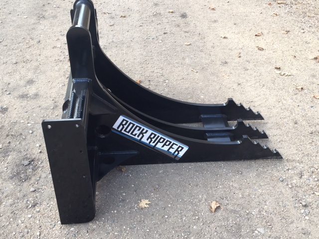

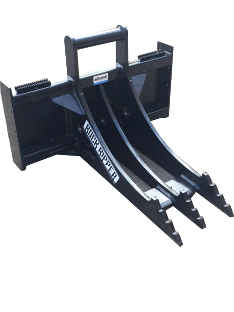

A stump bucket Is a very handy attachment. You would need to get a narrow one that will penetrate deeper than the type that the bottom looks like a triangle.
Here is a slightly different style that looks good: Rock & Stump Ripper - Prime Attachments
Note the straight narrow sides.
   / I have no clue...I need help! #58
Rock & Stump Ripper looks very strong but very heavy for a tractor FEL.
Of course it's heavy. A big SS with Ted behind the sticks can dish out some serious damages. I doubt it weighs much more than a the factory bucket of a decent sized cut since it is so narrow.
