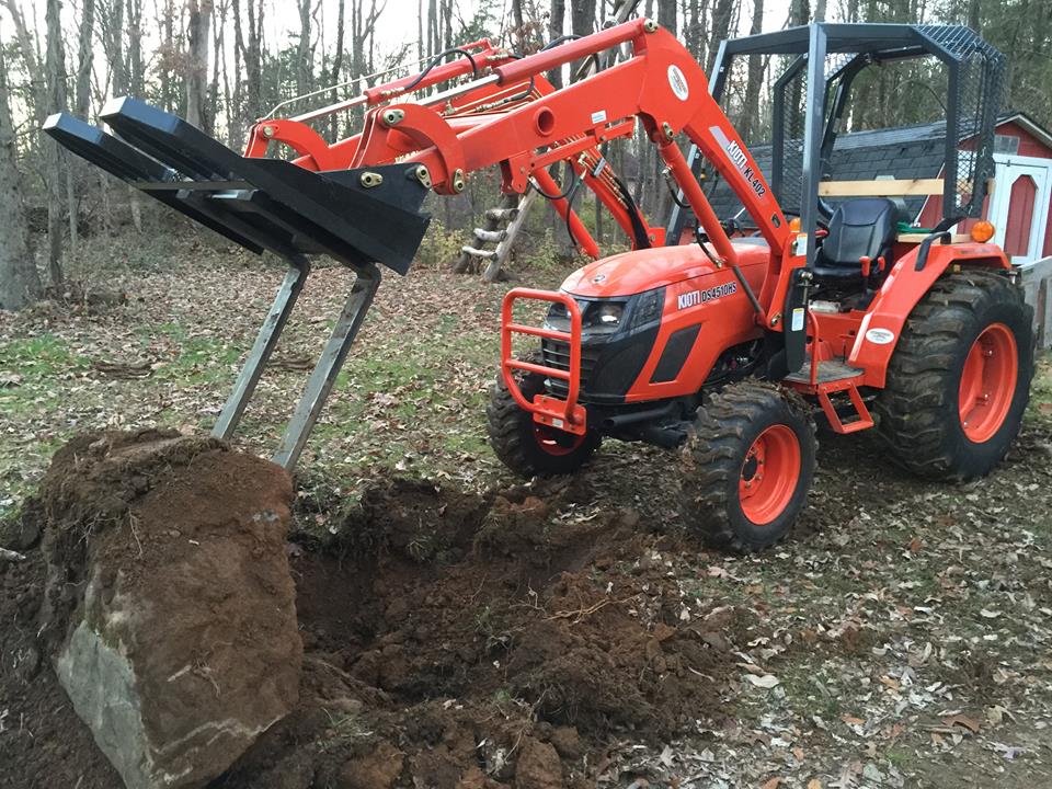

Forks are amazing at popping rocks out of the ground. In the attached picture, I just popped up a 4000 pound rock using forks.

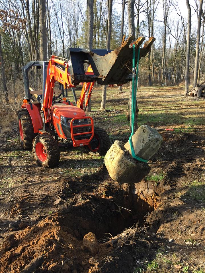

I also have stump bucket and second the post above, that with the right tractor / FEL combo, stump buckets can negate the need for a backhoe for shallow digging (a few feet - depends on length of specific stump bucket). But I wouldn't want to try one on a SCUT. Stump buckets require a strong FEL to work well.

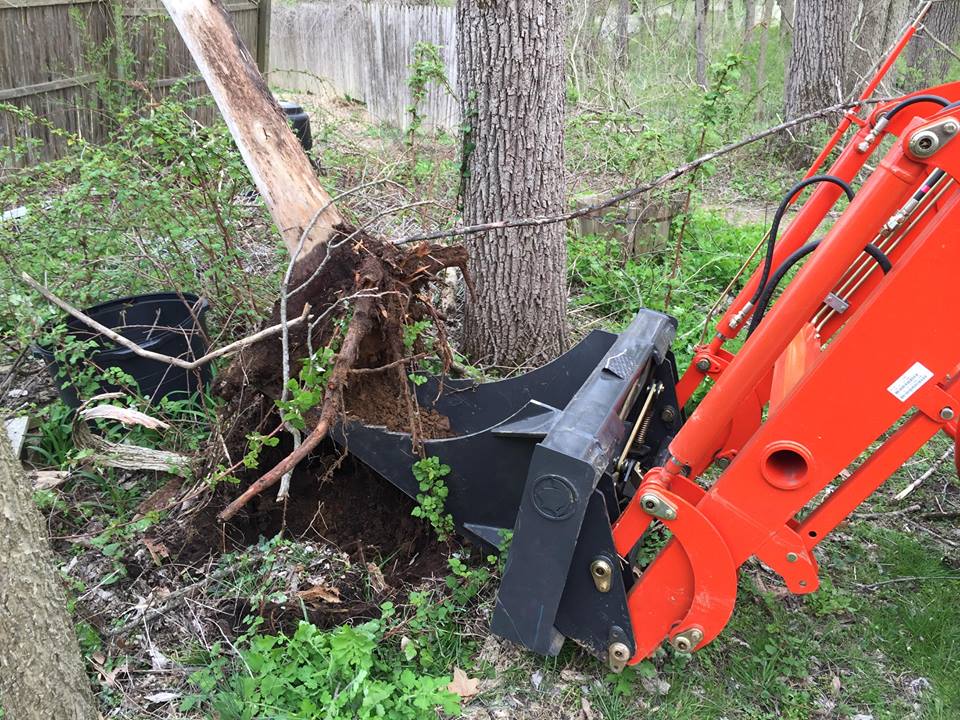

Here are some things a stump bucket can do as you consider your need for a backhoe. A backhoe will dig much deeper but a stump bucket is much cheaper! :drink:

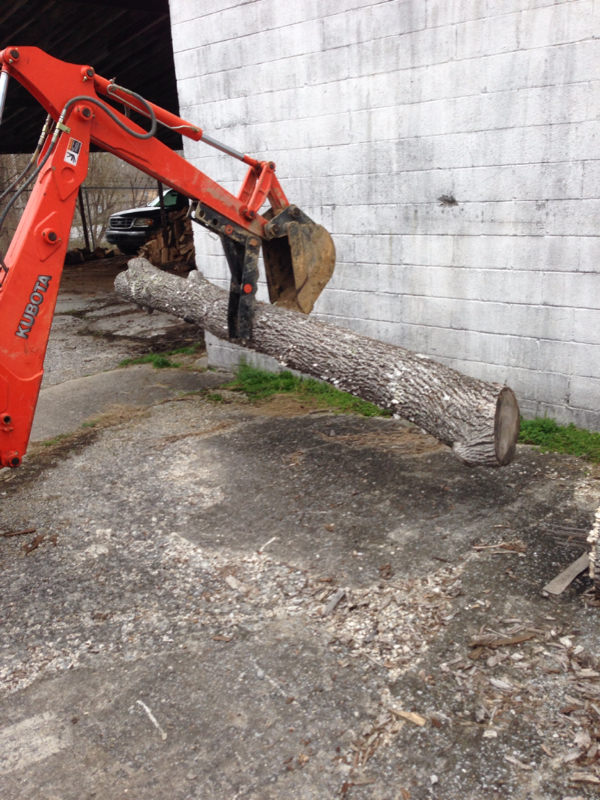

A stump bucket isn't nearly as useful for cutting firewood. A stump bucket can't dig nearly as deep as even a small backhoe. image-56076714.jpg I'd sure hate to be without my backhoe. If my option was buy a scout with a backhoe or buy a bigger tractor without a tractor, I'd buy the bigger tractor.
