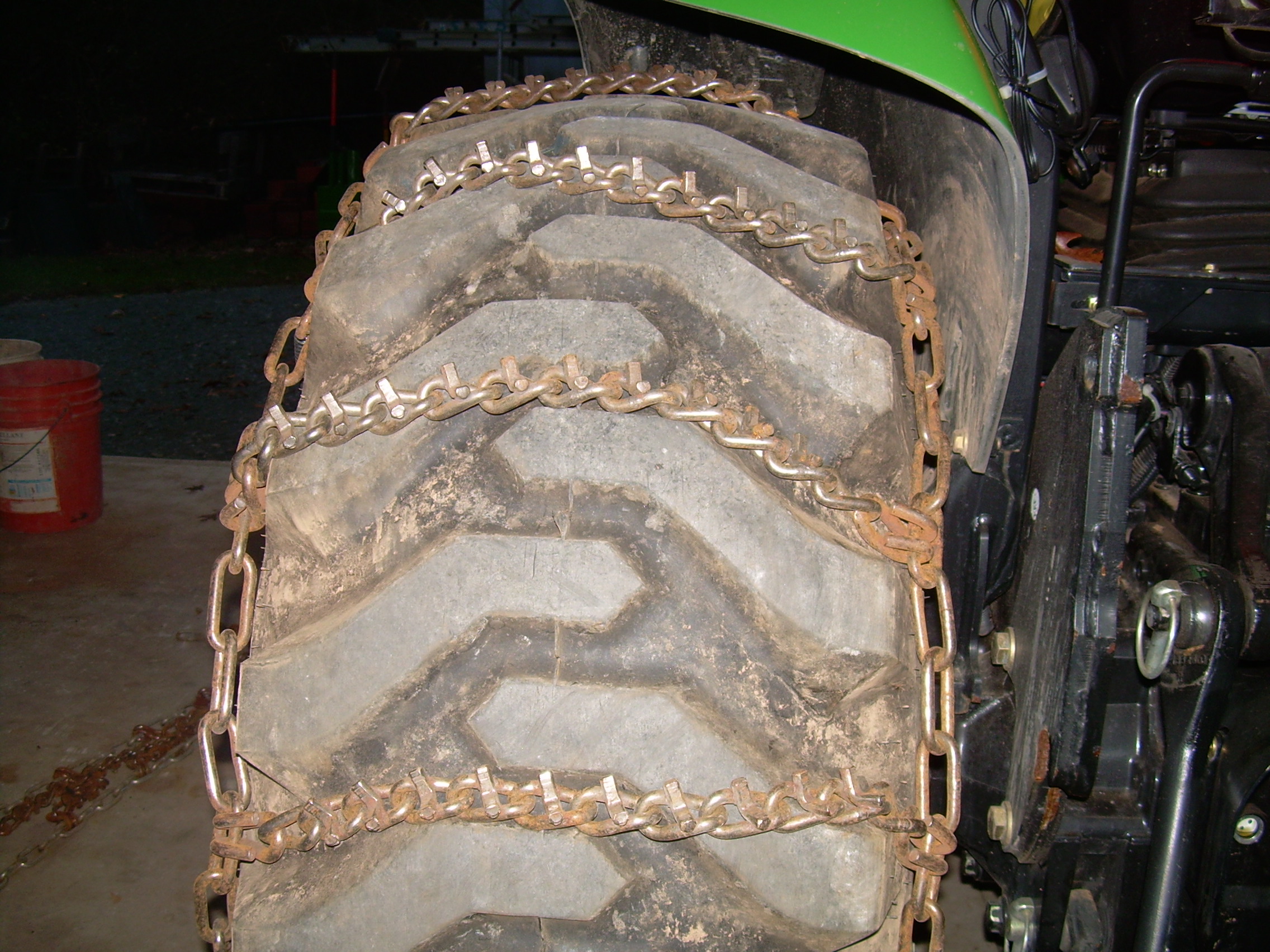

I'm in the process of shopping for rear chains for my MF 1529, thinking about getting 2-link ladder style.....I was under the impression I could just back over the chains then lift the slack over the top and attach the 2 ends.....is that a fair assumption??

That's pretty close to how I did it...however, I suggest you try to work it so the ends are at the 3 O'Clock position (as you face the tire). That way, you will have more access at the rear of the tire.
2 Link ladder chains are heavy (!!!) and quite costly...almost double the cost of 4 link ladder chains. You may want to reassess your needs.

thanks Roy, I've got a steeeep hill from tractor shed to upper driveway.....also heard the 2 link rides nicer..??
   / I installed my snow chains today #15
Yeah...bit smoother.
If your drive is paved, ladder type chains are your best bet...if gravel, you might want to consider a more aggressive chains.
www.tirechains.com has good explanations of the chain types.

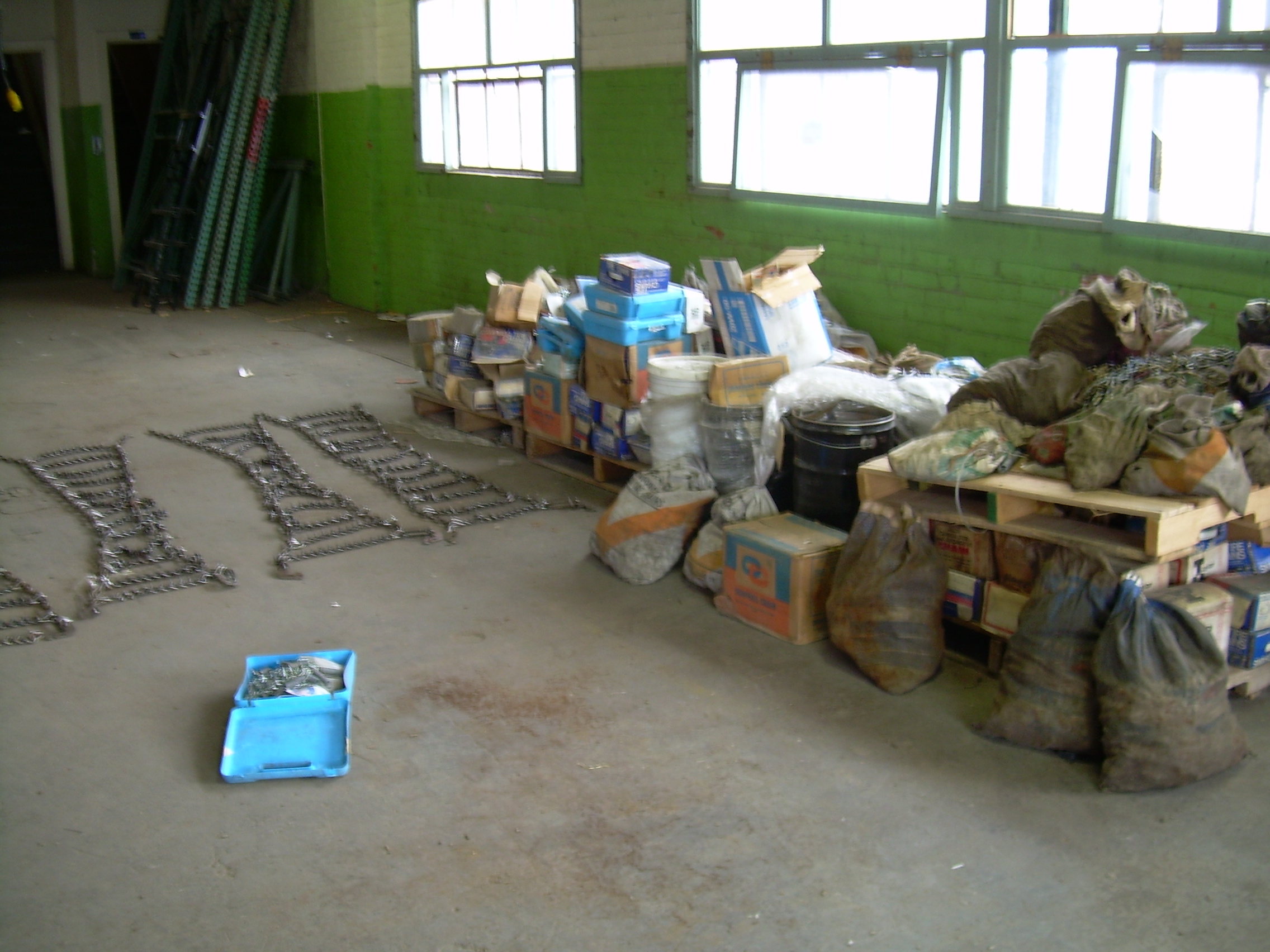

I cut a 2x4 into six pieces about 10 inches long. Lay the chains out at the correct spacing and place 3 of the 2x4 pieces on each side in the open sections of the chain pattern. Drive the tractor onto the chains and stop when directly on top of the 2x4's. Tires ride up on the 2x4's and the chains can then be lifted up onto the tires.
Works well for me.

No noticeable difference in traction, but a huge difference in ride!! get the 2 link if you can afford them, especially if you have to ever drive on a hard surface, not just paved, but any compacted surface. 4 link will rattle your teeth out of your head, as well as parts off your tractor.
Works well for me.
That still leaves alot of wrestling with the chains. Though I guess all methods require some bull work, in odd positions.
I just jack the wheels off the ground, so I can roll them around. Pull one end of the chain under from the back, catch it on the tire lugs and rotate the wheel, pulling the chain up and over the top. Bring the 2 ends together around the 9 or 3 o'clock position (to the rear), hook the inside lock first, then the outside. The good thing about being able to rotate the tire, is you can work most of the slope out and get them as tight as possible. No need to go back and fool around with them after you drive the machine.
