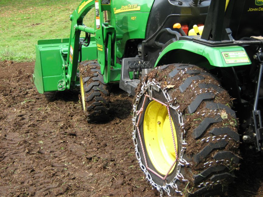

I have 2 link ladder and R4 tires, and the chain spacing is fine. They work slick. I tried snowplowing with and without front chains, and without the chains the tractor tended to float to one side if a deflected the blade fully to one side or the other (20 degrees). However with the chains there was ZERO float. So its obvious that it helped. Also, I'm on flat gravel roads.
On concrete i can tell there are chains on the tractor...bumpy.
On gravel i cant even tell i am running chains

I have 4 links on the rear, you do lose some of the chain between the industrial treads, but there is still enough to provide the needed traction.
I've got extra chain, I may fill in the 4 link to make it 2 link.

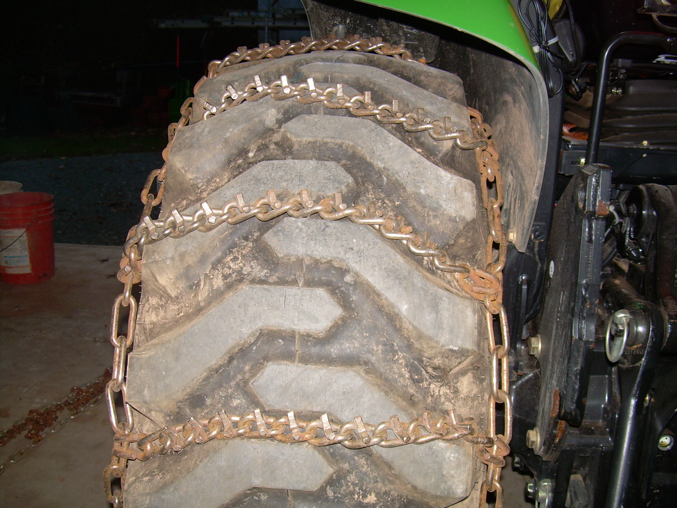

I have 2 link on the front, I made these and all my chains from a craigslist find (see pic) a guy had several pallets of all types of chain he obtained thru a auto supply warehouse purchase, he just wanted them gone. I picked thru them for what I wanted, and paid very little. But I could of got the entire lot for dirt cheap, probably should have.

I also run 4 link v-bars, front and rear with my R-4's and there is plenty of chain over the tread to do the job. I have a pretty decent incline on my road and these sure do the job even when icy. When you put them on you can make them cross the R-4 tread then make sure they are tight and you won't have any trouble.
