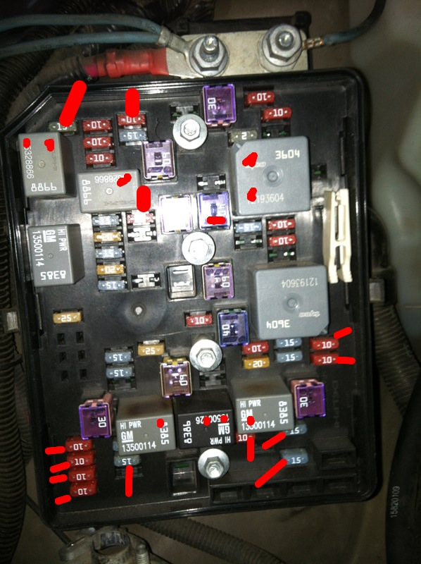

The car was owned by a police department before I got it. It has 132,000 miles and probably 10000+ hours by now.
   / I Just Destroyed My Optima Yellow Top...
#12
You guys were right. The wire leading from the fusible link to the harness is shorted to ground somewhere. I used a paper clip and my continuity tester to check every fuse and relay connection for grounding. The terminals marked in red in the photo are shorted to ground.
