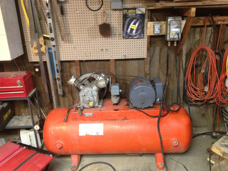

I got the pressure up to 120 psi with this switch, but then the safety valve popped. I'm guessing old, weak spring. I think I can adjust this switch even higher without a problem. I remembered wrong... it's labeled as a 70 - 90 psi switch. Right now after I adjusted it, the compressor cuts in at 100 psi and cuts out at 120 psi, and I still have lots of room to adjust further.
I timed the compressor to estimate CFM, and I'm a little disappointed. I get from 0 to 120 psi in 12 minutes with an 80 gallon tank. The numbers tell me that's about 7.25 CFM.

I borrowed an optical tachometer. My motor is running at 1783 rpm and my pump is running at 956 rpm.
My trusty Harbor Freight amp clamp meter tells me that the motor is pulling about 5 amps when under load (pumping at ~120 PSI).
Looks like I could get a bigger pulley and be just fine.

I'm thinking that at 956 RPM I should be getting a little more than the 7 1/4 CFM I calculated. It's consistently taking 11 - 12 minutes to fill my 80 gallon tank.
   / I Just Got a New Air Compressor #52
My DevAir 5 horse baldor, 80 gallon - I just ran a test - drained it all the way down, plugged back in, stopwatch -
120 psi in 4:30, shutoff @ 150 psi, 5:30. (I don't need 175 psi, and up to 160 my comp. is rated 24/7/365 operation so why tempt fate?)
My pump specs 635 rpm @ 19.8 cfm @ 150 psi, and lists displacement @ 23.4 cfm - I'm assuming that last figure is free air, but it doesn't say.
My motor pulley is just under 8", and the pump pulley is right at 20", it uses two belts and motor draws right at 22 amps running.
I would think that either your pump is designed to run quite a bit faster than mine (it is, according to that spec sheet), your belts are slipping, or you're about to find out how to rebuild an air pump :confused:
Wish I had better news; Personally, I'd make sure belt isn't slipping and try a larger motor sheave before I gave up and dug in further... Steve

That spec sheet I linked on page 2 STILL doesn't make any sense to me - if you do the math based on a 1725 rpm motor, the pump speed is only HALF what the spec sheet says it is - makes me wonder if that compressor actually comes with a 3450 rpm motor. That would make the pump speed what's listed on the sheet.
I wouldn't expect your pump to put out quite as much as mine, it's listed as 15 cfm @ 175 and mine's listed as 19.1 @175.
Still, with it taking so long to come up to 120, it HAS to be either belt slippage, rpm, bad pump, or a combination. I'd probably try at least half again the diameter sheave if you can find one - you might not want to go to the full rated rpm of that pump, but I'd consider at least 3/4 of rating and see what happens... Steve

A theoretical CFM at 1575 rpm with a 3" X 2.75" cylinder is 17.7 CFM and the spec puts it at 15 CFM. 85% efficiency
My 956 RPM should theoretically produce 10.74 CFM and my actual is about 7.25. 68% efficiency.
There are two take home messages...
1) I need a bigger pulley on the motor to get up to 1575 RPM. (or keep my eyes out for a 3520 rpm motor)
2) This pump is not as efficient as it should be indicating that a rebuild will likely improve performance.
How big of a deal is it to rebuild a pump?

My pump (234c2) had the displacement stamped on the dataplate. They've stopped doing that on the newer ones. It matches the grainger info.
That link at grainger, says 15 CFM free air. So CFM would be less @120 or @175psi.
My pump was on a 60 gallon tank, and I remember it being slow to fill up from empty. But to go from 120 to 150psi, where the pressure switch was set to, was not bad at all.
I would not tear the pump apart. Try sandblasting with it first, 80 gallons is a fair amount of air. Might have to stop for a little bit every so often to let the pump catch up. For hobby use, it might be okay.
