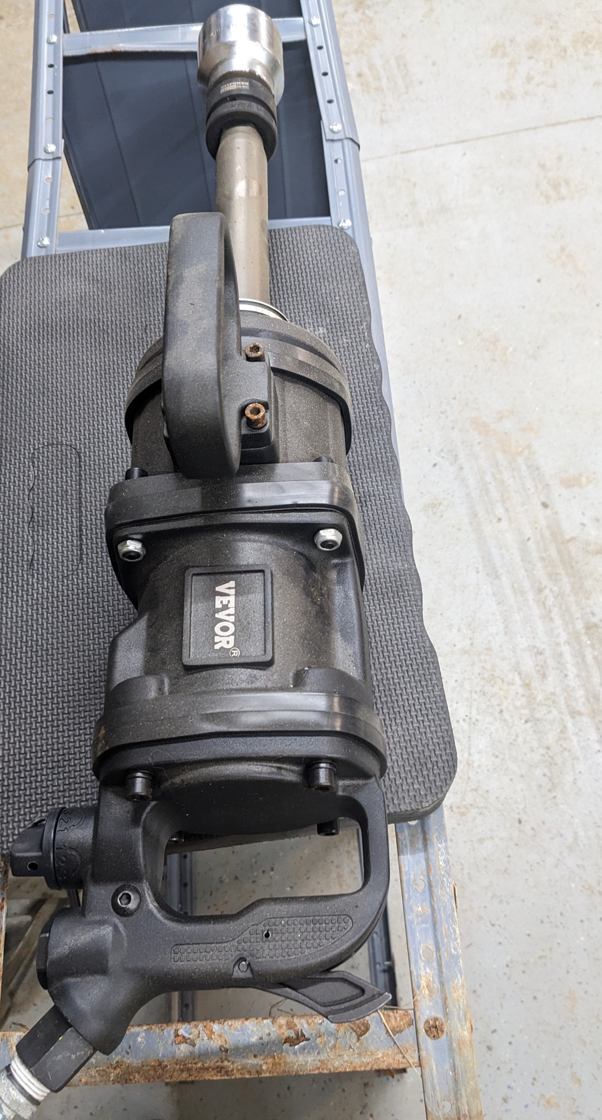

HF Earthquake works for this 74 .
   / I keep breaking 1/2 ratchets on my lug nuts. #89
I like the one she used and it seems like a twin to mine plenty of power but Very Heavy.
The trigger can surprise you, being activated at just the wrong time. Whoever came up with a trigger that is exposed on the back of the rear handle needs to run one of these for a few days, and bet they would change the design then.

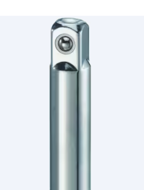

   / I keep breaking 1/2 ratchets on my lug nuts. #90
Putting lug nuts back on with power but not overtightening:
Find an old or cheap 3/8 extension and cut off the socket end. Chuck it in your electric drill and spin those nuts on fast.
Don't used a hex to square adapter. It won't slip when the nut bottoms out.
Bruce

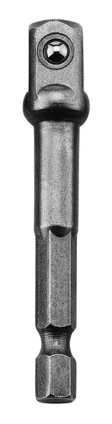

   / I keep breaking 1/2 ratchets on my lug nuts. #91
Bruce
I start my lug nuts by hand, to be sure they're not cross-threaded, but then I use that 1/4" hex to square adaptor to run them all home. My 1/4" hex impact driver is wonderfully convenient and great for driving things like deck screws and lag bolts, but I'd have to work it real hard to ever manage to overtorque a lug nut with that little thing.
After running them all home with the 1/4" impact driver, I set the vehicle on the ground and finish the lugs with the torque wrench.
