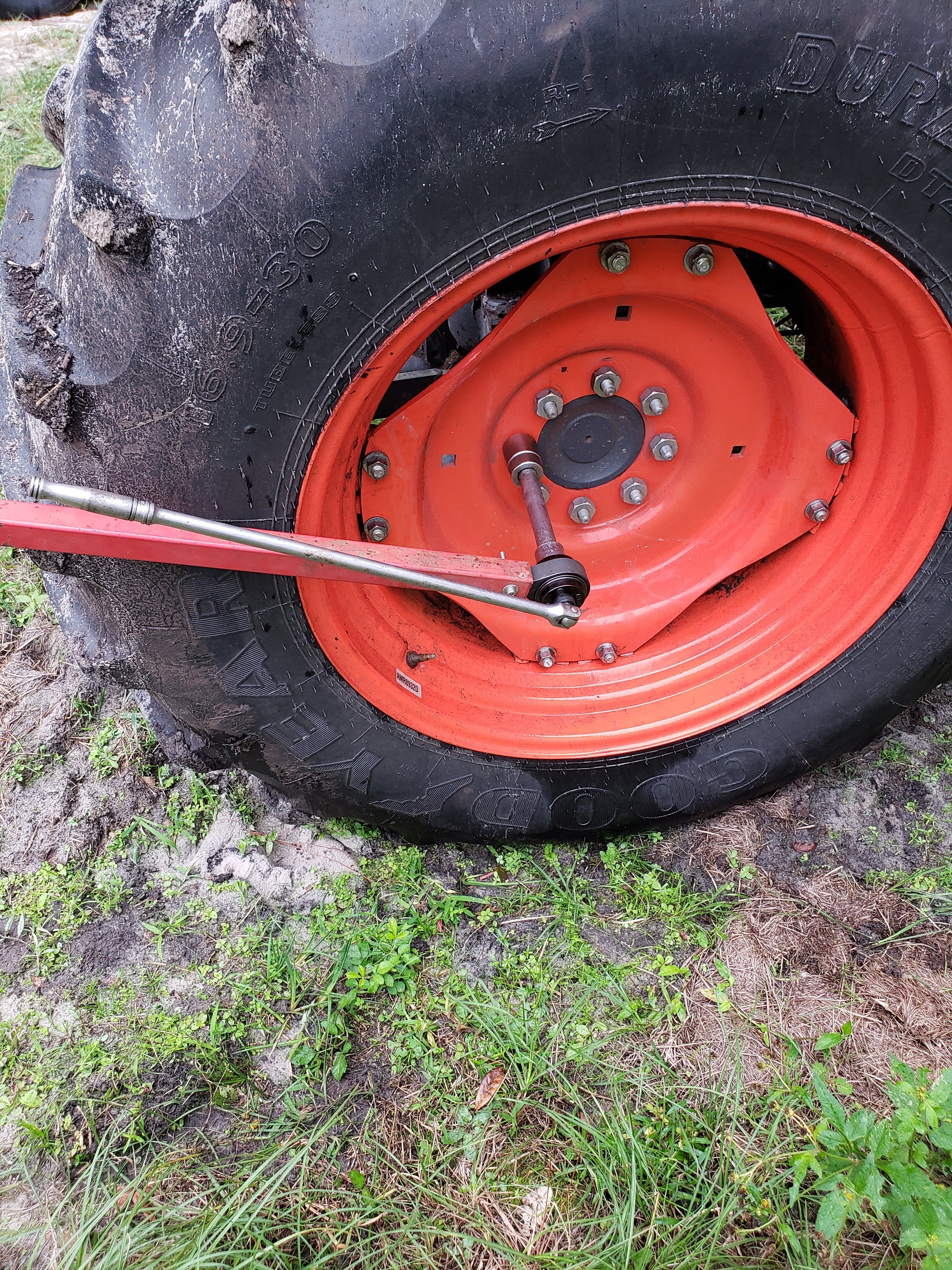

Torque multiplier is the way to go if you have lug nuts that are being a pain. Yes, a good battery powered impact wrench or a good air driven one (if you have enough air volume) will usually do the trick, but when that fails, a Torque Multiplier will spin off just about any tight lugnut within the limits of the socket that you are using. Most Torque Multipliers are 3/4 drive sockets, at least the ones I have seen.

Here is one of my Torque Multipliers removing a lug on my M7040 with almost no effort.

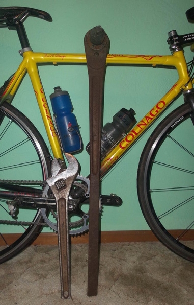

If I ever have a nut that needs either breaking loose, or breaking off, I just grab the Armstrong. It hasn't failed me yet.
wrenches-jpg.853157
As far as Harbor Freight tools. They have a unique ratcheting breaker bar. So far I've been impressed with it. It seems to work reasonably well. It has bigger ratchet steps than most ratchets, so I assume larger pawls. Anyway, it is worth a try. Still, if you abuse it with a cheater, you may be able to damage it.
