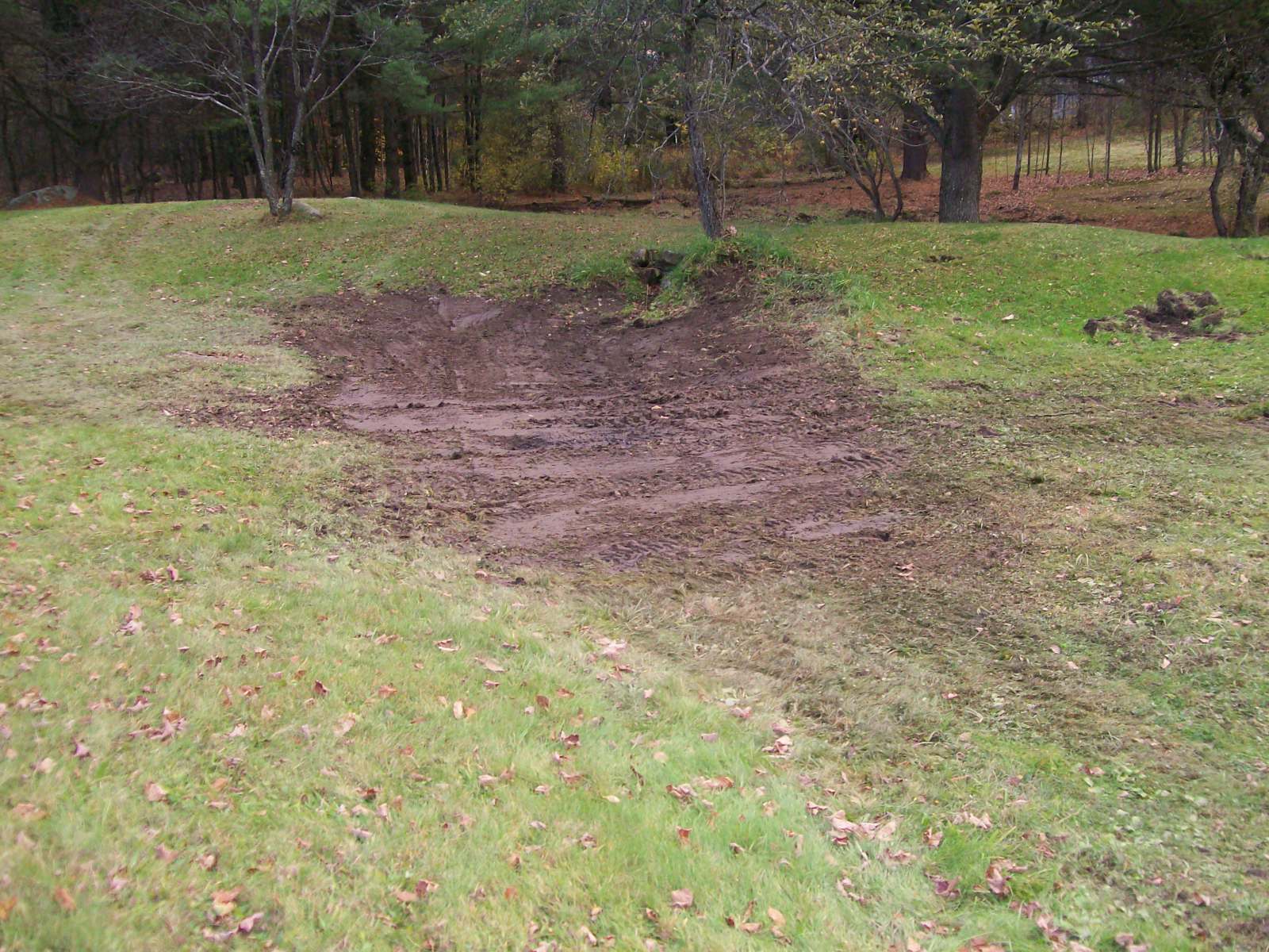

My thoughts are with Egon on this one. I just came in from using my B2620 with a 4' box blade in heavy, and wet clay. I have loaded R-4's and used all the power, and traction I had doing this task. a (I was making a small drainage swale that could be easily mowed) If your soil is lighter as in more loam, or gravel a tractor like mine would cut in the driveway though it would take a while. It's amazing how many bucket loads of dirt you will remove on just a small area! Still, a larger B, or an L certainly wouldn't be too much for your initial tasks. With only 85 hours on my tractor, I'm still learning about using the "quarter inching" on the 3pt for tasks like box blading. So far, I'm still wishing it had position control, but there would be a learning curve anyway. If you want to keep the cost, and size down, I would look for a used Kubota B2410, B2710, or B2910, or a JD the same size. I have seen both used, and in good shape at dealers around here just recently........ and wondered where they were when I was looking. :D Good luck with your shopping, and have lots of fun using it when you find one!
Here is the little job I did this afternoon. The area is about 50-60 ft. long. The other dirt in the picture was dug up by the wild boar the other night.
