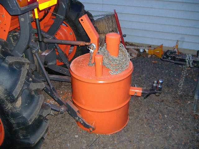

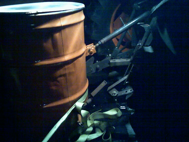

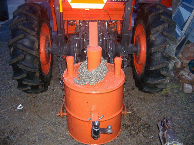

just get a piece of channel iron or 2 pieces of 2" x 3/8" thick x 12" or so long. Weld a "t" across the back and cut hole in side of your barrel. Once filled and dry with concrete, it will not go anywhere!! The particular one I have now has channel coming out of top. My old one protrudes from the side of the barrel, position it so your toplink will attach slightly above parallel to the lower arms.

The main thing all the links should be basically parralle for the linkage to follow the arch
Your top point is mounted to far up on drum too far in relation to the bottom links they should be in about the same angle your botom link are about 30 degrees below horozinal anf your top link is 30 degrees from verticale it looks like it is too long too like most rvery one else said but set the angles the same to get measure ment for length anfd

What distance did you put your top link from the bottom link? I measured a scraper blade and it was around 16 inches to the center of the lower pins to the center of the top pin. Obviously you couldn't make the top link even with the bottom, from your picture it looks like your top clevis is only 2 to 3 inches from the edge of the barrel. Did you end up using a cat 0 top link?
I am looking to go the same route with a 30 gallon barrel and just wanted to see if I could get an idea of where to put the bottom bar and the top clevis.

I took a measurement from the pivot point of the top link to the pivot points on the bottom on the tractor, and transferred that to my barrel. I did use a Cat 0 top link, and it does work very well.

Oh, BTW, I built the first one wayyyyy too heavy and the tractor couldn't pick it up..........I had some bad information. I sold that one and built the one with the smaller 30 some gallon barrel, at around 300lbs that works well.
   / I need a 3 point hitch geometry lesson. #20
You may want to check the specs on your rear tires and axle. Adding even 300lbs. could put you over the limit. Is the FEL factory or did you build it?
