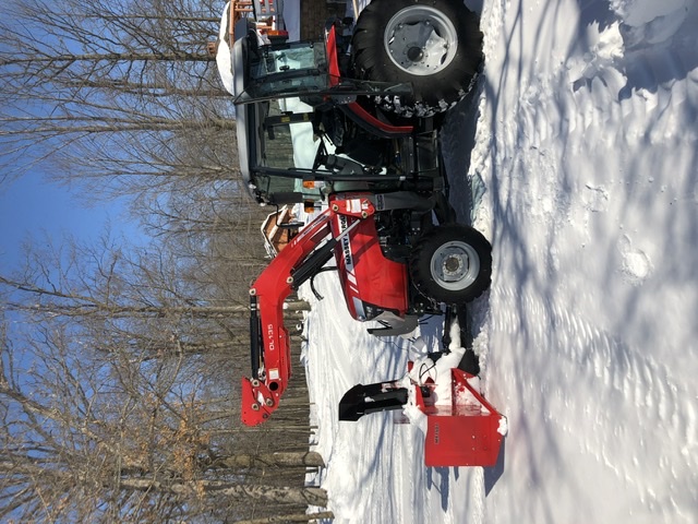

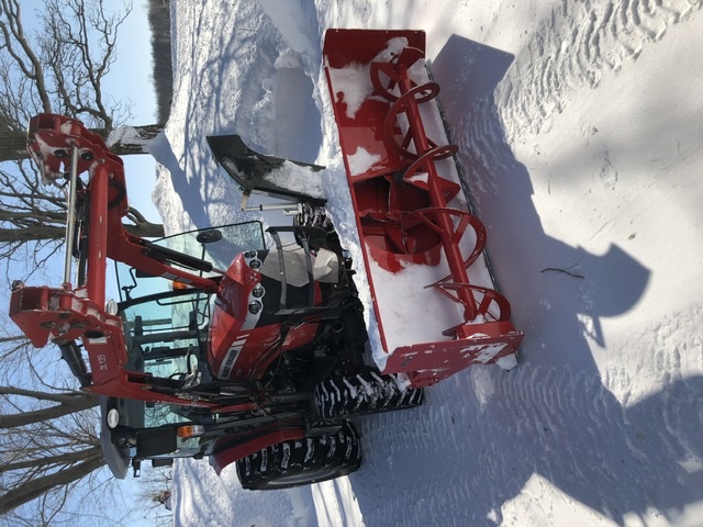

Just as an FYI, I leave my loader on all the time. I remove the bucket or forks, raise the arms high enough to see under them and hydraulically lock the them in position with a high pressure ball valve i installed on the raise hose. Then I can unhook all 4 hydraulic lines and use the joystick to operate the front mount blower. Takes a couple minutes to remove the blower and reconnect the lines. Not ideal, but you cant beat a front mount blower.

EA06870B-295A-4BA8-8360-C6C739DA17E5.jpeg6E2C98D4-4F57-430D-AEE3-BA4B259A64D8.jpegE66ABA37-8980-43EF-9A89-FEA7860B741F.jpeg

Here's another way to hold the loader arms up.
   / I need a rear snowblower for my GC1715 #17
That is a better way, for sure.
For a SCUT, that's not a bad plan. Put some magnetic mount LEDs on the loader frame, and you'd really have something.

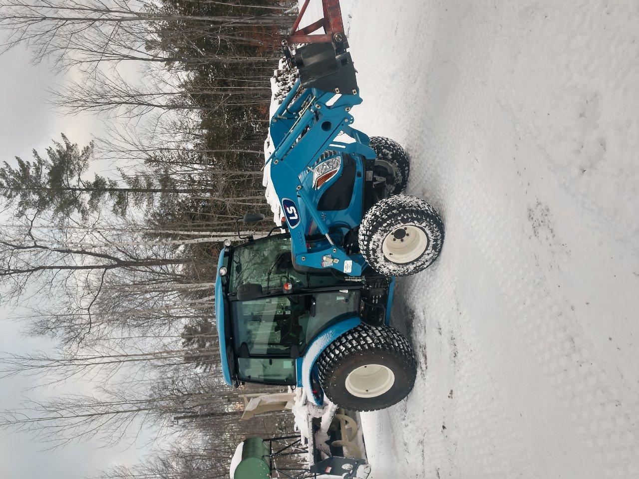

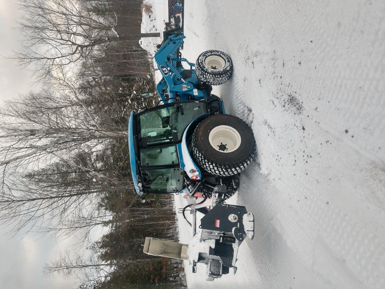

I cannot use a rear blower that must be operated in reverse due to neck issues, so I went with a pull type blower. So far it has worked well. I have an old cheap $100) back blade mounted on a SSQA to push snow and back blade with.
Driving over a foot of snow is no issue, but I do not get the 2-3' drifts you have. If I had to deal with that, I would use the front blade to push them to a manageable height, or the FEL. Having the SSQA setup for the front blade is important to me as I use the FEL or pallet forks.
Driving in reverse is not fun so do some testing as suggested above.
My pull blower is a FarmKing and I am happy with it. It was $3000 less than a front mount for the LS4140 I have.
