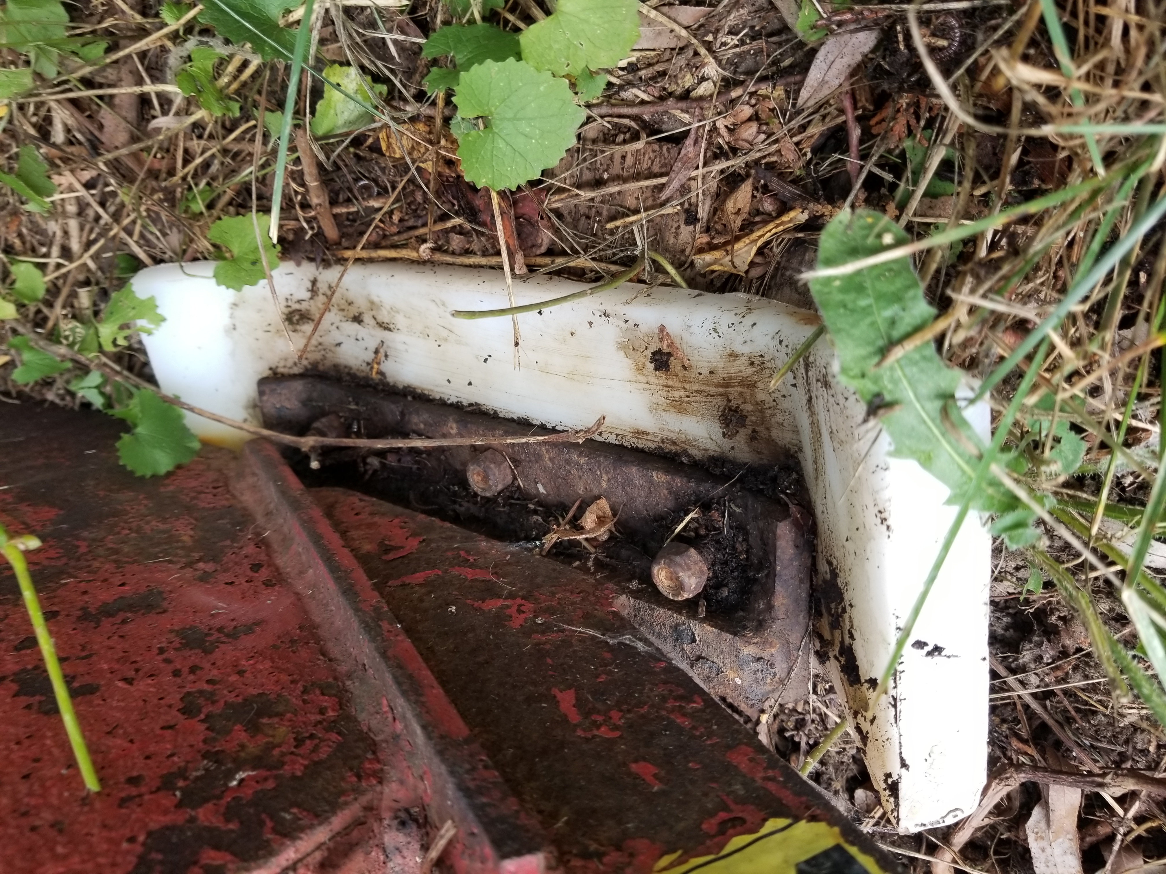

So with any luck, here's a picture of one side. I bout a four-foot piece of 3/4-inch x 4-inch HMWPE, cut two pieces with the table saw each a foot long. To bend the ends, I clamped it into the vise, and heated it with a propane torch until it was translucent. Heat both sides, or it will crack. I recommend a fan, that stuff stinks. Once it bends, you may have to hold it there until it cools. Anyway: I then drilled three 1/4-inch holes in the shoe, and then through the plastic. On the bottom-side, I used a spade bit to countersink the bolt head so it won't wear off. Ny-Lock nuts on the bolts so I don't have to worry about re-tightening anything, and I'm all set for forever or until I wear down the shoe.

Nice fix.

Thanks for taking the pic; much appreciated. I can see how that would definitely help with the digging in.

Bolts coming out...my OCD says fix it :)

About these shoes people are making to avoid digging downward into gravel: I find that careful adjustment of angle using the top link solves those problems (for me at least.) If the blower is tipped "mouth upward" very slightly it will never dig into the gravel. I've run on smooth, small gravel of my own driveways as well as much longer rougher distances out in the access road and never a problem.

I will assume you meant the front bolt in my picture, because I noticed that when I took the picture, and said to myself, "Self," and I knew it was me because I recognized my voice, and I was wearing my underwear, "Self," I said, "You're going to have to pick that up and find out why that bolt is coming through, and replace it."
-and I didn't really want to hear that, but I will get a round tuit next time I go to town, and get it done before snow.
