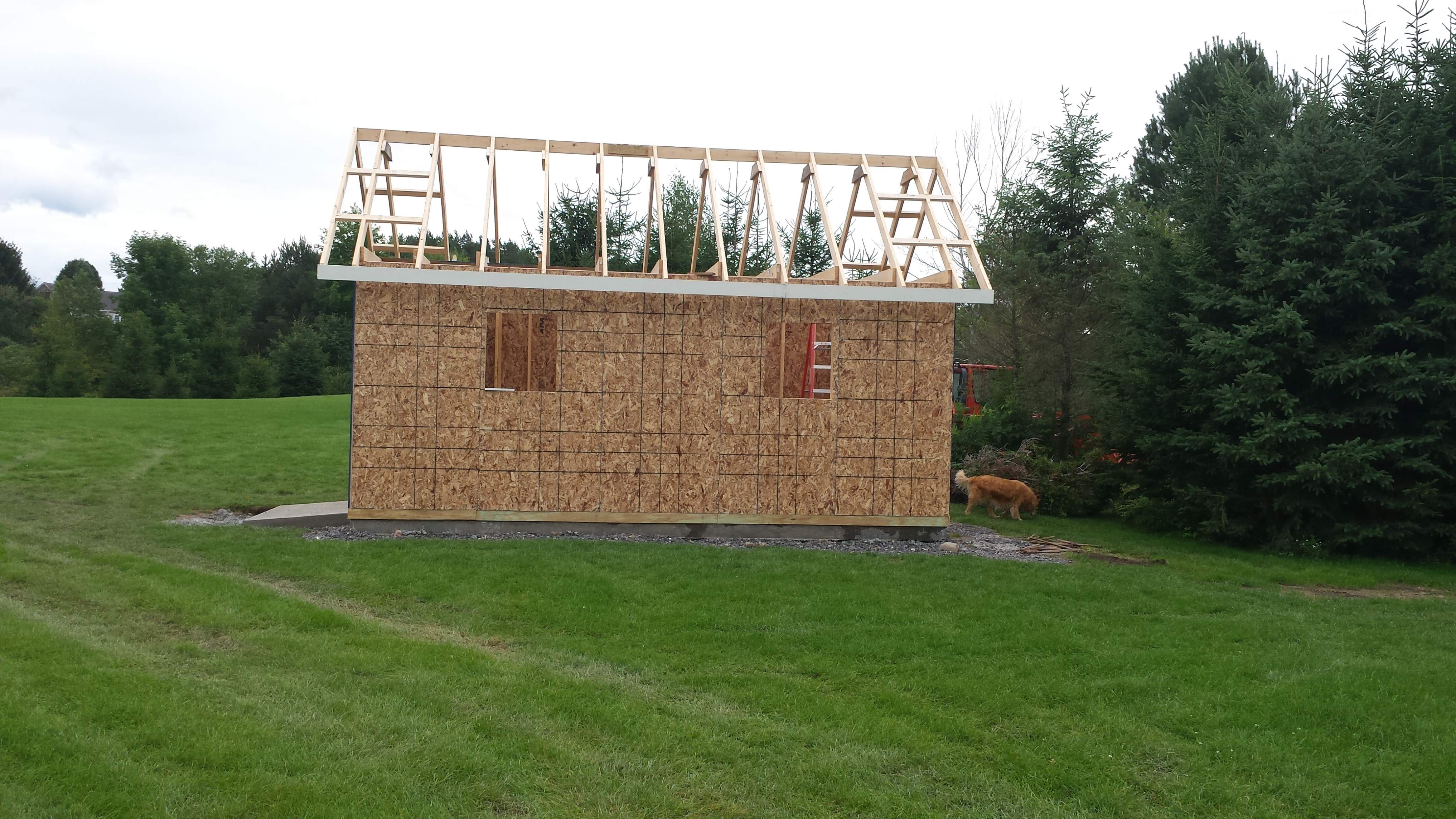

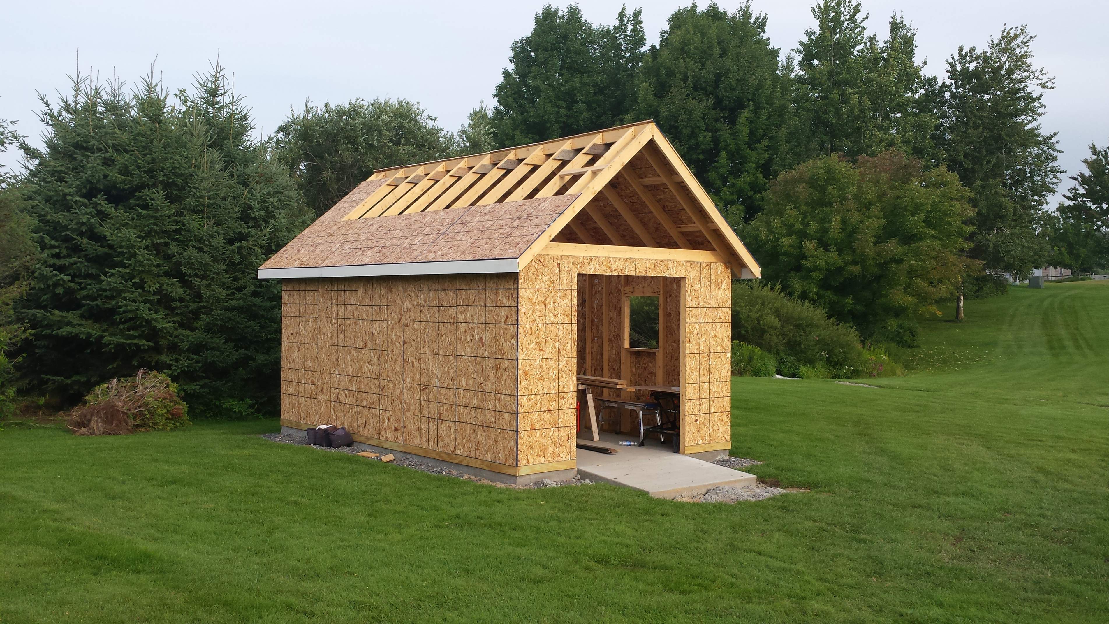

The weather didn't cooperate very well last week and I was away over the weekend so progress slowed down. My son and I did manage to complete most of the roof structure.
The weather is supposed to be better this week so hopefully I can get more done after work.
Kevin

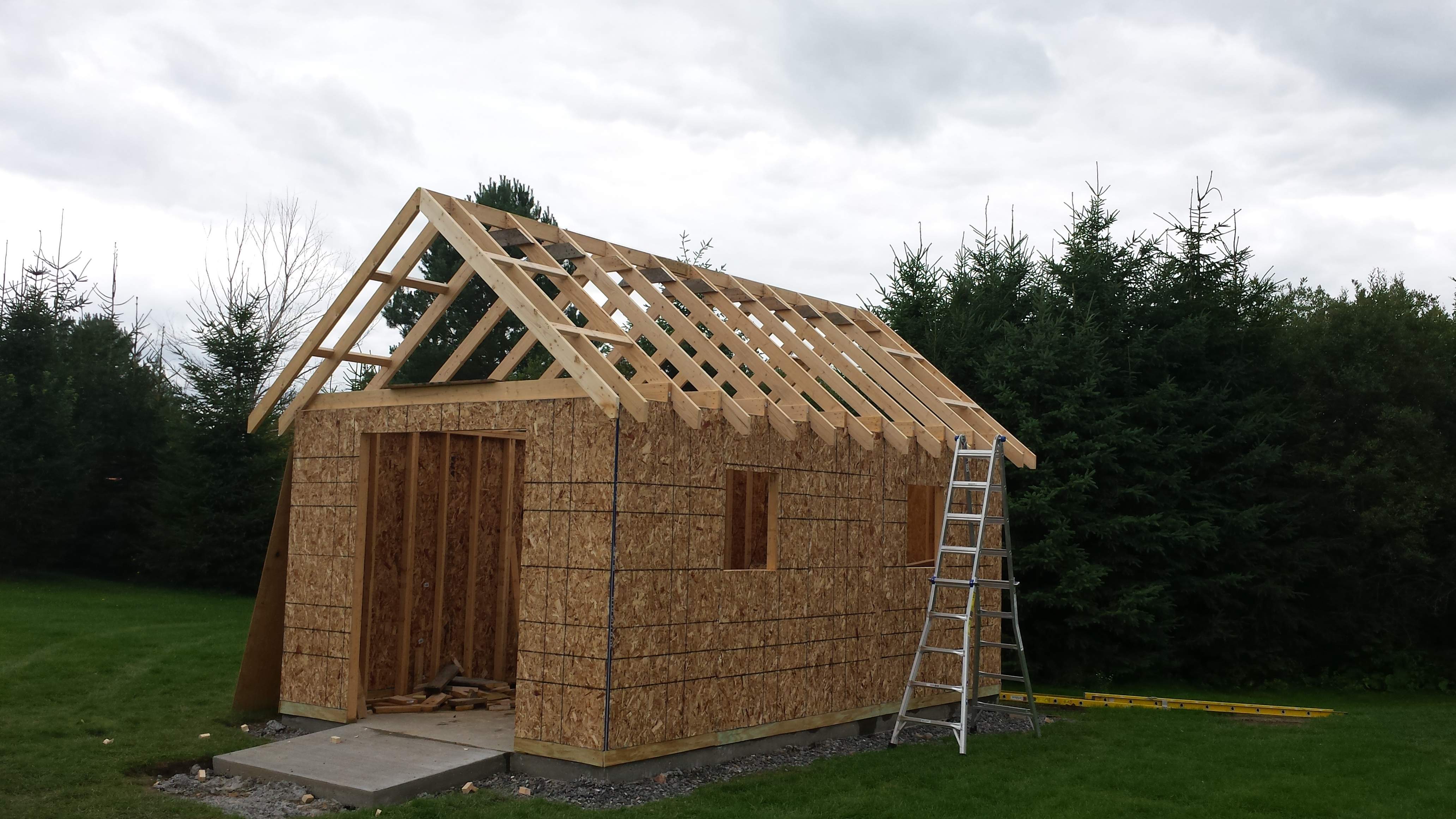

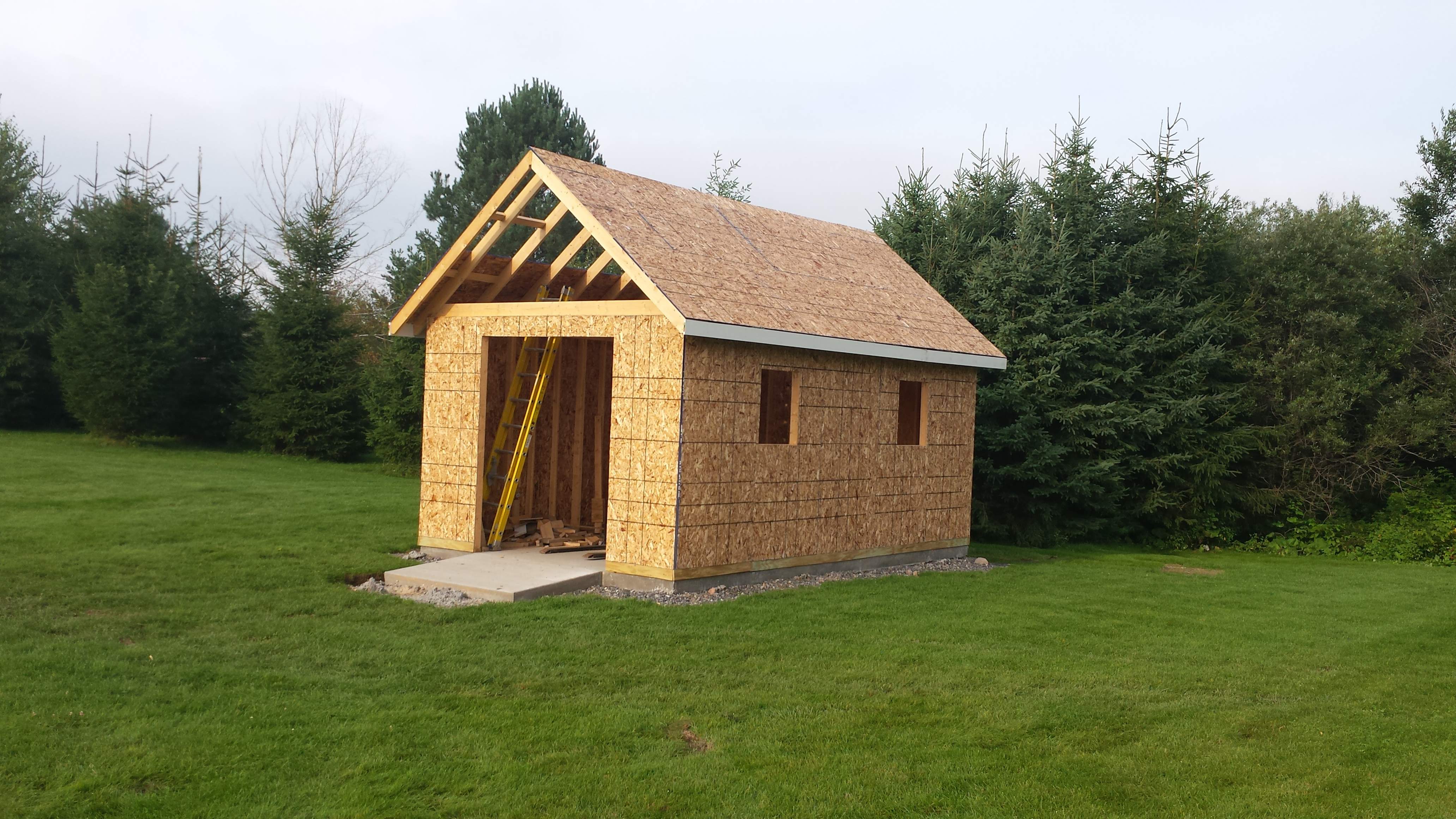

Well, I got some of the roof sheathing on yesterday after work. Working on a roof by yourself is rather time consuming.

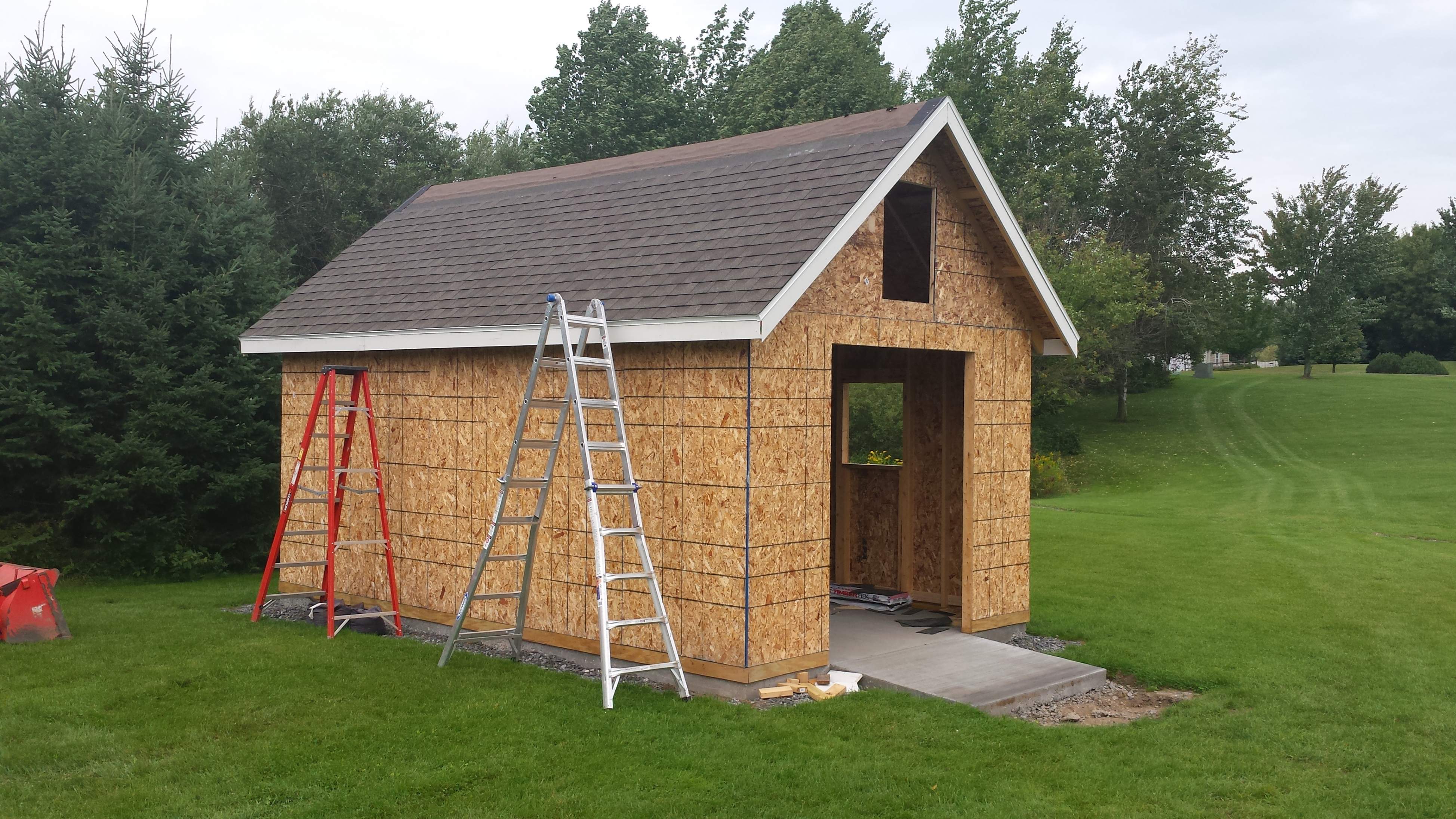

Things are going slower than I would like but I'm make slow progress. I've been working on the shed after work and there isn't much time before it is too dark to see what I'm doing. I'm hoping to finish the roof this week and hopefully work on the siding this weekend.
Kevin
