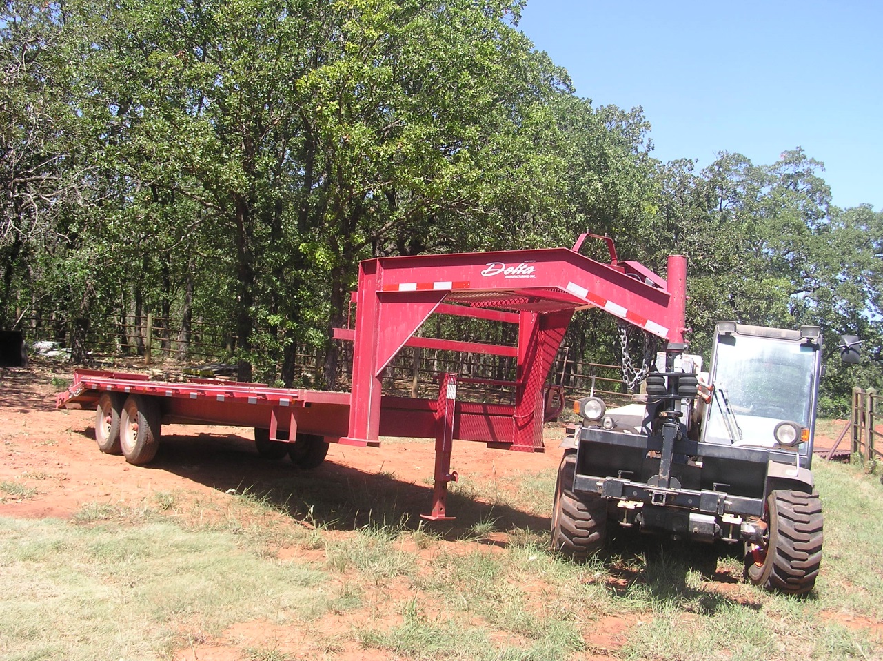

Tongue weight is a concern but goose neck is out because I use a contractor cap on tow vehicle. I'm hoping I won't need weight distribution hitch for short halls but safety first. Thanks for the input.

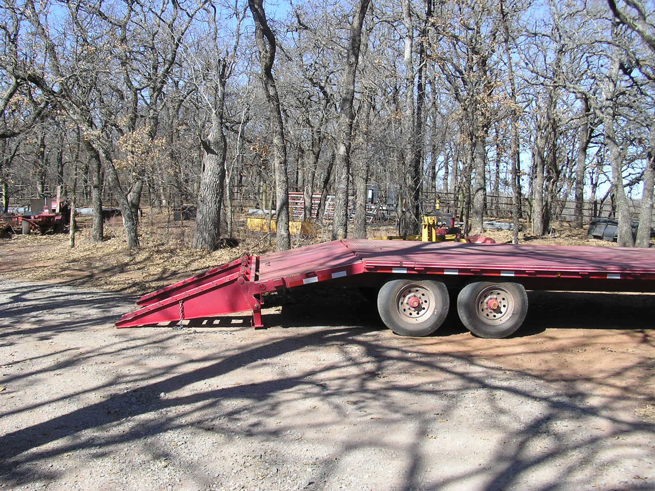

Yes pretty much. I'm kind of on the fence about a Beavertail though. Has anyone used both?
I have a Beavertail, and the issue is clearance. Mine is an 18 footer, and when I move it around my lot with the Fel of my tractor, I have to be very careful about how high I lift up the front end. The backend tends to drag on the ground if you lift up the front end too high. So, I would not get a Beavertail if you're going to be driving over rough terrain.

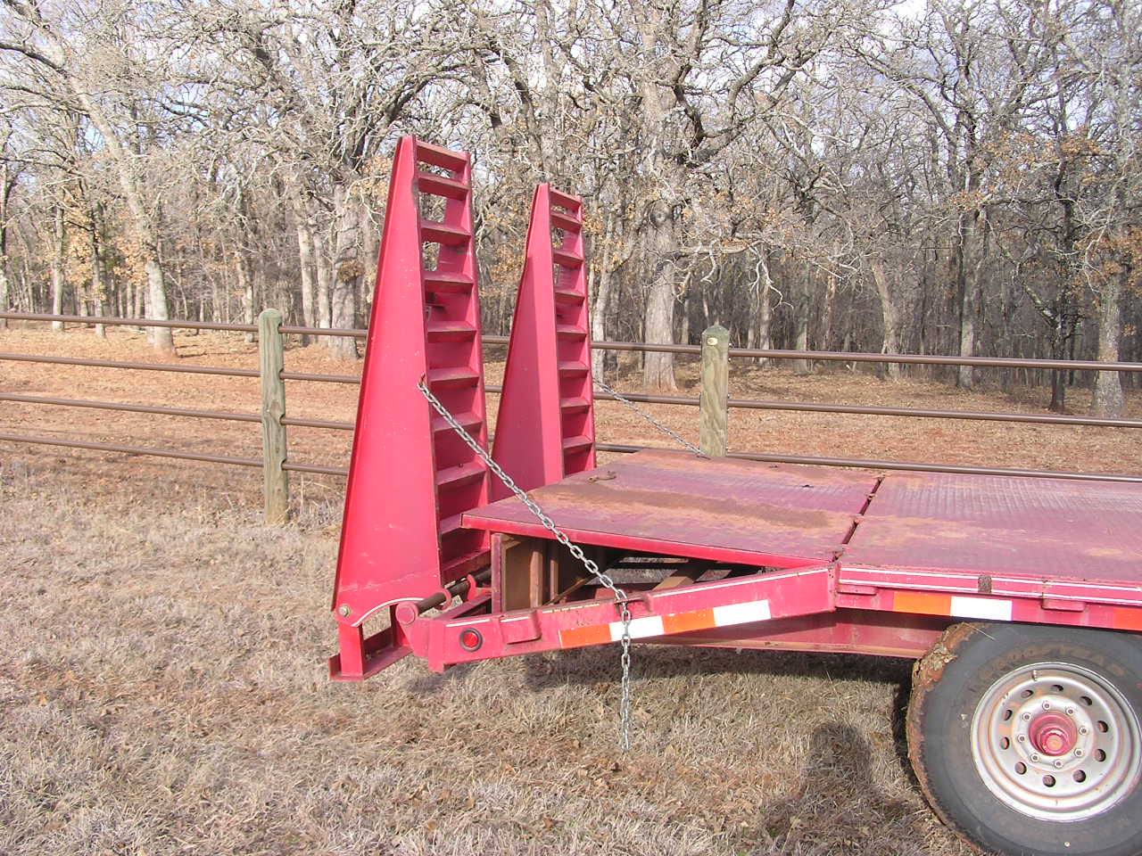

Most Beavertails are 5' long and will drag on rough terrain.
Mine is has a 4' pop up and has never got hung up in the terraced hay field.
The ramps support the weight when driving up the ramps.
When I park it with the FEL, I pick it up high enough that the front axle is off the ground, that makes it easier to jackknife into place and the back of the trailer still has plenty of clearance.
   / I need help deciding on new trailer #87
For a smaller trailer I would not get the beavertail unless it was a deckover. My 18' with slide in ramps [I hate them by the way because I almost always haul equipment] is the most versatile like Diamond said. CJ

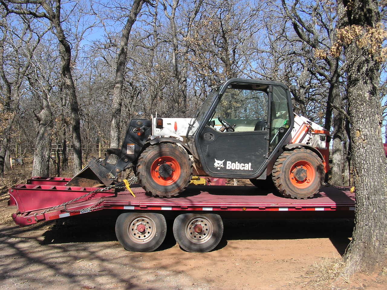

Well the plug has been pulled. Today I ordered a 20' 10 k Beavertail 60/40 axel split. heavyweight stand up ramps 7 k jack and tongue box. Decided on stand up ramps for 2 reasons; main use is hauling tractor or mower. Secondly, I have a set of 5 foot medium duty ramps that I could switch to if these are a problem. Thanks for everyone's input I really appreciate hearing others experiences. It helped a lot in working it out in my mind what will be the best for me.
