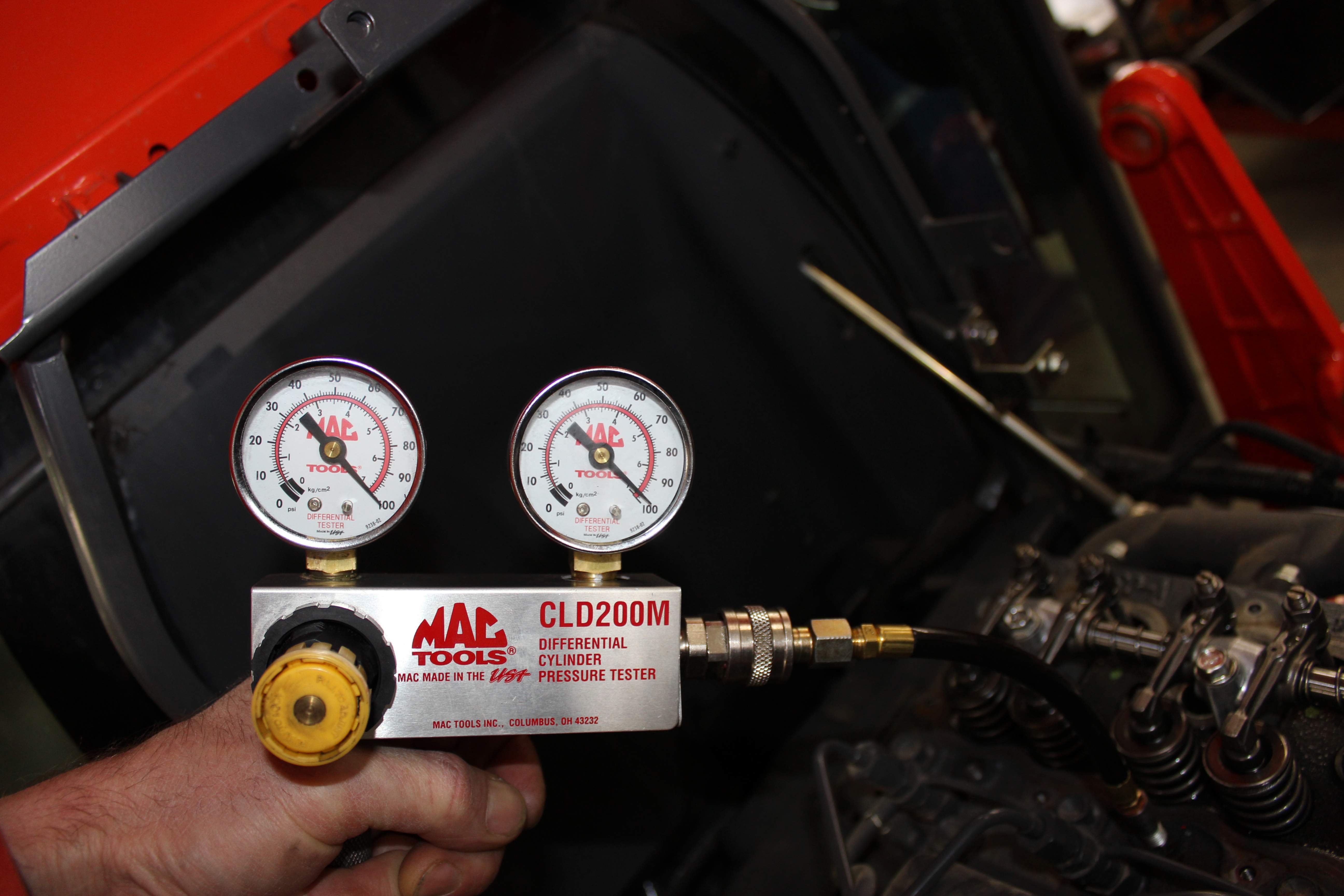

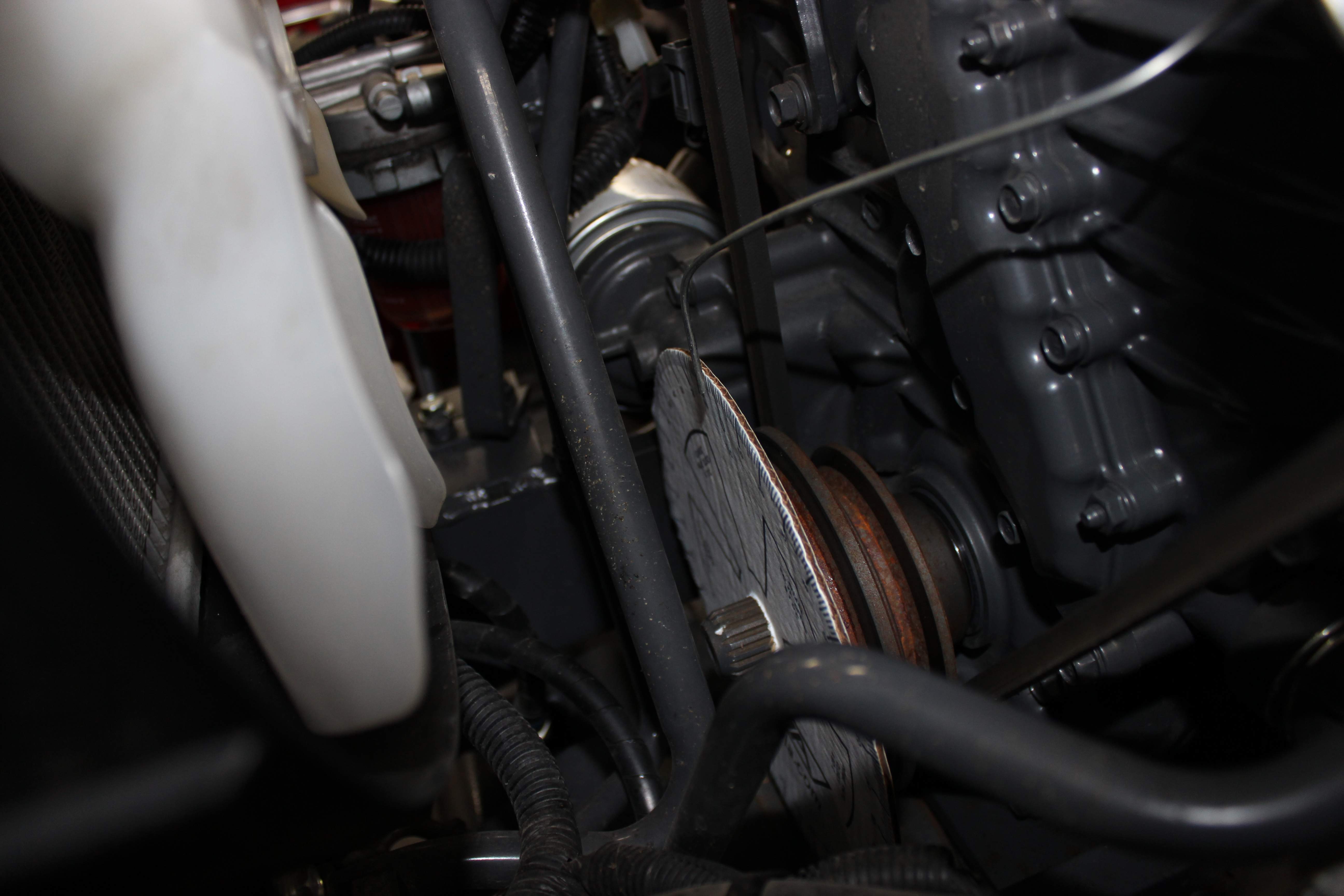

I'll admit I like everything I own to work perfectly and strive to make it like that. I should have tried before buying but didn't. I jumped on this because there were no more larger 40 series tractors around, they are gone. Took 2 hours this morning and set up a degree wheel to the front pulley becuae the loader frame covers the timing port in the clutch housing. Sidenote: I would bet real money that no dealers check the timing and tear thse things apart. What a PITA.
Anyway here's my notes from this morning:
12-7-2013
Compression (cranking) 400 psi. all 4 cylinders (factory spec 520-580). WSM discrepancy?
Wrong manual for the tractor? WTFKnows
Checked Snap-On gauge against Nitrogen tank regulator gauge and both match closely.
Fuel Timing check #1 cylinder 17 degrees BTDC.
Leakdown test : #1 cyl. - 2%, #3 cyl.-3%, #4 cyl.-6%, #2 cyl.- 3%. NO leakage through valves.
Valve adjustment varied from .003"(#1 cylinder) to .007" (most others).
Adjusted all valves to .008".

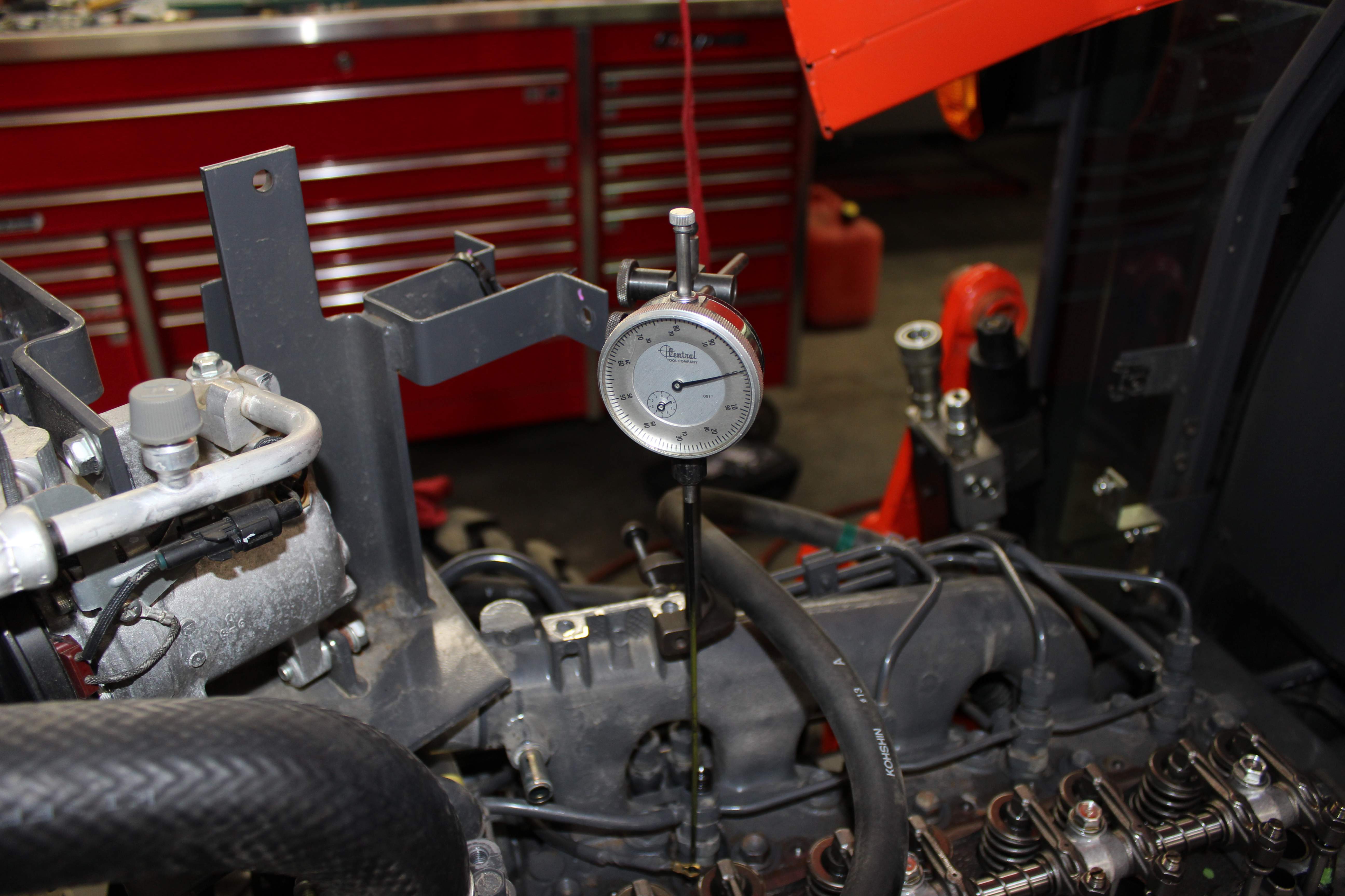

Checked installed camshaft position, with overlap split degree wheel right on TDC #1 cylinder.
All valves checked at .050" lift.
Intake valve opens @13 degrees ATDC. Closes @170 degrees BTDC.
Exhaust valve opens @147 ATDC, Closes at 19 BTDC.
Intake and exhaust valve lift is .305".
Any other things I could check? Fresh out of ideas. Other than the timing being of MAYBE 2 degrees retarded and the tight valve adjustment I see nothing wrong with this. Tractor has 50 odd hours running time. Air filter minder hasn't moved. It just acts like more air is needed.
