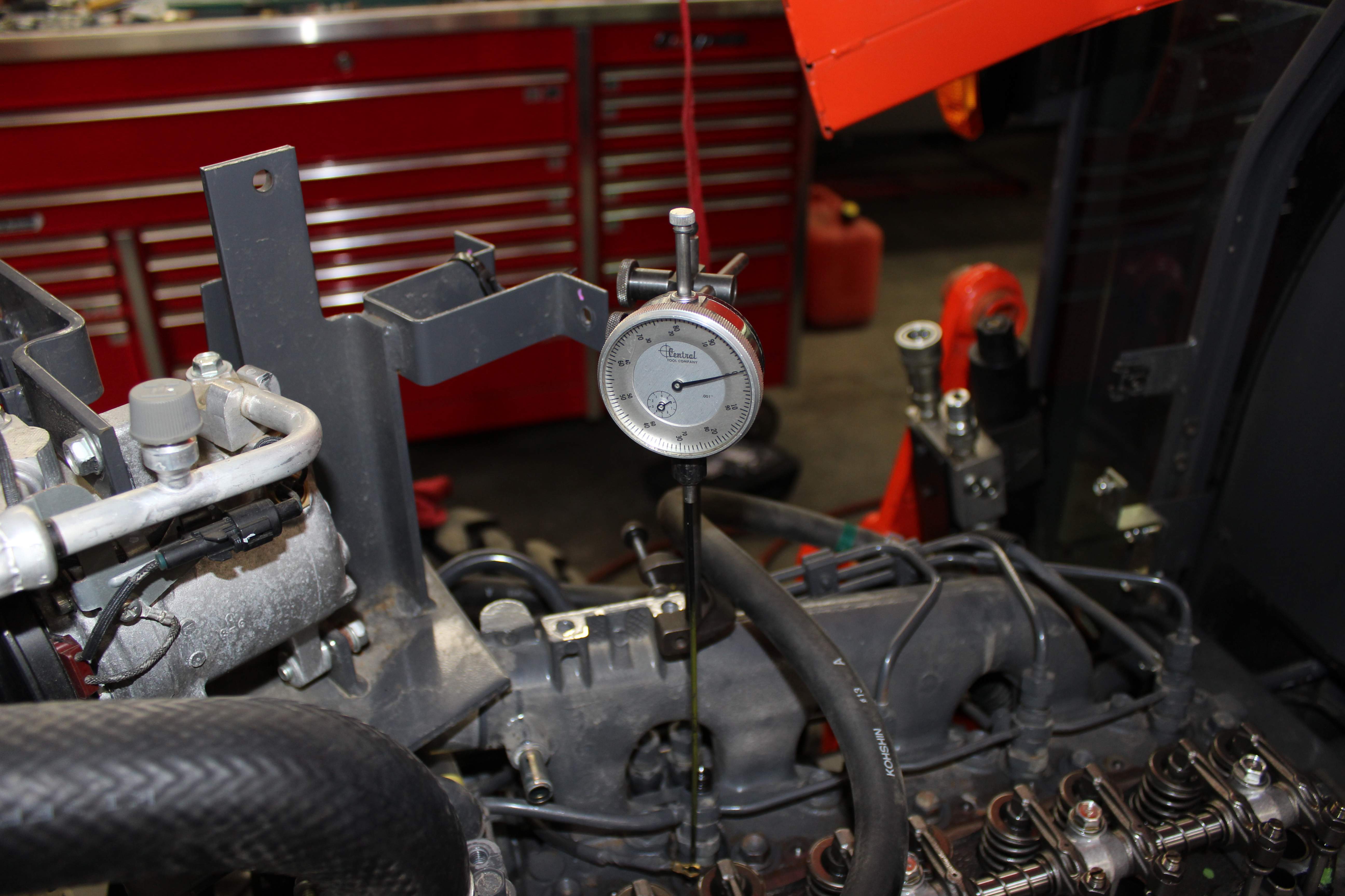

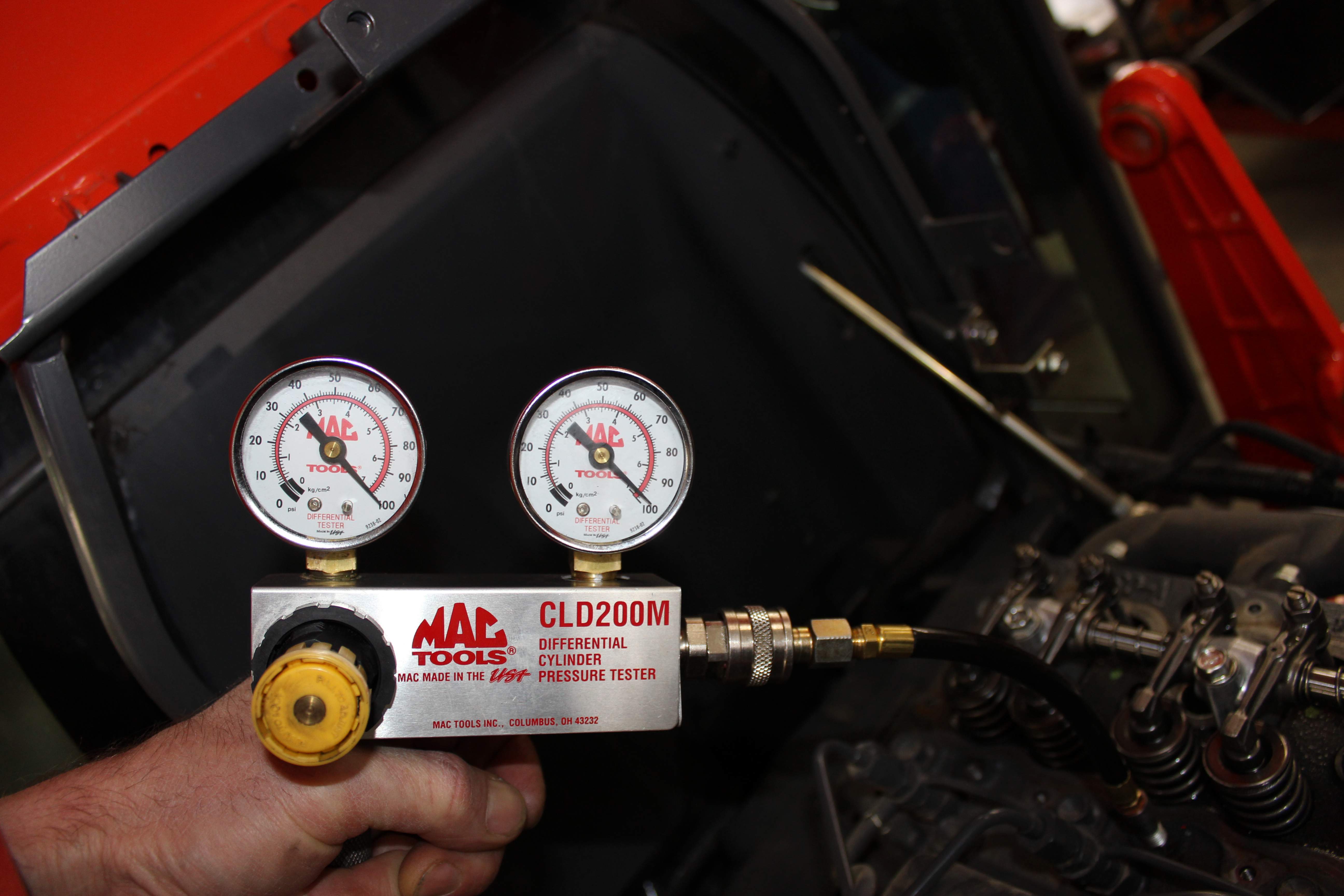

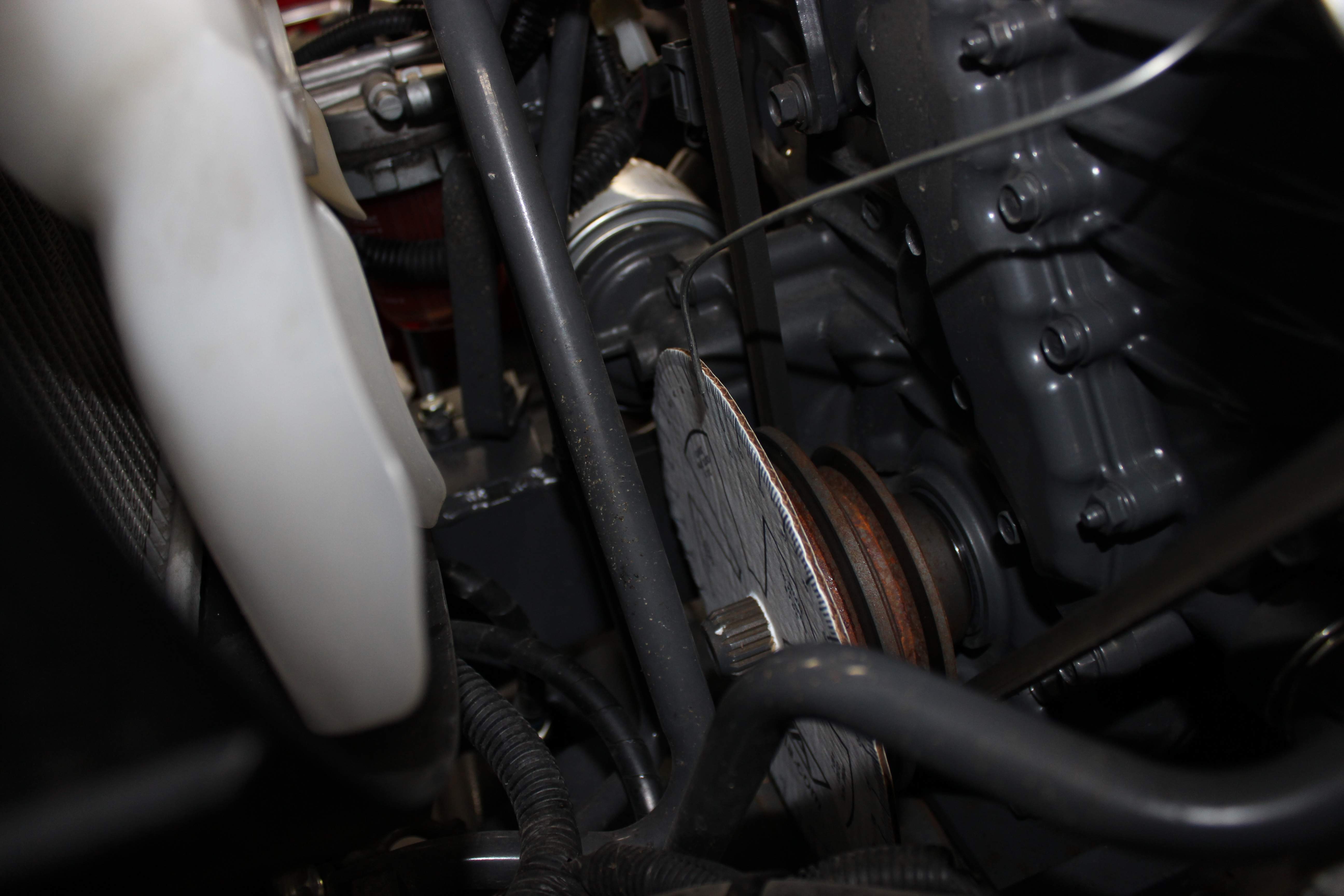

Anyway here's my notes from this morning:
12-7-2013
Compression (cranking) 400 psi. all 4 cylinders (factory spec 520-580). WSM discrepancy?
Wrong manual for the tractor? WTFKnows
Checked Snap-On gauge against Nitrogen tank regulator gauge and both match closely.
Fuel Timing check #1 cylinder 17 degrees BTDC.
Leakdown test : #1 cyl. - 2%, #3 cyl.-3%, #4 cyl.-6%, #2 cyl.- 3%. NO leakage through valves.
Valve adjustment varied from .003"(#1 cylinder) to .007" (most others).
Adjusted all valves to .008".
Checked installed camshaft position, with overlap split degree wheel right on TDC #1 cylinder.
All valves checked at .050" lift.
Intake valve opens @13 degrees ATDC. Closes @170 degrees BTDC.
Exhaust valve opens @147 ATDC, Closes at 19 BTDC.
Intake and exhaust valve lift is .305".
View attachment 349026View attachment 349030View attachment 349031
Any other things I could check? Fresh out of ideas. Other than the timing being of MAYBE 2 degrees retarded and the tight valve adjustment I see nothing wrong with this. Tractor has 50 odd hours running time. Air filter minder hasn't moved. It just acts like more air is needed.
Thanks, Fred
Fred you said your intake opens @ 13* AFTER TDC I don't have a Kubota but My Rhino 55 hp tractor has the intake opening @ 8* BEFORE TDC and closing @48* after BDC
Is that intake opening spec correct, or should the intake be opening @ 13* BEFORE TDC....
Just a guess but sounds like the cam may be 26* late on the intake opening
-and late cam timing will result in the power band being shifted up and loss of low end torque.... and reduced cranking compression??

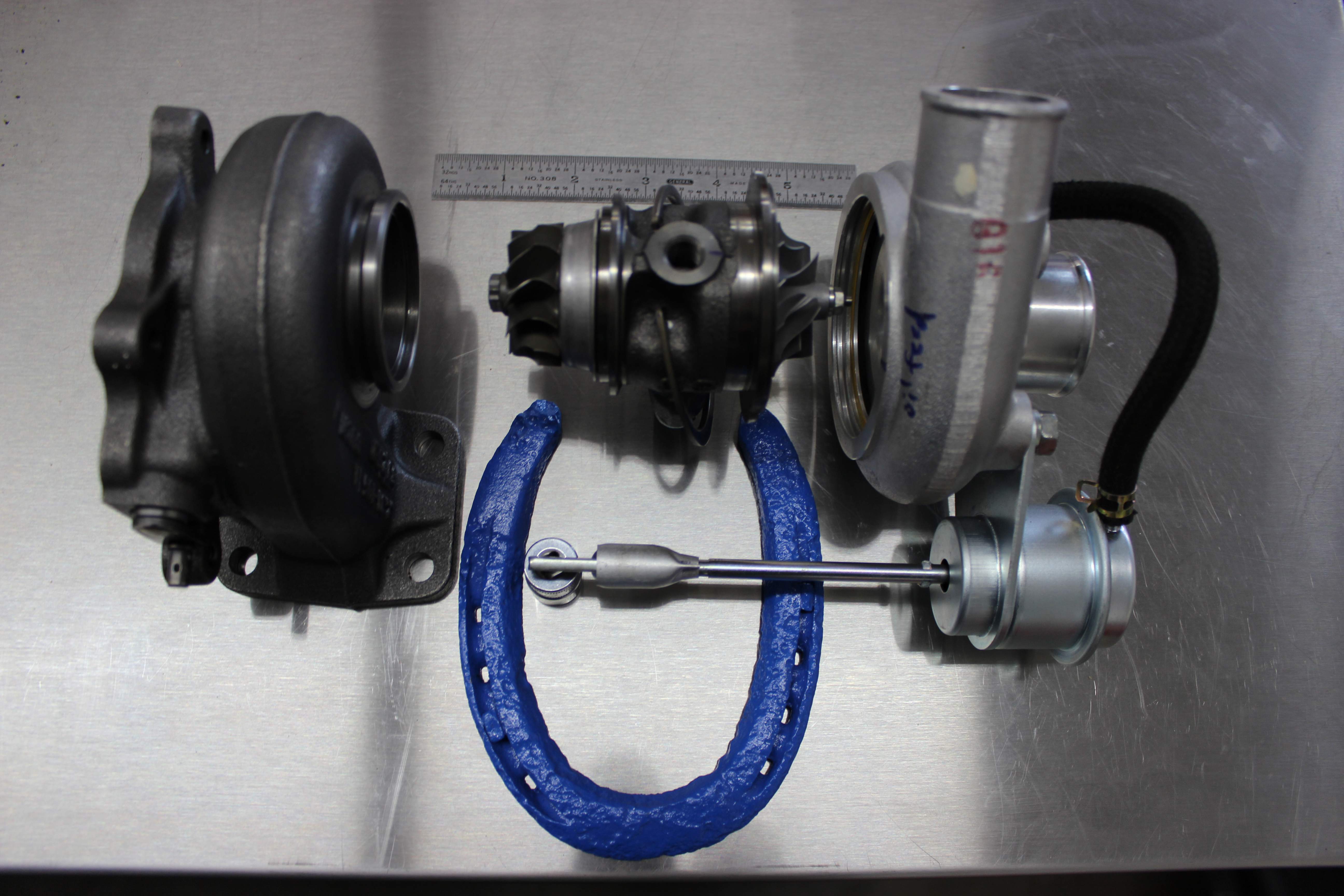

I made flanges for the turbo this afternoon. The worst part of the whole install is getting the placement correct the first time. Lot of head scratching goin on.
Fred you said your intake opens @ 13* AFTER TDC I don't have a kubota but My Rhino 55 hp tractor has the intake opening @ 8* BEFORE TDC and closing @48* after BDC
Is that factory intake opening spec correct, or should the intake be opening @ 13* BEFORE TDC....
-and late cam timing will result in the power band being shifted up and loss of low end torque.... ???
My specs are with the valves open .050" then measuring the duration. It's the way most camshaft manufacturers measure their lobes. I am no expert on cams and certainly don't know how Kubota measures their duration. Valve cover is set back on temporary I can check the duration without going the full .050" (both ends) later on.
On the overlap cycle when both valves are equally level (because they are both open a bit at the same time) the piston is at TDC. This is kind of a layman's way of checking installed position.
