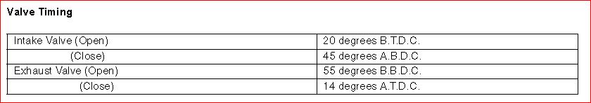

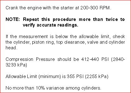

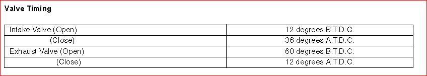

Fred, This might help some. As you are aware, Bobcat used the V2003T (56 HP) in some models but in same frame without Turbo they used the V2203 (46 HP). So I can't be positive of the specs on V2003 aspirated engine. Comparing specs of V2003T vs V2203 almost everything matches (injection timing, compression, valve lash, etc.) except valve timing.
Compression test in Bobcat specs. fall in line with your findings:
Here is valve timing the V2003T;
Here is valve timing on the V2203;
Injection timing on both is 18 BTDC.
A problem I have run across occasionally on Kubota engines with power complaints was governor spring setting. Spring were set so engine RPM had to drop well below the normal 150 - 200 RPM decrease before governor would release the fuel rack. Caused the engine to lug down too far that it could begin to recover, just a thought to check.
Turbo will definitely add more power but might as well check everything while you are at it.
