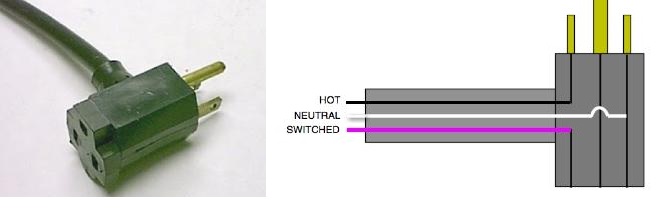

I put a float switch in the tank to shut the pump off if the water level gets too low. If I ran the hot wire to the switch (as is certainly standard) and the switch ever leaked then I have a potentially dangerous situation on my hands. A cistern with a 125VAC wire in it... and maybe or maybe not it will draw enough current to trip the breaker.. I didn't want to risk it so I ran the neutral to the switch and labeled the junction box in the crawl space as a reminder to me. What are your comments on this?
The cistern is 500 gallons, collects roofwater for a garden and has been in operation a couple of years. Here is the switch.

Pump is in the crawl space and is plugged in.
   / I switched the neutral on my float switch in a cistern #19
Then what I would do is put in a GFI outlet and wire this onto your float switch that you already bought plug.jpg

The deed is done - I switched polarity on the in-tank switch and installed a GFI receptacle. Thanks for the input and guiding me through my ignorance.
