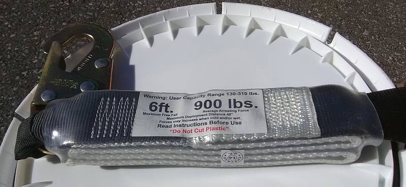

So, nice bright, Sunny, warm day and what am I doing? TBN!
Started checking out the bucket kit for the basket case (me). Went to unwrap things, get the razor knife out to slit the plastic .... then I see the Do Not Cut! I'm guessing this is like the emergency rip cord on a parachute that you hope NEVER unfurls?

I'm guessing you're right, maybe some stitching to go along with the plastic?
   / I think it's time to look for a harness. #76
What do the instructions say? The "Do Not Cut Plastic" warning may be there to make sure you don't inadvertently cut the strap and weaken it.
It is designed like that so you don't get jerked to a stop when you fall off the roof. If you fall the plastic will rip open and the elastic inside will slow you down

My intended use to is to help stay on a sloped metal roof, not suspension from beams. I'll toss a tow/recovery strap over the roof peak and anchor it to ground on the other side. I'll hook this system to that and use this rope to maneuver up and down. I don't ever intend to allow enough slack to go off the edge for this to fully deploy.
