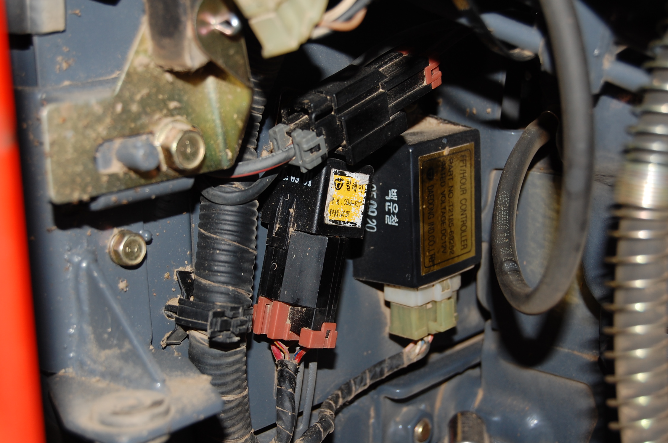

Try checking the relay, It's on the firewall, right side. Above the Hydralic pump. Hold your finger on it and turn the key off/on, you will feel it "click" if it's good. (it's got the "orange" connector)

It is the solenoid. The dealer had to reorder another after getting the wrong one in. I modified the old one to get the tractor running while I wait for the new one.
