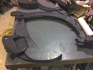

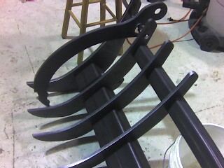

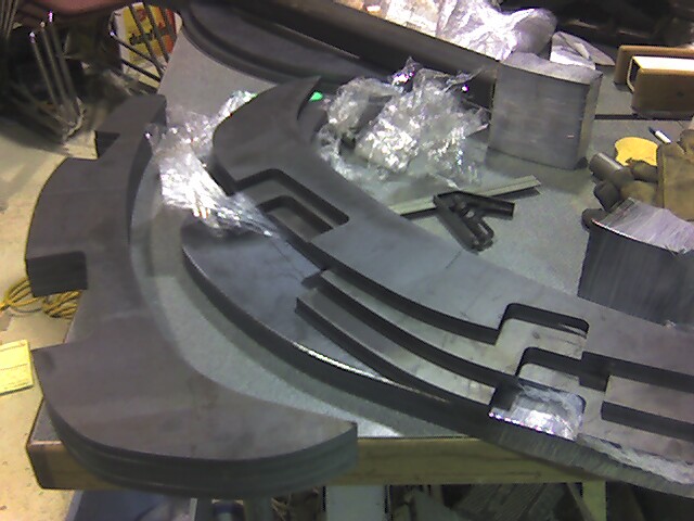

I too was interested in the SkidSteerSolutions Root Grapple and I am just about to start to weld mine together. In fact, I based the design off the picture you posted. Mine is 60" wide and about 420 lbs. but could easily be scaled up or down. I had all of the pieces laser cut and I'm just waiting on the last pieces from the machine shop. I purchased the cylinders online and only have the hydraulic hoses and fittings left to buy. I figure I'll have about $1000 into it when I'm done.
I will try and post some pics but I have never done that before so I hope they work.
