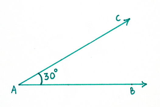

Yep! My driveway is 35°....my trail is mostly 45° ....I'm cutting into a knob/very big hill that is mostly 60°
Driveway maxes at 70% grade/ 35° slope.
Trail is currently 100% grade/ 45° slope....I'm hoping to reduce this when i get to where I'm going by taking dirt from the top and lengthening out the bottom part.
My knob is insanely steep which is the reason for the trail.....which is why I bought the tractor. You cant literally hold your hands out and touch the ground in front of you as you hike up it.....okay for me...but not ok for most people.
