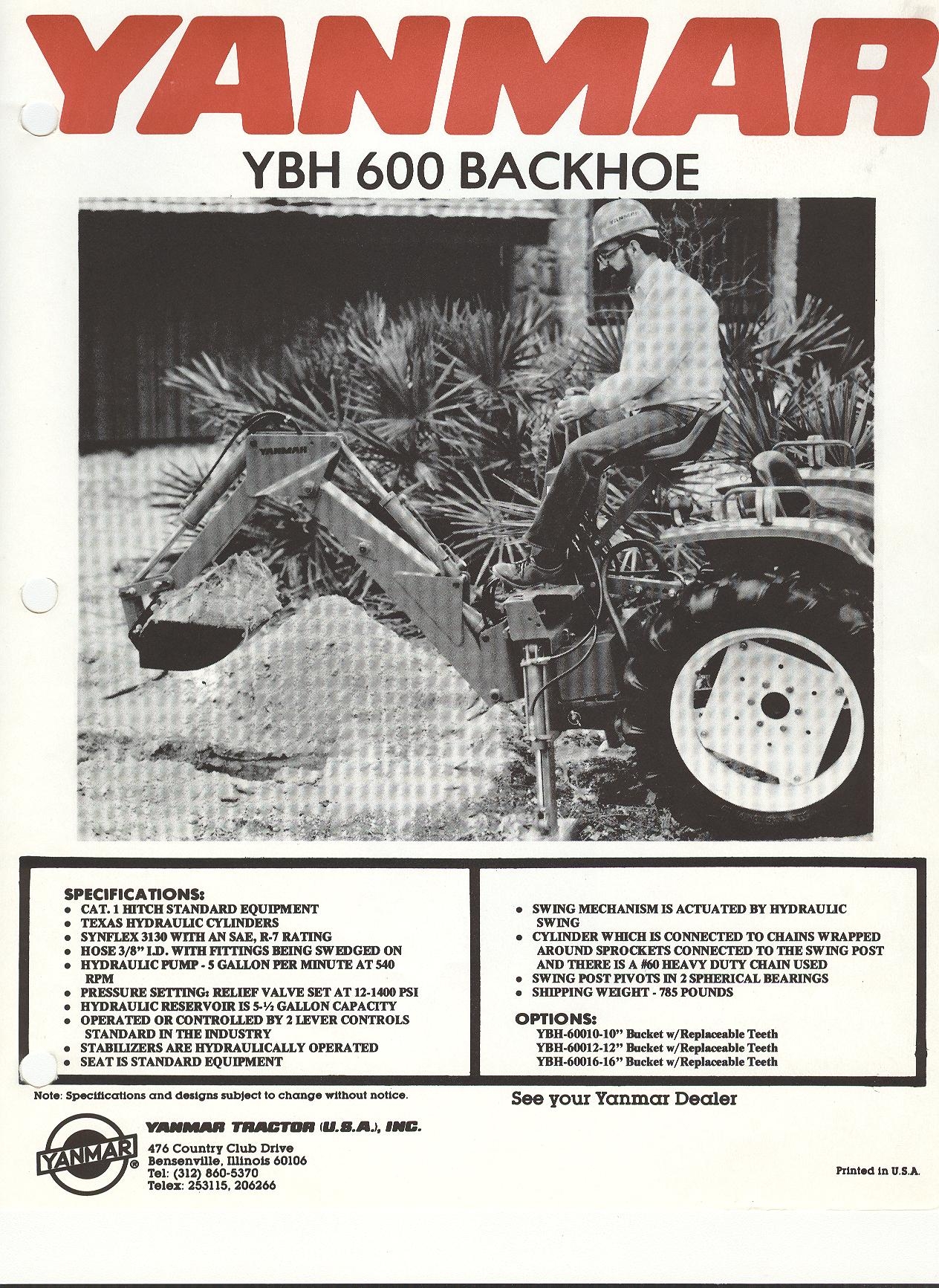

I had one of those PTO-driven 3pt hoes too. They are all that bad as described and dangerous besides. But I bought it used for under $1000, and did a lot of work with it for decades. Then sold it for $600 to a friend who used it for years. He couldn't kill it so gave it to his neighbor who still uses it. As of last month It is going strong and just as damn dangerous as always.
It is an old Yanmar model YBH600 made for a 15 hp tractor. I used it mounted on the Category II 3pt hitch on our heavy JD two cylinder, my friend on his vintage Massey 35 , and now it's on a New Holland 40.
rScotty .
