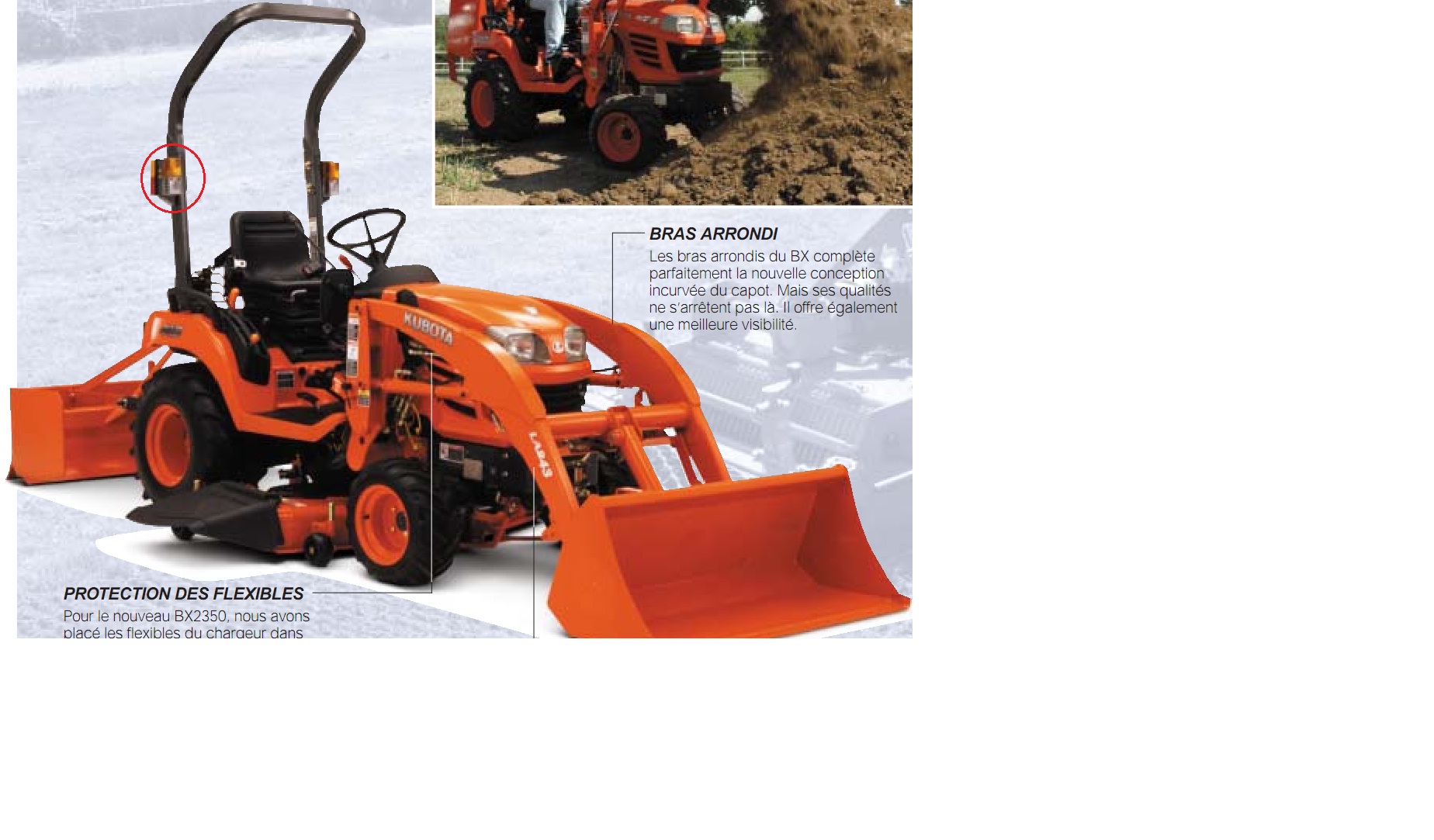

This is the french BX which appears the same as the Bx in the UK
Notice the light package on the ROPS. It includes a forward facing clear. It could easily be adapted to be a rear facing clear if kubota chose or person could modify it to face rear.

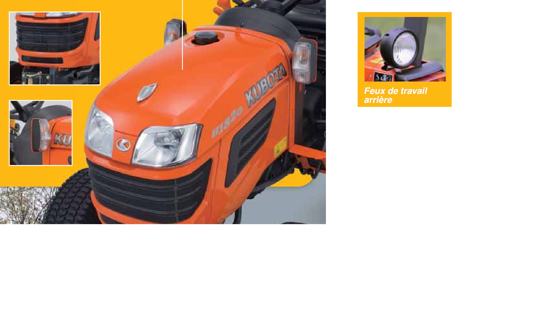

/ Idea for BX25 accessory (lighting)
And the French B. Front aux and rear work light
So far it seems like all other markets offer some form of factory aux lighting, particularly in the forward direction... Why not here. Im sure kubota doesnt offer it so they can maximize profit, but at least give the option.
