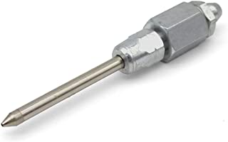

One thing about using grease or water sprayer or anything through the ignition hole is that the hole is only about 1/8" wide so aiming & holding things there present a bit of an issue. (if I take my grease gun, put it "on" the hole, the grease is only going to smear around and not really PUSH inside the hole).....or at least, that's the way I see it. Perhaps there are needle point grease fittings that allow you to inject grease (??)

You can get a needle fitting for your grease gun;
