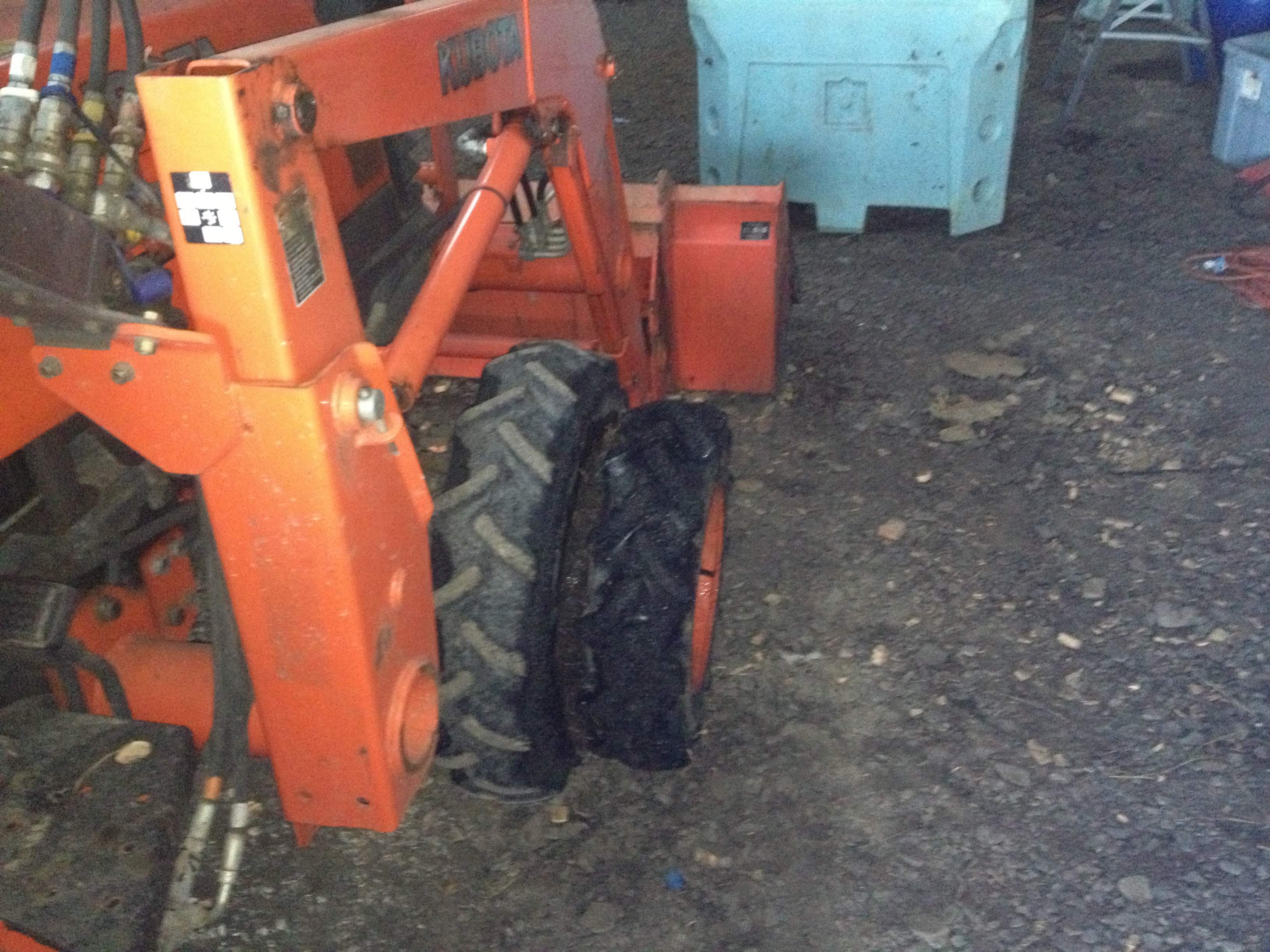

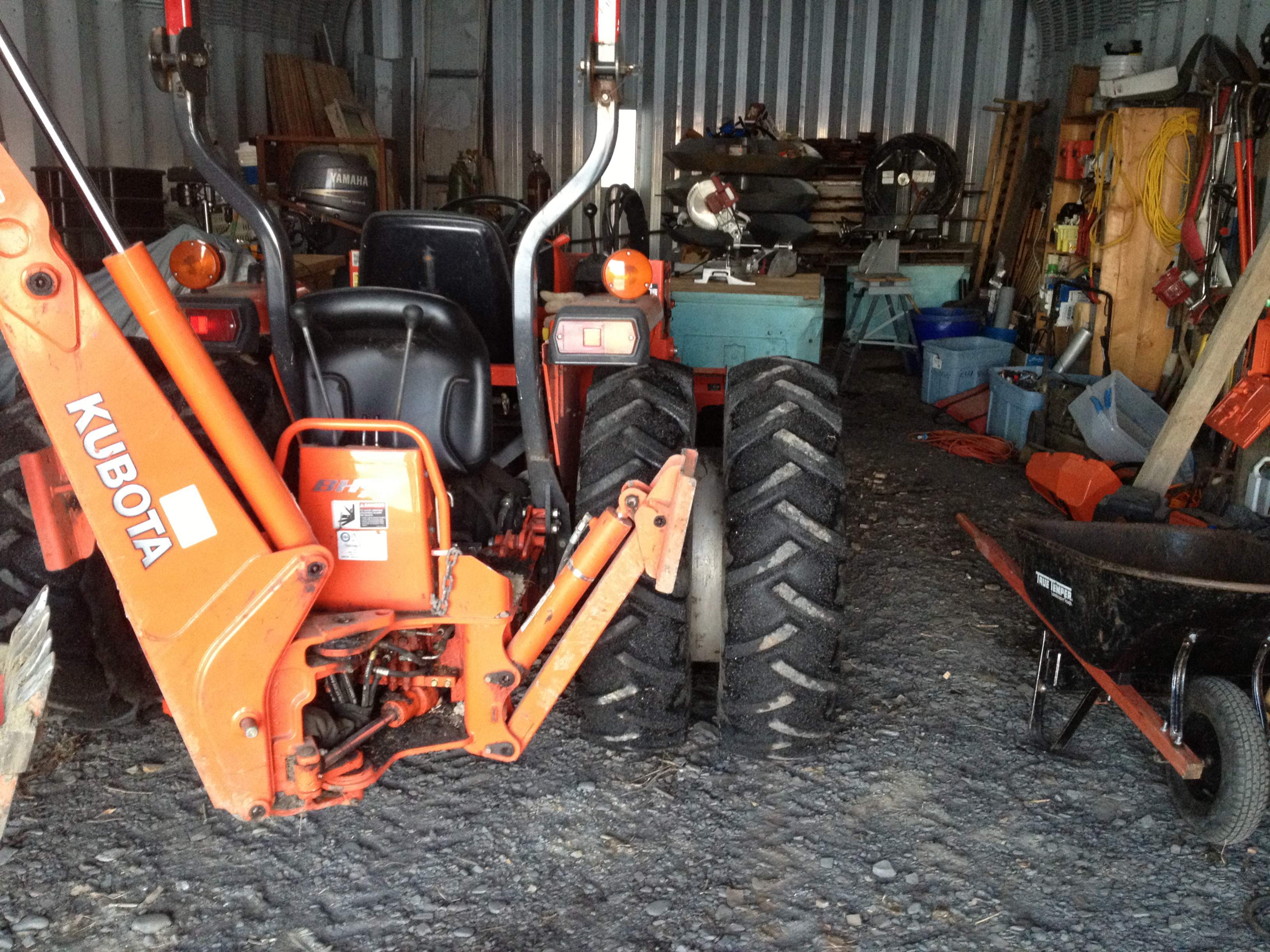

I put duals both front and rear on my L2800 for flotation on the beach. The sidehill stability was a huge side benefit that was worth the cost of the extra tires n rims alone as I am almost never on the flat although I am creating more:)
I got my rears from unverferth.com but had to make my fronts for it, although just for stability all you would need are the rears.

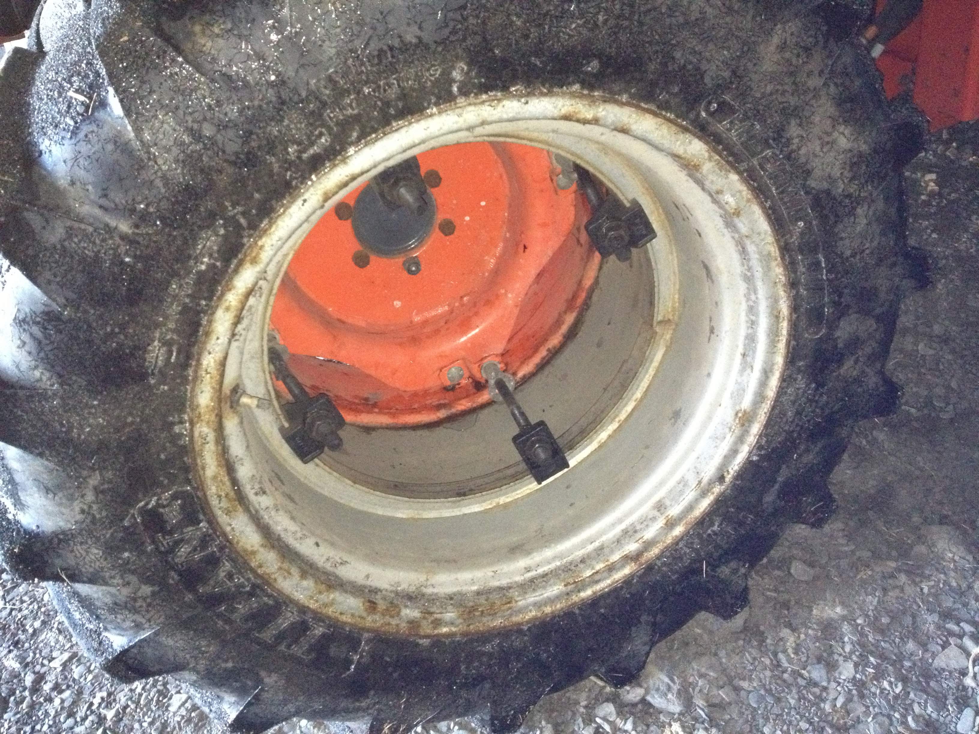

I just went and snapped these, if you do a search on my posts you can see other pics I have taken of them. I filled the inner tire originally with rv anitfreeze but have since drained it out as I didnt need the extra weight and as I transport the tractor in a skiff at times the weight is a real penalty. I definitely need a bigger tractor and have probably over worked this one but as this is as big a one I can fit on my boat this is what I have. I did develop some cracks on the inner wheel disc on the rear wheel and if you look carefully you can see where I welded in a reinforcing disc, only had the problem on one side and I have still not gotten around to welding in the disc for the other side even tho it has been sitting there waiting for a couple years, havent needed it. It was not recommended to put duals on this tractor btw, but it would be worthless to me without them and I have no regrets doing it.
