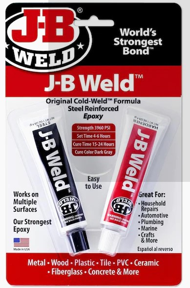

Unfortunately I have been down this road with a break in the same place as yours, I tried ever type of epoxy that I could find and nothing worked. I actually thought it was fixed after using JB Weld and not having an issue for several months until I started to use the tractor hard while cleaning out a barn and it started leaking again. I finally purchased a new radiator, if you actually find a way to repair this I would be very interested in knowing what you came up with.

Thanks for sharing. As @jaxs pointed out, the stud is a structural component too. Even if a patch were able to fix the leak, it also has to be able to withstand the vibration and stress exerted on the stud. That's asking a lot from epoxy.
