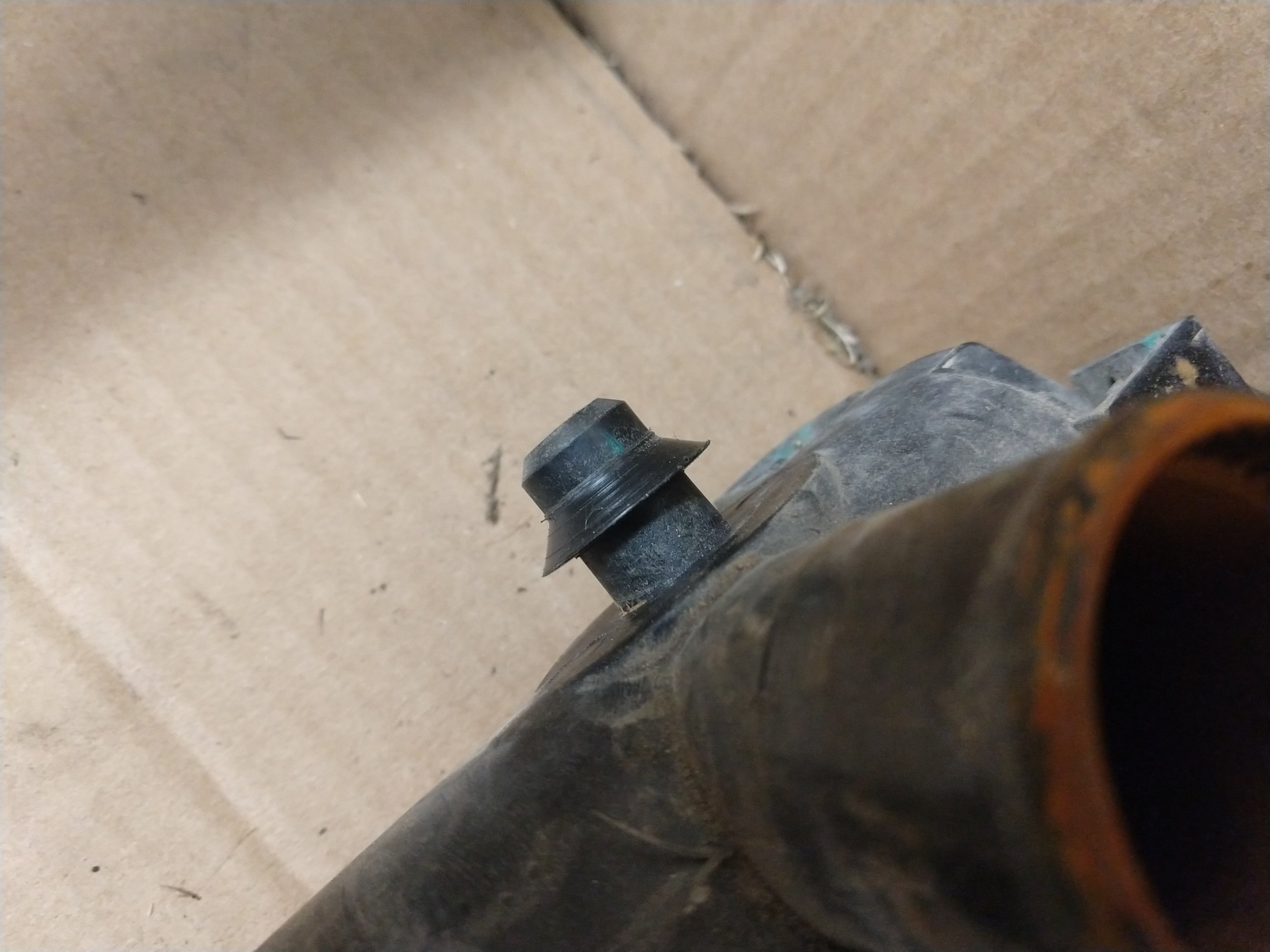

I am not doubting nor know any of these will work but 07wingnut's recommendation would be along the line I think makes good sense. You should install large flat washers on the machine screws (stainless) and drill the holes snug so they would remain in place as you install them using the hole from inside the radiator. Have them long enough so you could use vise grips pliers to hold the screws to tighten the nut. Would suggest a good gasket being used.
Along the concerns of another failure the biggest concern I would have is not the cracking coming back but the nipple totally breaking off. Temperature gauges normally measure the coolant temp not the engine temp so loss of coolant would allow the engine to be very hot before you noticed it.

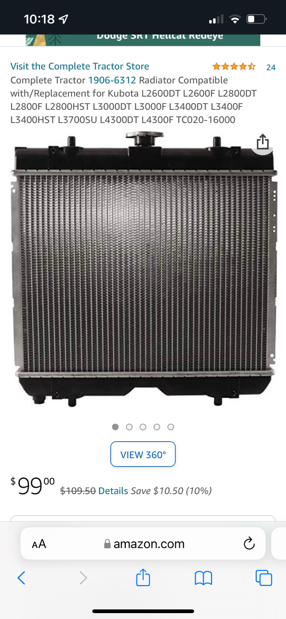

Upon close examination of the exploded diagrams, the L2800/3400 series radiators (TC020-16000) are different. One of those would require modification of other parts on an L3200.
On the other hand, there is no discernable difference looking at the L3200/3800 (TC420-16000) and L3301/3901 (TC620-16000) diagrams. Everything appears to be identical -- except the newer model rads sell for half the price, roughly $300.
Still mulling a repair, but it would nice to know for sure if the new rad is backward compatible one generation.
I assume you know that the primary difference between L3200 & L3301 and L3800 & L3901 is the emission stuff. But I'm not knowledgeable enough to say if the radiators are identical.
This topic got me to thinking of a different approach than reinforcing the existing plastic. Seems that this is a "stubby pipe and flat washer" design concept. If you are into custom fabrication, I could see a round washer (or flat sheet with rounded corners) piece of brass and a stubby brass tube or pipe fitting brazed together. The home supply stores might carry a good candidate for the brass pipe fitting. Then the new custom piece is glued to the existing flat surface on the radiator tank, creating a significantly large bonding surface.

  • Cut off the nipple and build a replacement consisting of a flat metal "washer" (or disc) with a tube or bolt. I thought long and hard about this, but it has downside: the radiator sits on rubber grommets, with the nipples poking through the grommet center. A fix like this would raise the radiator vertically by the thickness of the washer, and there isn't any slop in mounting screw alignment (at least on my tractor). This would also move the fan shroud marginally closer to the fan, which might or might not be problematic. Kubota designed fairly tight tolerances here.

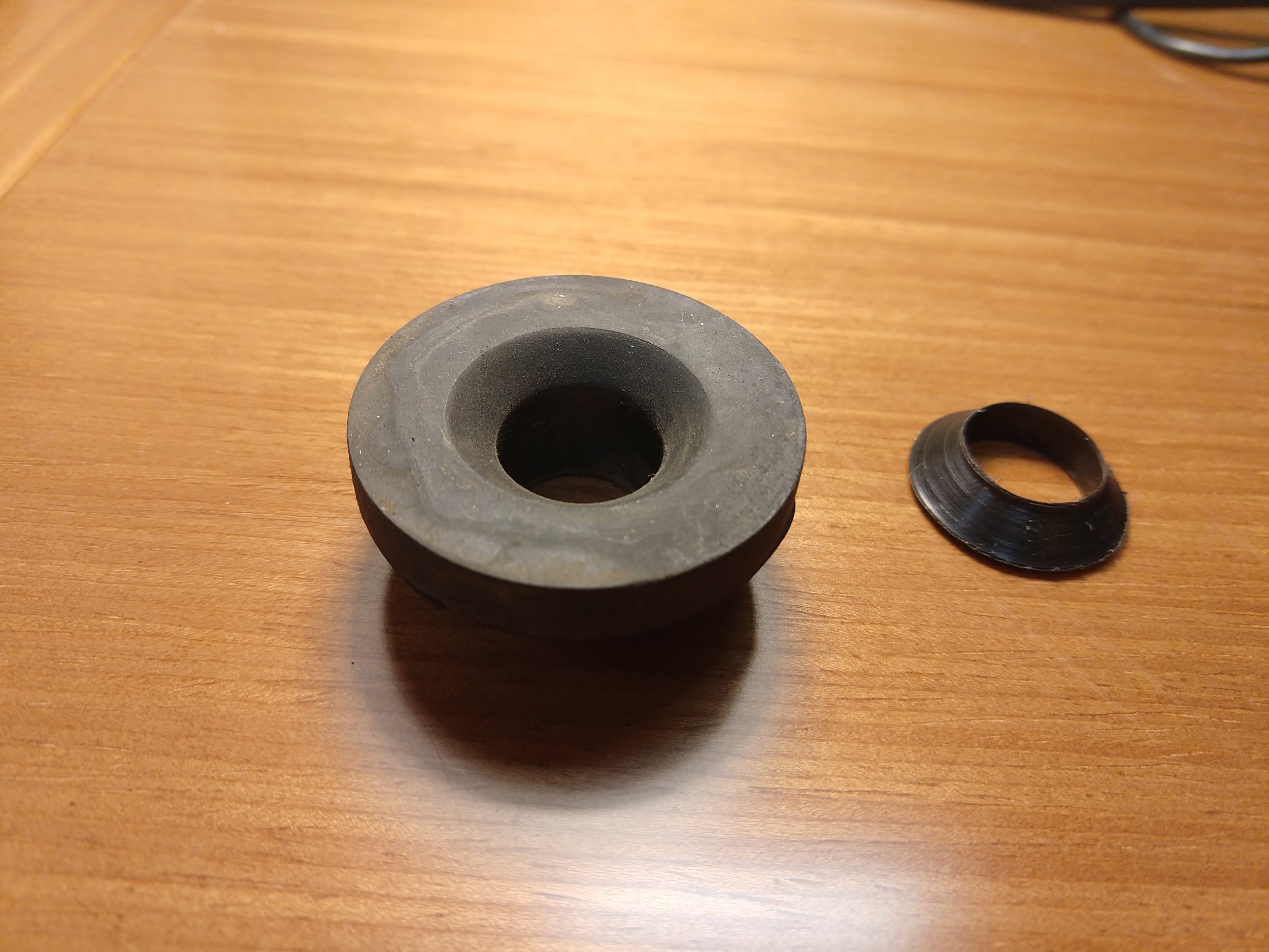

Regarding (2), I noticed something: there is a 45-degree bevel on the inside of the grommet. So I bought a rod of nylon, fired up my trusty old Harbor Freight mini lathe, and made the following pieces, one for each side.
Above: The grommet, and a small piece of nylon that fits into the beveled depression in the grommet.

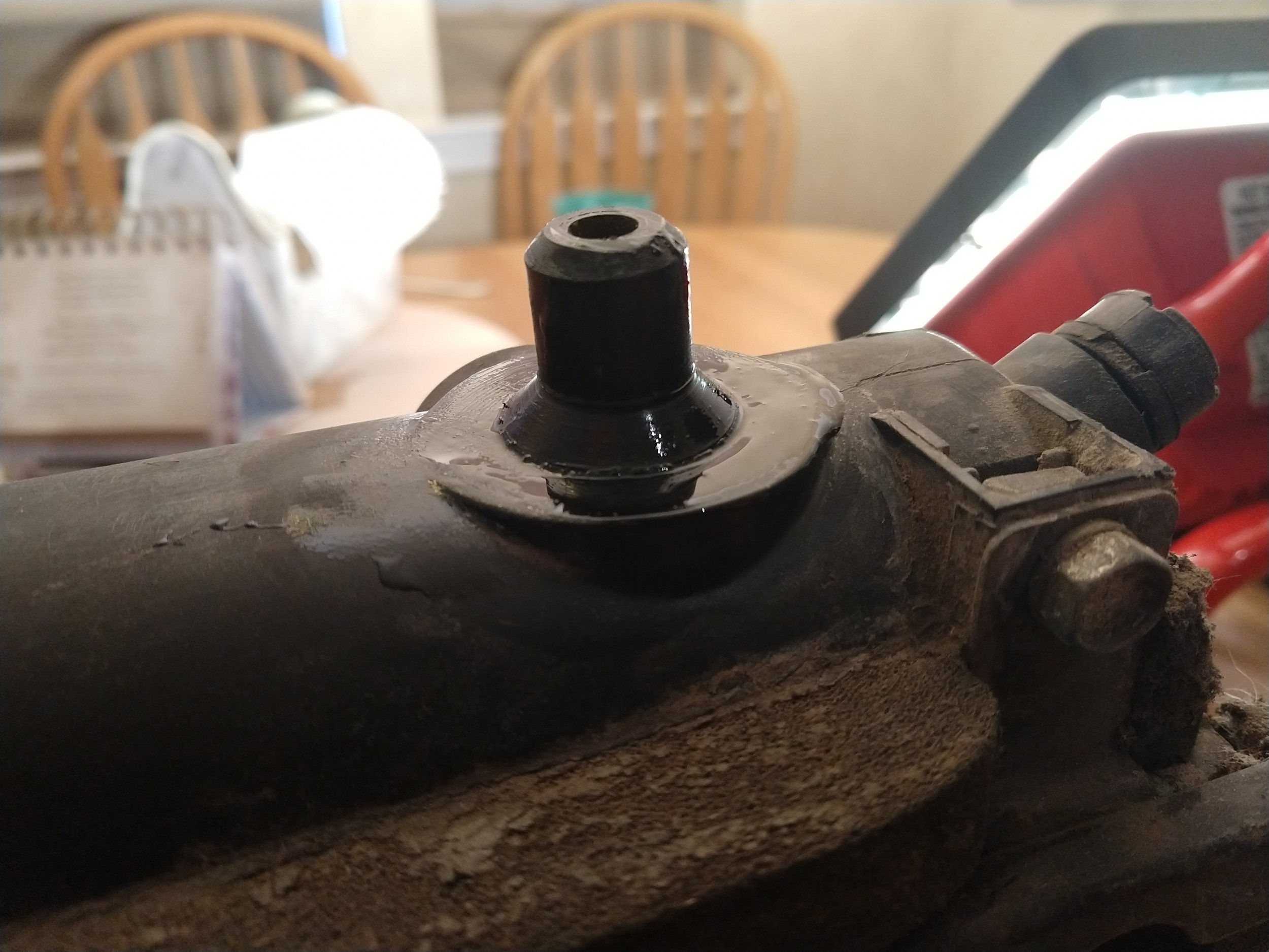

Above: the fillet piece sitting on the existing nipple. After fabrication on the lathe, I sanded the ID so that it is a friction fit at the bottom of the nipple. (Note the nipple is slightly tapered, wider at the bottom.)
Above: pressed into a layer of epoxy. This should provide superior mechanical strength for the nipple, and is how Kubota should have molded these nipples to begin with.

Bottom line: Installed radiator, flushed, refilled, drove around high speed over bumpy ground, no leaks the last couple of days! Total repair about $85. Thanks again everyone for your suggestions.
