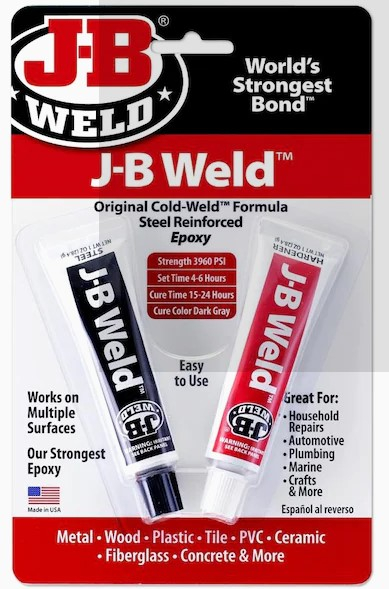

Depends on the two part epoxy.... Try JB Weld.... IT will even seal fuel tanks, should be good with water....
I've used this exact J-B Weld on the front head bolt (stud) on my 1946 Willys CJ2-A to seal it from the water and to re-thread the hole. Yes, it works in water (after letting it dry hard). I torqued the head bolt nuts and it has not leaked since 2008. I have not tried the other formulas that they sell - but - this 2-Part works great !! It comes out just like cast iron !!!
