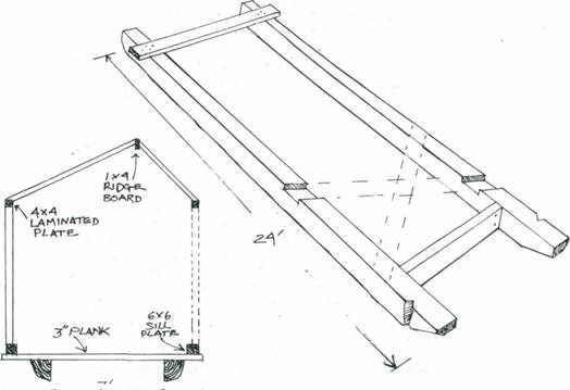

take two posts or square timbers, make steel loop bolt to the end of them, to hook a chain on the end of them, cut a spreader and attach it between the skid poles usually leave some clearance so if some thing catches it does not rip off the spreader, a spreader on the rear is good as well, jack up the shed, and slide it under and tow it home, I have slid small buildings this way a number of times,
I even have a feed shed that is build on skids so one can pull it around,
about half way down o the page shows a similar idea, Hudson Valley Vernacular Architecture picture from web page,
