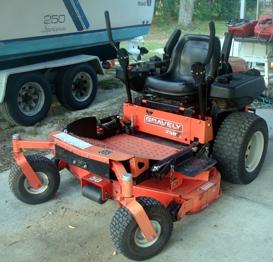

Picked up the 250Z today. It looks pretty "commercial" to me.
Got the numbers this morning and checked with the local dealer. It was purchased in 2002, has had the hydraulics serviced 3x over the 500 hours, Homer did his own oil & filters. A few belt changes here and there. Looks to have been maintained. It'd been on the lot at Nash's all summer so I'm figuring on having to fool with the fuel system.
I got it home and it ran fine for a bit but started sputtering and shut off. Blowing black smoke and smelling "choked". Say it ain't so. Drained fuel. Broke out some fuel line & clamps. Went ahead and replaced all the fuel lines as they were in pretty bad shape. Fresh fuel, Sea Foamed. Still sputtering. Removed air filter. Perked right up. Blew out air filter. Reinstalled. Mowed front yard in 10 mins. Going to Honest Engine tomorrow for new air filter.
A coupla other little weirdies about it I'm not sure how to handle.. When starting it and I'm sitting not on it during troubleshooting it will start rotating right. The parking brake doesn't seem to be fully engaging. When I move the parking brake the deck lever and deck move with it unless I hold them. The steering levers don't return to neutral when let go. There's a lot of noise coming from the roadside deck area. Is any of this operator head space? Guess I prolly need to slide this over to the Gravely forum. Thanks for any help, fellas. :cool: d:^) Schneeks..

Well, some ethanol-related fuel problems are to be expected, but I'd say for the money($2k) you did good!!! Thanks for posting the pictures and from what I see I would guess that this mower is at least equivalent to the current high-end Residential ZT HD series or the current entry-level Commercial Pro-Turn Gravely's. I think with a little fine tuning and not any big dollar repairs you should get another 1,000 hours out of that machine. If you have a manual, the adjustment of the parking brake and steering lever neutral position(to keep it from creeping toward the right) shouldn't be too difficult. BTW, the steering levers on my new Gravely don't "automatically" return to neutral when I "let go of them"(which if I'm moving I don't do) but as I understand it if I pull back my handbrake while moving that will bring the levers back to neutral as well as probably throw me off the front of the mower:0) Noise from the deck would be the one thing to cause some concern because it may be a spindle bearing. Do you feel any "excessive" vibration mowing(usually accompanies bad bearings)?? If you manually turn the blade on that side with the mower not running is there any resistance to turning or can you feel/hear any grinding from that spindle? I hope that's not your problem though. Keep us posted on how things go and welcome to the growing Gravely clan on these forums!!!

Congrats, I think you did well for the money...I agree should last a long time with proper maintainence...

You did good as that unit new was a top end commercial unit. If you adjust the linkage for the hydro. jack up the rear so you watch the wheel that is moving. Small adjustments at a time. You may have to put a jumper wire in the seat switch to keep it running with brake off. The adjusters are easy to get to on that unit if I remember correctly. To find the noise we would remove the belt from the deck and spin each blade and idler pulley. You will hear and feel if one has a bad bearing in it.

That's excellent technical advice for the OP!!!! And I would guess that this 7-yr-old model had the separate hydro pumps & wheel motors instead of the unitized Hydro-Gear units that currently dominate the ZTR industry. Would probably be a good idea to check/replace the hydraulic hoses if there is any evidence of aging or leaking. And, like you, I hope the noise is an idler pully bearings....very inexpensive compared to my first reaction of spindle bearings. With only 500 hours it's doubtfull the spindles are having any problems!!

One of the fuel lines I ran was apparently too close to something hot or that cooling fan (shoulda been a clue). So it got abraded/melted thru. Rerouted that. Thought I wouldn't like the hydraulic deck, but after a little use that bugger is schweet.!! Rummaged thru the paperwork and found receipts for service, a parts and owners manual.
sox3- Thanks much. I'll try that out and see what I can come up with. One thing I'm diggin is that they seem to have made this puppy to be easily worked on. Nice. Much different than the big-box JD.
