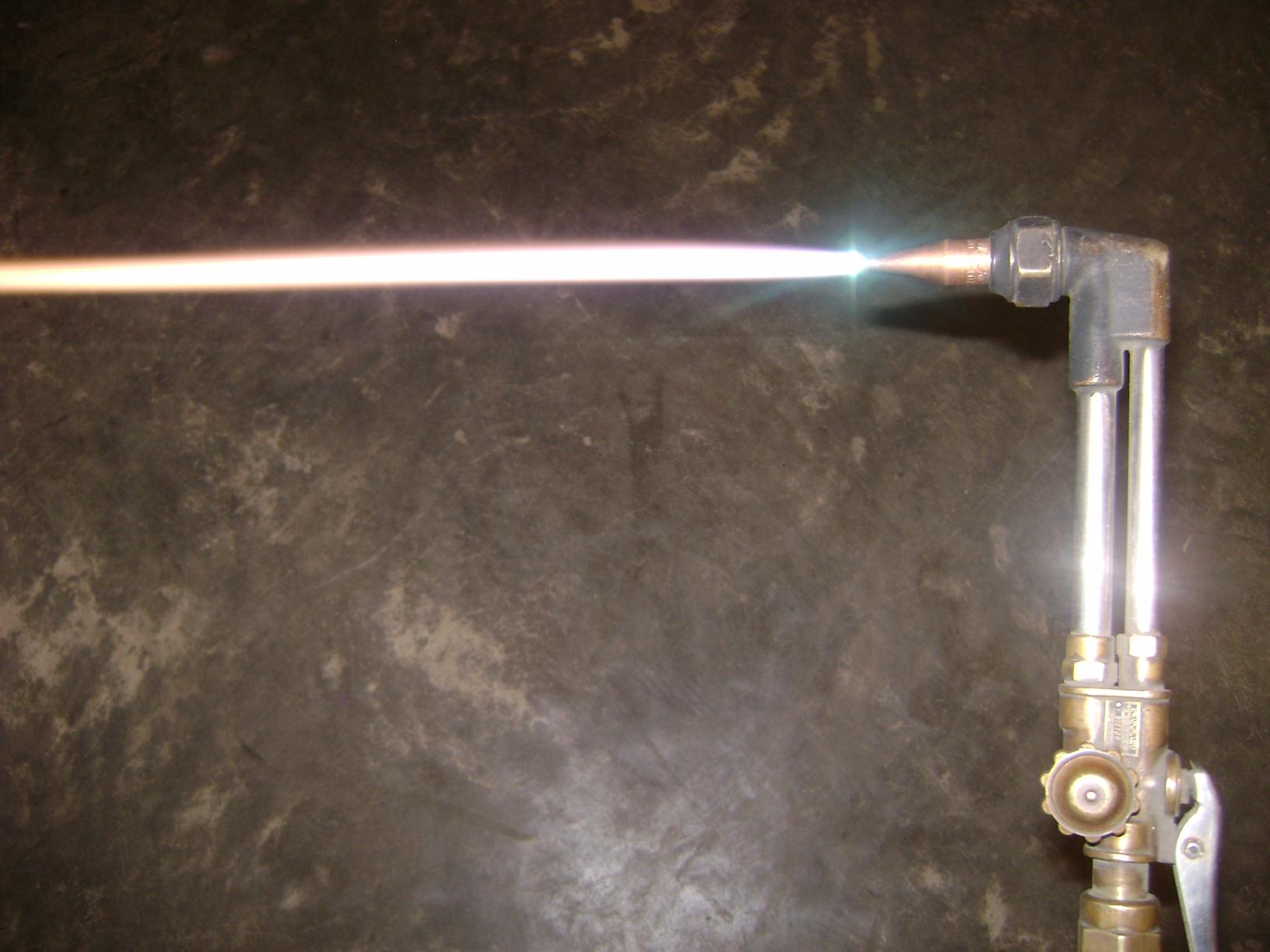

Well, yesterday, I decided to hook up the tanks and see if they wherr 100% empty. Plenty of Oxy after something like 18 years of sitting. Acetylene also was at least partially filled.
Now the bad, when I opened the small square nut on acetylene tank, a small ammount of fuel gas leaked out (saw dust move and smelled it) but when fully open no leak. The Oxy regulator also was hissing, so I think it was leaking from regulator, but I was getting oxy to torch, had nice bright white flame.

If the tank has a +, It's only good for 5 years between tests. If it has a + Star, It's 10 yrs between tests. Old regs are very dangerous. The diaphragms inside could be rubber and are likely cracked due to ozone and could leak violently at any moment. If they have sat around more than 10 years, I would be leary of lighting a torch off them. Really shouldn't open the Acetylene all the way open. All safety training says to crack 1/2 turn only to be able to shut down quickly if there is a proble. Oxy can be opened all the way up..Good Luck.
   / Identifying Oxygen/Acetylene Tanks #24
It's not a good idea to open an acetylene bottle all the way! 1/4-turn is the safest.
Did your flame look something like this?

You should really read up on oxy/acet. safety and set up before you start experimenting with the equipment, especially stuff that has been sitting around for a long time.

I get what y'all are saying about safety, but the oxy tanks are structurally sound.

"I get what y'all are saying about safety, but the oxy tanks are structurally sound."
The only way to tell if the cylinders are structurally sound is to have them hydro-tested. Oxygen cylinders hold 2200 PSI. That's close to what hyd. systems run. Ever seen an air hose let go at 100 PSI? Now imagine 22 times more pressure letting go? I have never seen anyone tape up leaks on O/A hoses. I've seen some old hoses with lots of repair splicers. Opening the acetylene more than 1 1/2 turns is a big no no! I would not rebuild my own regulators and I also wouldn't buy regulators at HF. A torch set will last a lifetime if taken care off. Some even have a lifetime warranty. Why buy the cheapest thing you can find? You should read up on O/A safety and not just get it but understand that it can kill you if something goes wrong.
