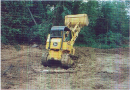

Hi
been there done that I used chain and the bucket to raise the rear up and put logs under it until I got it out. I have a few pics i will post but the scanner is not doing a good job and its really slow.
Good luck and don't get hurt, time is on your side. the problem in my case was the bottom was stuck to the pond muck and the tracks didn't have any thing to grip too. my tracks are not the aggressive type, only abour 1/2 " and rounded on top. I have some 3/4" rebar I'm going to weld onto the tracks one of these days when I get around to it.
took me 3 days to get it out.
Charlie.

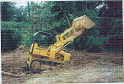

   / If a dozer gets stuck ...... #40
here is the first of many logs I used to put under the tracks
