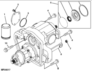

I thought I would try and give an overview of Deere&Co.'s setup. I am NOT attempting to do a My Dad is bigger than yours, Each of these sytems has inherent advantages and all have excellant track records.
The older hydros Deere offered were like NH's design (less the bunny switch...) They were stiff, since they were direct, not having Kubota's servo circuit. Both the servo design and two speed setup really offered advantages.
Deeres answer is eHydro. This doesn't change the basic design, it is really still as simple mechanicly, (probably simpler...) The electronics are external, and are between the operator and the transmission. Pushing either go pedal is actually turning a potentiometer, which gives instruction to the computer which then adjusts the servos on the transmission.
