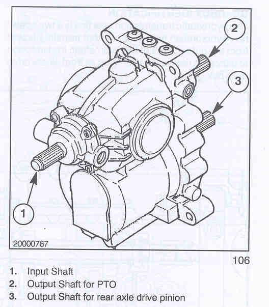

   / If a hydro fails what part of it fails ??? #35
Rob, the description by Duane is correct. The individual pistons do not have seals. There is a valve-plate on the back of the transmission which has o-rings and the external plumbing has o-ring seals, but the innards of the pump and motor do not have seals.
Also, think of the transmission like you would your hydraulic pump mounted on your engine. Where does the oil go if that pump leaks? ...on the ground, right? Well, the HST is a sealed package that is mounted inside a shell which is NOT a sump. If the HST leaks, the oil will leak out of the housing and onto the ground because the housing is not sealed. Think of the transmission housing as being similar to the cowling around a jet engine. It's just there for mounting the transmission and support. It doesn't seal and there is no fluid sump around the transmission.
The output of the transmission goes into a mechanical, geared transmission housing and that assembly is sealed and forms a continuous sump with the differential. There are two drain plugs for the hydraulic oil: one on the transmission and one on the differential. But, when you fill with hydraulic fluid, the differential fills up and then spills over into the geared transmission.
Okay, I apologize. You'll probably be sorry you asked me about this because I can be really long-winded. I'm attaching a picture of the transmission, but I didn't have time to label everything. I'll try to do that sometime this weekend and add more info if I haven't already bored you to death with details, details, details. /forums/images/graemlins/blush.gif

   / If a hydro fails what part of it fails ??? #36
That's great Jim, thanks. I'm never bored learning more about how things work! Who knows, once I have a better understanding of what's in a hydro transmission I may run out and buy one /forums/images/graemlins/grin.gif
From your description and the picture it seems that any fluid blown by the piston/bore clearance will not end up on the floor but rather in the hydro case. Kind of like the crankcase to an engine maybe?
Keep those details coming. I hope you can post some pics of the inner workings /forums/images/graemlins/smile.gif

   / If a hydro fails what part of it fails ??? #39
Vernon, that all sounds simple enough except for the hydraulic servo. It's interesting that NH has a swashplate (I called it wobble plate before) that's a straight mechanical connection to the pedals and Kubota uses the servo. Does the fixed hydraulic pump get fluid directly from the sump or does it have some type of additional charge pump? Suddenly NH's hydro sounds a lot more complex than Kubota's, and I'd bet the JD E-hydro is even more complex with it's load-sensing ability. /forums/images/graemlins/confused.gif
   / If a hydro fails what part of it fails ??? #40
Jinman,
If there are no seals, etc inside the Hydro portion of the tranny are the cylinders/pistons replaceable after they wear out or is it a get a new Hydro kind of thing ? Just curious
