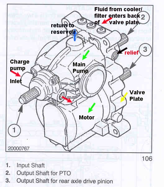

Rob, I posted the illustration of the NH TC35/40/45 (class III) tractor's hydro before, but I'm doing it again here with some additional labeling. As you can see in this new diagram, the low pressure charge pump sits at the front of the transmission snout. The fluid is drawn from the reservoir and immediately leaves the transmission and heads up to a hydrostatic cooler and filter (this will be shown in the next diagram)
When the oil returns to the transmission, it goes to the rear of the valve plate where it enters the pump. The top section of this transmission is the pump and the bottom section is the motor.
Notice how the shaft at the front of the transmission (label 1) is directly inline with the shaft that leaves the transmission at label 2, PTO input shaft. This shaft just goes straight through the transmission and to the PTO drive and reduction gears. Both of these shafts turn at engine rpm. On the class III NHs, there is no input clutch or clutch pedal. The PTO is completely independent of the transmission because it has it's own hydraulically driven clutch and brake. All smaller NHs do have an input clutch and I believe that clutch must be depressed prior to engaging the PTO.
Detailed plumbing will be shown in my next post. /forums/images/graemlins/cool.gif

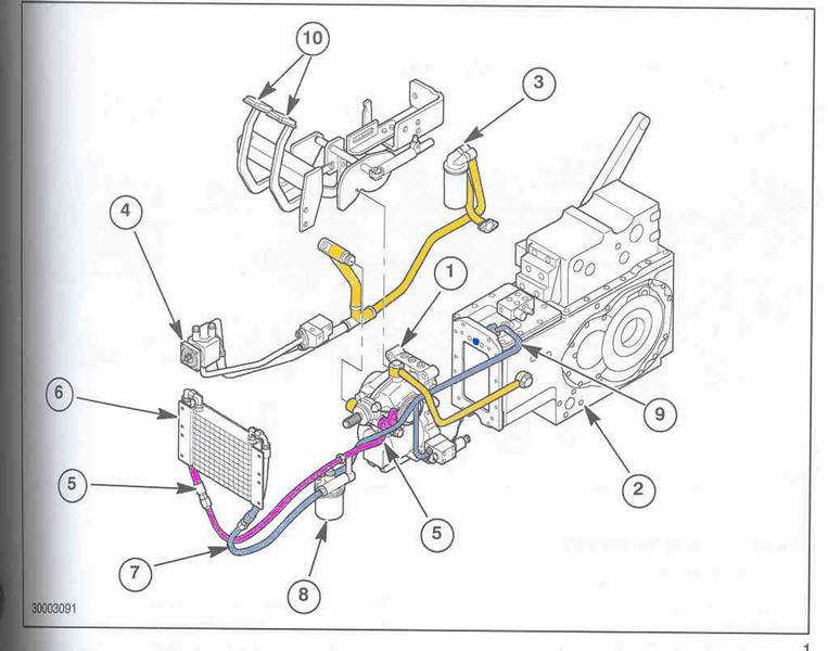

In this diagram, I'm showing NH's plumbing, because it shows that the hydraulic fluid to the transmission gets drawn through the same line/fliter (item 3) that supplies the main hydraulic pump. The amber line at the top is the supply and the amber line from the top of the transmission back to the sump is the return line.
The purple line is the charge pump pressure going up to the cooler that sits in front of the radiator. From there the blue line brings cool oil to the hydrostatic filter. The filtered blue fluid continues on to the back of the transmission valve plate an also down to the two-speed solenoid assembly that uses hydraulic pressure to change the angle of the motor's swashplate.
What is not shown in this diagram is the outer transmission casing and bell-housing that surrounds the transmission. This is the casing that I've indicated is just a shell with no sump inside. In this illustration, you can clearly see that all oil leaving the transmission will be routed to the rear transmission/differential case (amber line noted above).
