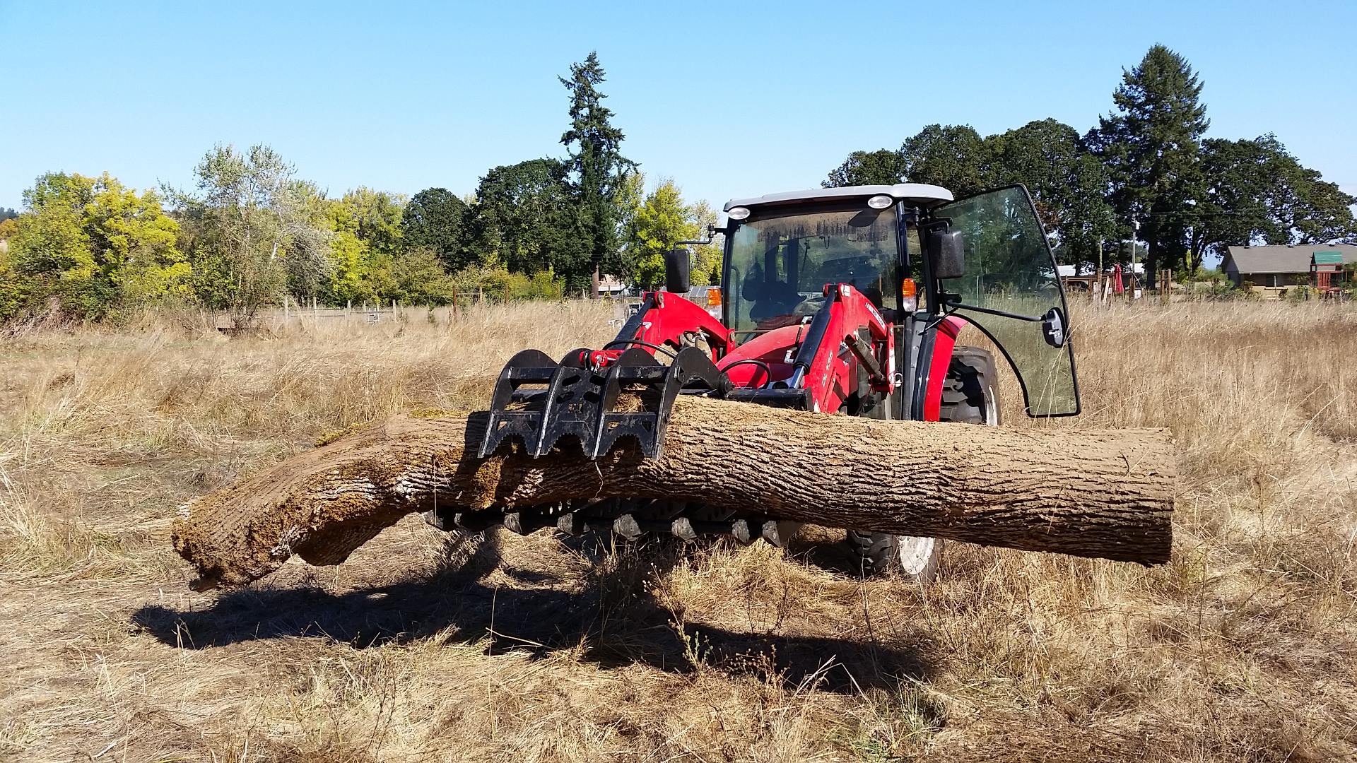

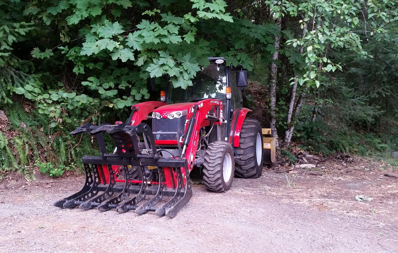

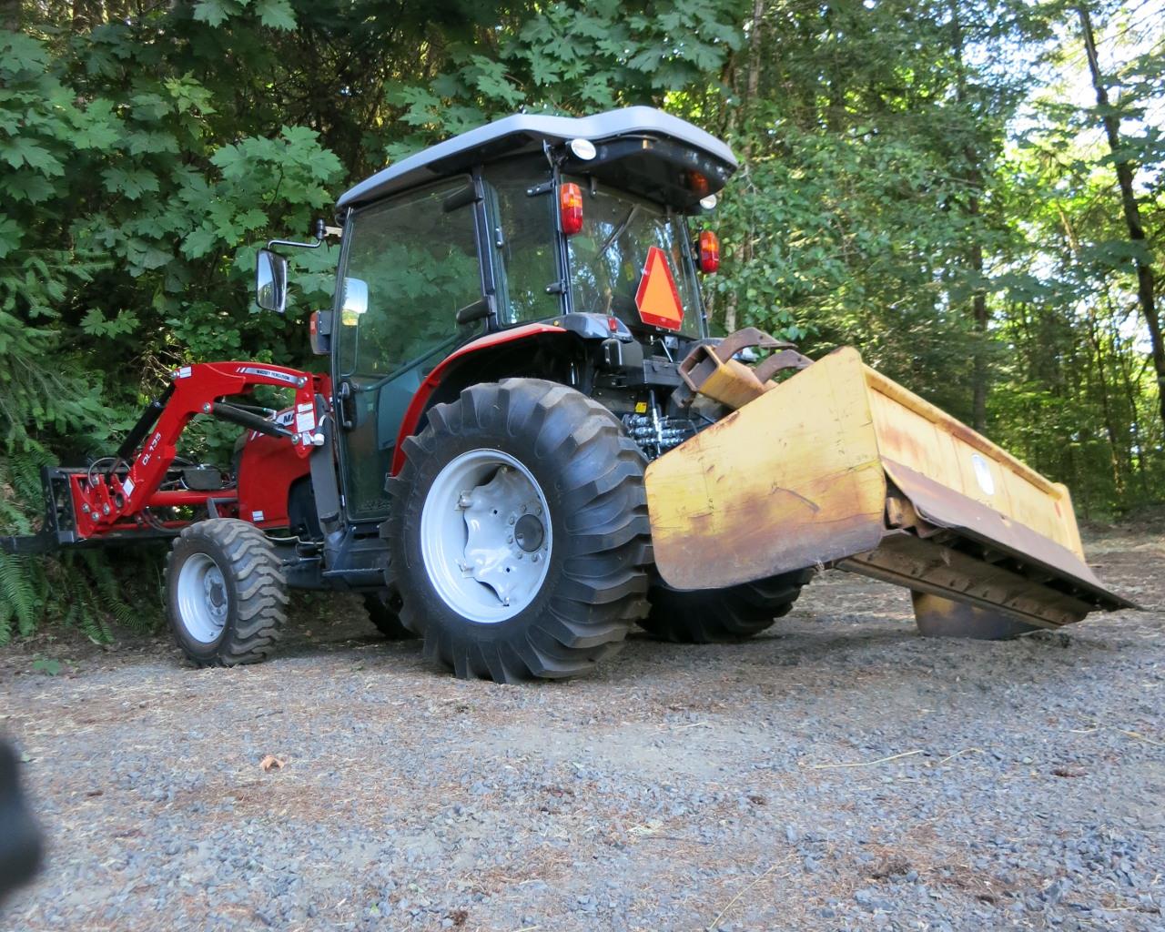

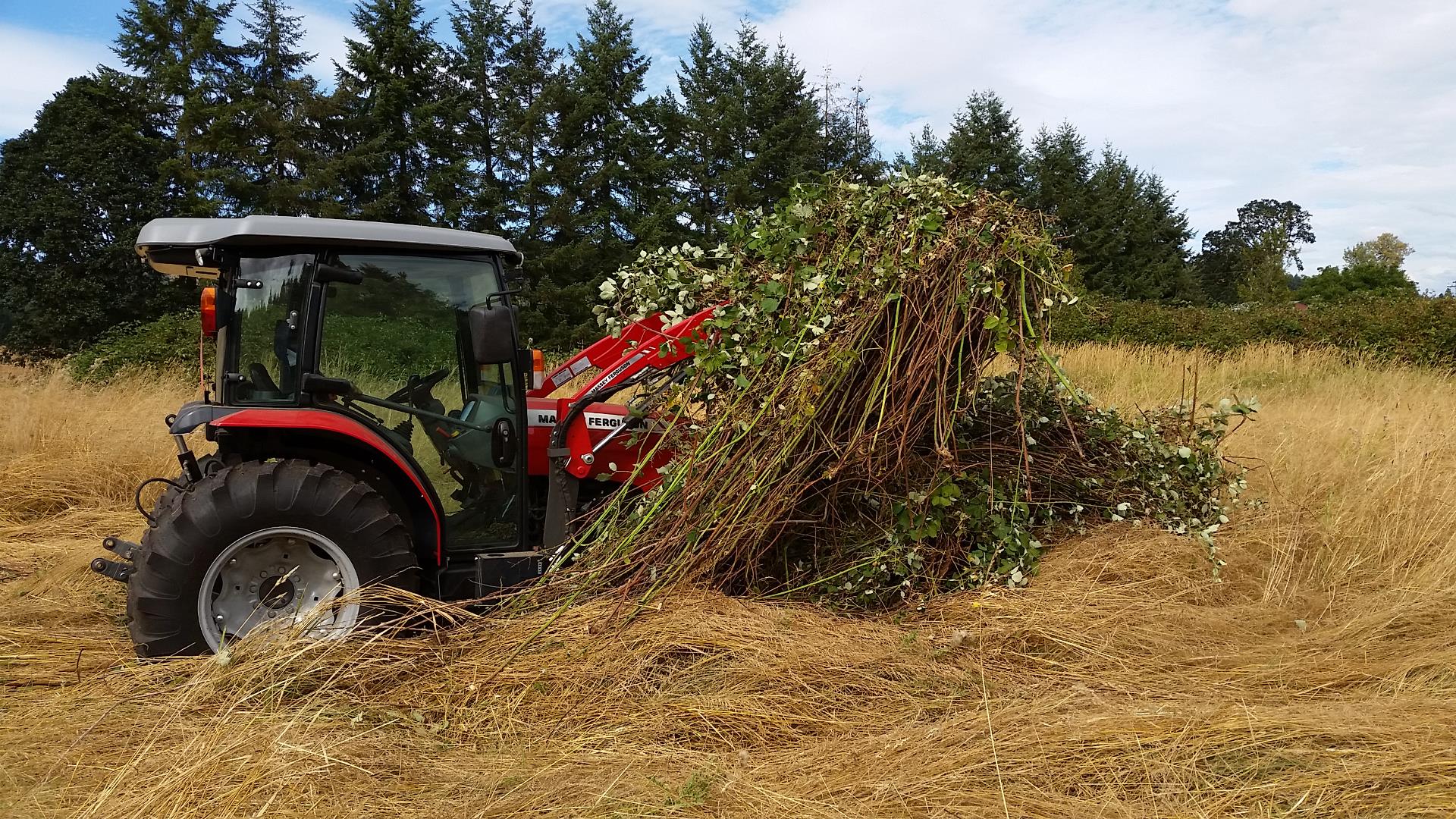

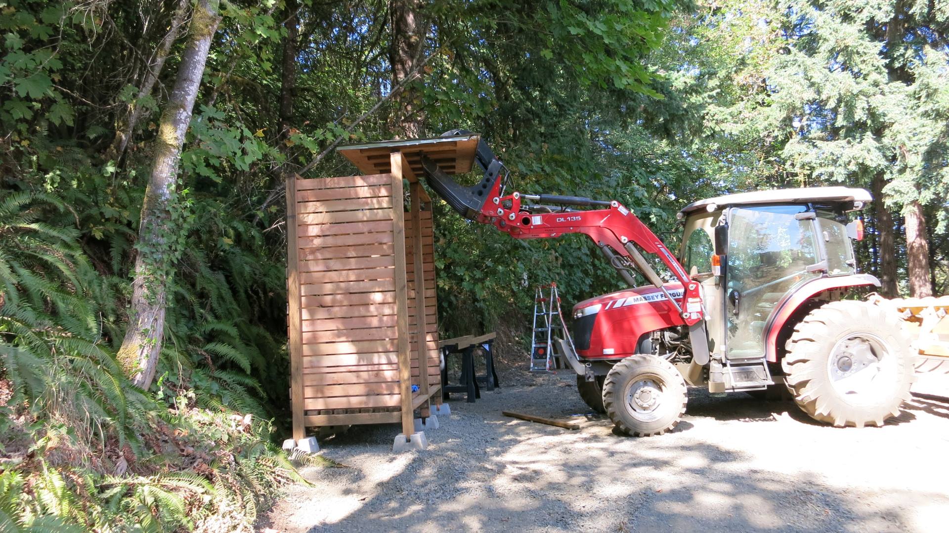

I've had my first CUT for 4 months and 61 hours. Nothing to report. It's fine, I'm fine, stuff gets done.
