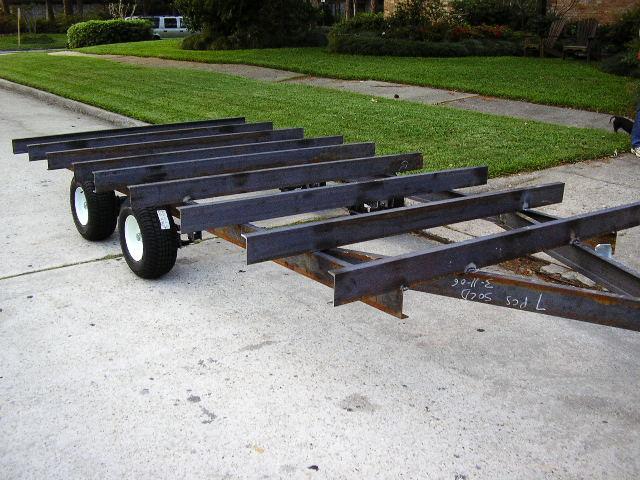

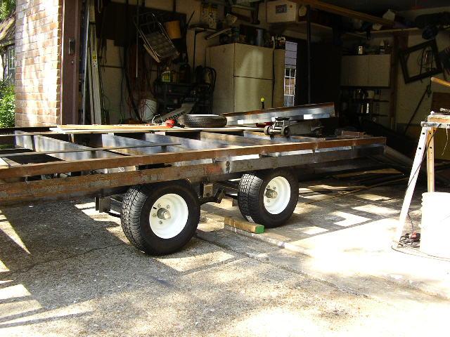

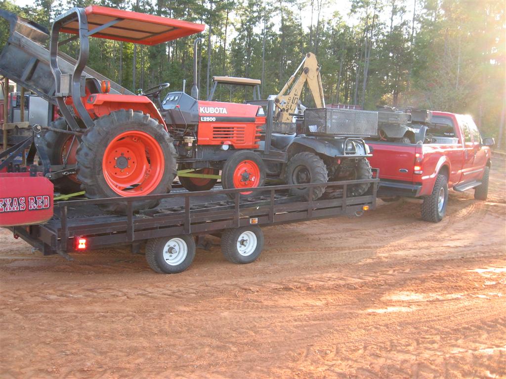

I made my trailer. Down here you can't find a medium size sled style. So have welder will weld. It's 7.5' wide, 14' long/ Low profile tires to keep the height down (10" wheels). The sides can be removed, e-track on the deck, ramps stored under the back. If I did anything different I would make it 16' long (though this doesn't really get me that much), make a dove tail rear (I kept the design simple as is), and make it 8' wide. In Texas I could go 110" I think max. As is I can load 4 atv's, 2 rows side to side, or 3 loaded from the side. It has a solid bulkhead to. I don't really care if the implement hangs off the back. The width up top is what I really like. I don't haul my tractor that much but we use it up at the weekend place. Hay, kuhn cutters, squeeze shoots, etc.
I have about $1100 in this one using surplus steel. A great score was the light weight 5" channel. I also sold my other 5x12 home trailer for $500 to cover half of the $1100.
Rob
