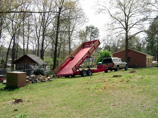

Here's mine...14k, 20', slide in 6' ramps, hydraulic dump, D rings in bed, heavy loads I use WD hitch, I welded removable sides and tailgate on it...very happy with my ultimate trailer, (do have a smaller one, though).
