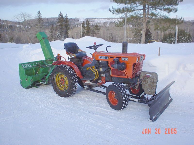

In this picture you can see the blower on back with the slightly modified ATV plow on the front. I used the stock mower mount bracket and made another bracket that bolted to the first one to carry the plow. Un-bolt the bracket in the spring and attatch the MMM and go mowing. The plow lifts with a manual lift lever, seen on the other side of the tractor. It doesn't lift very high, but high enough. It will push a lot of snow. Simple, but effective.
Of course I can replace the blower with the rear blade if I want.

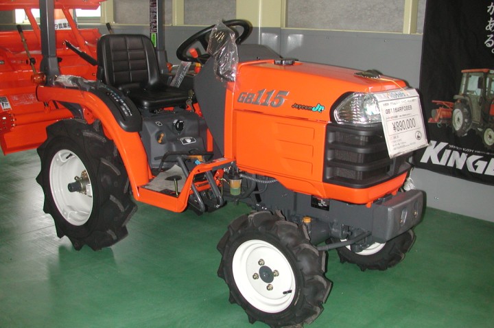

Thought you guys might like to see what the little Kubotas in Japan look like now.
The attached picture is of a 2 cylinder 11 or 12 HP that may be similar in size to the B6000...(hard to tell, but judging from the look of the seat and steering wheel, may be close?)
This picture was taken in Japan in Novemeber of 2003...if I remember right this one was water cooled.
