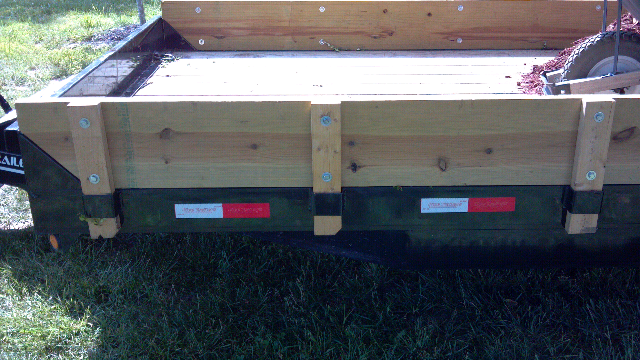

Stake pockets are a cheap, useful addition to any open trailer. LED lights are also nice.

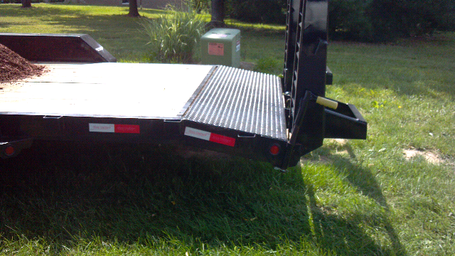

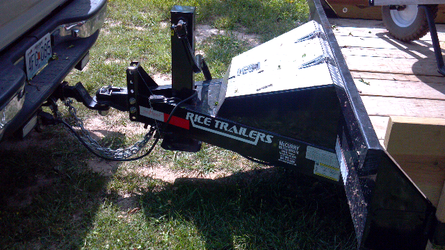

Heres a few pics of mine i only wish it had come with a few more D-rings on the side. Also powder coat is the way to go not regular paint. Ive hit this trailer a couple times with the tractor bucket and it only left scuffs that im sure will buff out. Plus came with the tool box
That adjustable-height coupler you've got there is pretty nifty. I switched trucks earlier this year, and the new truck is taller than the previous one, and my trailer doesn't ride level, even with a ... I think it's 5" drop bar. I'm not really inclined to buy a new bar, because they're not cheap, and anyway, I have a hard time finding ones with more drop than that, rated at more than 7k lbs.

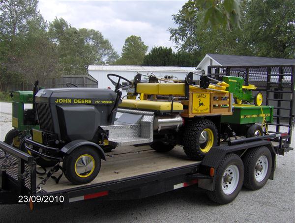

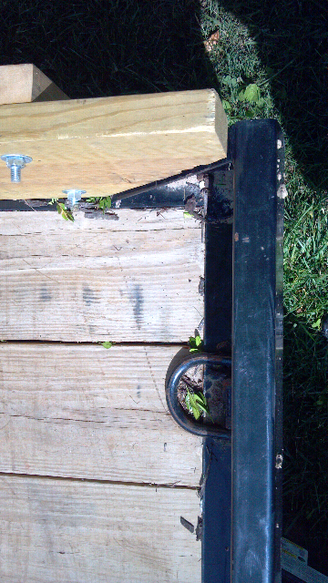

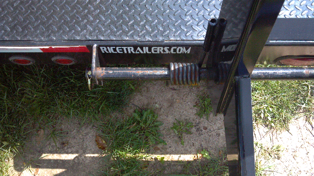

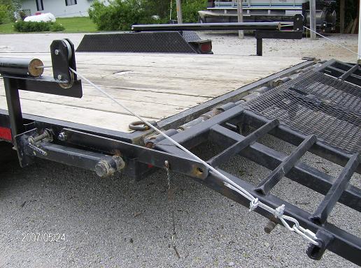

My 16' trailer has 2" sq., swing down loading legs, extra springs on the ramp gate. I had the ramp gate put on after cancer treatments as it was too much for me to handle the slide-in ramps anymore. The gate will hold a 7500+ lb. tractor. Not real visible in the second picture, but it has 1/4" x 2-1/2" "rub rails" welded on the outside of the stake pockets, allowing tie-down at any point. "D" rings on all corners & front center. Receiver tube on left front to support hydraulic jack-type crane. "Y" on tongue is enclosed for lockable chain & boomer storage. Since I haul garden tractors a lot, I added a smaller "D" ring at each cross member down the center. ~~ grnspot
