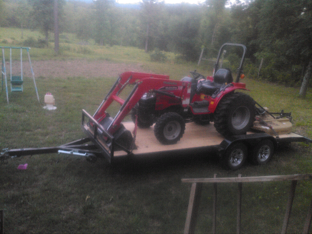

Here is a pic of my 18 footer I just got finished. Made of tubing. The tongue is built of 2x4x1/4 and the bed is built of 2x5x3/8. Tongue is long, and equipped with Hydraulic Surge Braking System. Also ramps that are stored beneath the rear of trailer. This trailer was custom built for my Mahindra 3616. The BH hangs off the rear about 2 feet. I knew it would but I dont think it would leave my driveway without scratching if it was 20 feet. I didn't want the sides because if I ever need to haul a car I can open the doors on most cars with no sides. Get extra tie downs on your trailer. You will want/need them sometime for sure.

Nice build.
