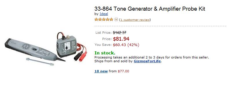

This is the signal/wire tracer that I have and can be found at Home Depot. I have used it quite a bit. Small and compact, Easy to hook up and trace.
Disconnect the vehicle battery while testing.
Gardner Bender Lan Tracker Wire Tracer, Gardner Bender - GET-4220K at The Home Depot
Here is a similar tester.
Gardner Bender ET64220 Wire Tracker Lan Tracker Wire Tracer #6787691 at HardwareAndTools.com
Stopped at Lowe's last night after work and picked up a tone generator kit. They did not have the one you had so I picked up this one. (I also had some Lowe's gift certificates I had not used :))
Picture grabbed from the Internet.
I played with it a little this morning and I can see how it would be a great tool in finding wiring problems. The common complaint I see on reviews of of these tools is they are underpowered. How far should this tone generate. I only used a short piece of wire to test it this morning, I may have to try a test with something longer when I have time.
Thanks for pointing out what this can be used for. I have seen them in the store but did not know what practical application they would have for me.
